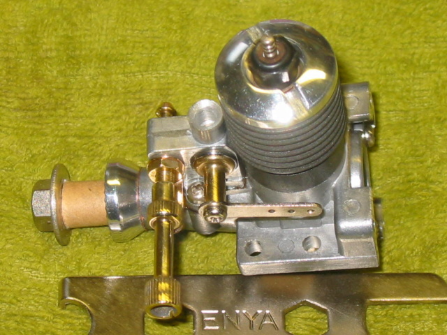

Acquired an Enya .10 from *bay at a good price.
Acquired and won the bidding war on a Enya .10 engine.
Was run a lot, so I tore it down and sonic cleaned it.
I had replacement gaskets for the engine.
One down side on taking it apart.
The previous owner didn't have the copper gasket between the head, that I could see,
(where the glow plug screws in) and the cylinder.
I used heat from my Top Flite heat gun to warm the engine up to get the pieces apart.
When it came time for removing the head from the cylinder, it was tough going?
I used so much heat the wrenches I was using were very hot, but I finally got the head broken loose.
I was able to screw the head out and what I found on the threads was JB Weld (Epoxy!).
And of course no copper head gasket between the head and cylinder.
If you don't use either the aluminum or copper gasket the head will unscrew.
Anyway, I removed the JB Weld off the threads (popped off) and placed the dismantled engine into the sonic cleaner.
Take a look at the before and after. It looks like a different engine?
Right side -- before
Right side -- after
Left side -- before
Left side -- after
Top -- before
Top -- after

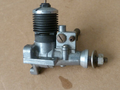

At the risk of poking my neck out-that photo of the Enya 049 does not show the correct muffler-the one in the photo beside the box is a G-Mark 061 muffler if I'm not mistaken....

Your results using the sonic cleaner are absolutely awesome.

I'm with Andrew...your sonic clean results are spectacular! Just popping those pieces into the bath cleaned AND polished them?
What chemical/product did this? I need to get some for doing motorcycle carb work. Apparently I'm using the wrong stuff!
Thanks in advance.
Thanks in advance.
Posts : 1727
Re: Acquired an Enya .10 from *bay at a good price.
I just did my carbs using Pine-Sol. I was actually quite impressed . It would also clean engines without harm.
- Posts : 5109
Hi Ken,
I use the Pine-Sol method too! About a 1/4 bottle in 2.5 gallons of HOT water really takes the junk off. The best part is the carb/bike carb doesn't need to be stripped first. Pine-Sol doesn't kill the rubber bits (diaphragms, o-rings, gaskets). Then whatever the Pine-Sol failed to remove will be soft enough that it usually can be scooped/scraped/blown out.
Once the carb is clean, I then take it down to smallest pieces for sonic cleaning and final handwork/polishing.
But if the stuff used on the first engine above can mitigate even half of my manual processes, THAT is worth the price of his liquid gold!

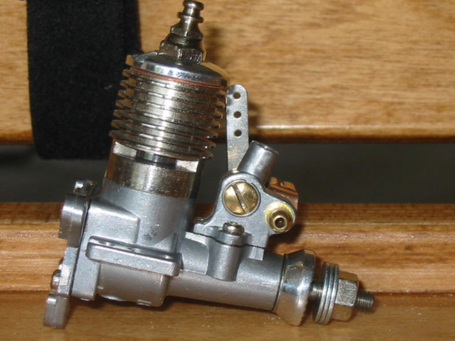

Just cleaned up the *bay Enya .049 and questions answered
Hi guys,
Sorry I have not been answering the questions here.
I have been busy doing other projects. Airplane stands, Free flight building (Fire Flies - rubber power)
Rebuilding my old McCoy engines (.049, .19 and .29) and "two" Fox 36X stunt engines.
The McCoy and Fox engines haven't been run since the late 1970's. When I flew U-control.
Building a Tatone Atomizer (from Brodak) for the Enya .10 for a duration event (tank size 14cc - total flight time 15min.)
So, 1st question from ffkiwi (muffler from a G-Mark .061 for the Enya .049 -- 1st photo?)
I did not know what muffler it was but it does work on the Enya .049 - not very well.
I was able to get the correct .049 Enya muffler from Ken Enya for $32.27 (muffler, shipping, exchange rate fees.)
Also, got some gaskets, and other engine parts as well for some other Enyas I have.
Next question from ticomareado (am I going to run it?)
Yes I have, and it a fine runner, though I wish I could use a muffler on it.
Our (my) club has a rule that engines must have a muffler installed (IF possible).
No starting engines until after 10:00am and no engines after 4:00pm (park district field).
Last question about the cleaning solution I use in my sonic cleaned.
I worked for a company (Big Yellow) and the division I worked in was the fuel injectors (Fuel Systems).
We used a solution called Master STAGES
CLEAN 2020 in our sonic cleaners at work.
It is a washing compound for Ultrasonic and Immersion Washers.
When we got injectors back from the field for rebuilds (with about 1 million miles on them - many more hours than you can count).
Those injectors had heavy carbon build up in the injector tip (part that's in the combustion chamber), and heavy dirt and crud on the outside if the injector (like a spark plug).
Put 3 injectors in a tray (rubber "O" rings as well - each injector is about 10" long x 2" dia.) and put it on the conveyor to the Immersion washer (dunk tank). The injectors go through 5 different tanks. One for the heavy stuff, and the next tanks for less and less gunk after the previous washings. The injectors are agitated (up/down) in each tank. Each tank water is at 140°F the cleaning solution is between 10% and 15%.
After the final tank, the injectors come out of the immersion tanks (washer) looking like they just came off the assembly line (new and clean injectors).
We do the same for new parts (injectors) except the last tank is a ultrasonic tank.
The injector parts have to be extremely clean and pass an cleanliness test.
If it doesn't pass, the tanks are cleaned out and the parts are rewashed until they do.
By the way, I was the Quality Engineer/Specialist that over saw the concentration % of the wash tanks, the cleanliness testing, clean out of the tanks and refill, water temp (130° -150°F) of all the Ultrasonic and Immersion Washers at the plant.
So, the Master STAGES
CLEAN 2020 is very good at removing built up carbon (longer ultrasonic cleaning for removal), is safe on rubber, viton, and tygon "O" rings and soft metals (like copper).
I use Master STAGES
CLEAN 2020 and dilute it 10%, with distilled water (from dehumidifier).
Temperature on my ultrasonic cleaner is set to 130°F and I clean the parts for 20 minutes at a time.
Got the ultrasonic cleaner at Harbor Freight.

If you look closely on the .049 that I rebuilt, I made my own "copper gasket" instead of the aluminum one.
Enya .06-II head Gasket
Thickness of aluminum head gasket is .030 inches
My Enya .06-II diesel on my test stand
My Enya .06-II Glow on the test stand
My Enya 41-4CD 4-stroke diesel -- Glow plug is a dummy
My 1st diesel -- PAW .09 (before / after cleaning/rebuild)
After ultasonic cleaning and new muffler gaskets.
Look closely and see the copper gasket above the cylinder and below the head (glow plug)
Now go back and closely look at the .06-II Enya glow engine on the stand, it doesn't have the gasket?
