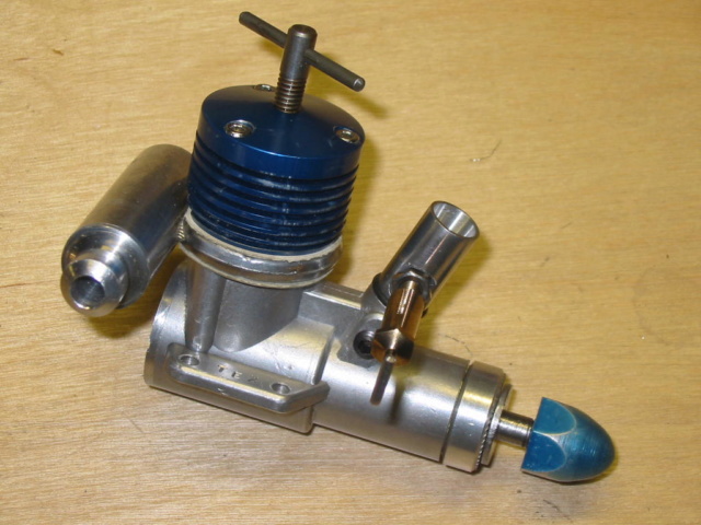

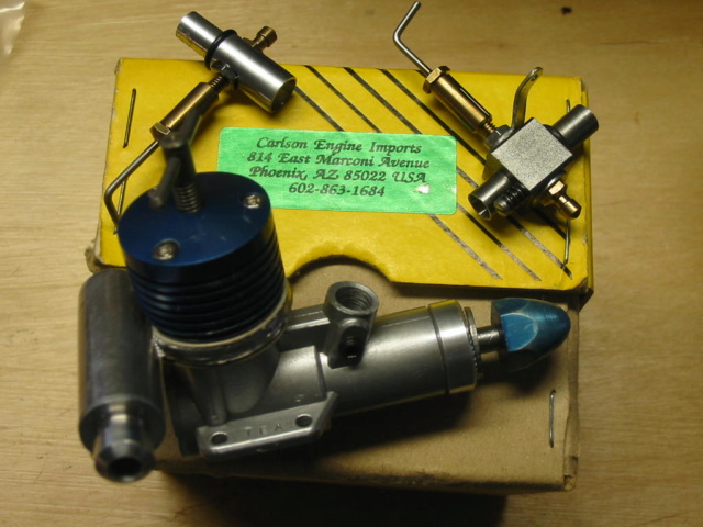

fps60,
If the venturi diameter was reduced on the carburetor on the diesel it would probably run longer than the glow engine.
I have worked with many diesel engines for fuel endurance flights.
I belong to a old timers group called SAM (Society of Antique Modelers) and the have an event called "Texaco"
One event I flew in was called "A" Texaco.
The original rules were any internal combustion engine from .051 to .20c.i and the fuel was restricted to 14cc.
Flight time for the event was 15 minutes - MAX. (motor and gliding). Best 2 flight out of 3.
I played around with MVVS .09, .12, and .15. They were ok but not great.
Looked around for long stroke diesels. They run slower with a long stroke compared to the square bore/stroke diesels.
Then PAW came out with a PAW .09 Texaco (Plain Bearing -- no ball bearings) diesel. It was good endurance engine. I sleeved the venturi smaller so when the carburetor was fully opened there was just enough RPM to lift the plane off the runway. (about 4200RPM)
With the setup I had the PAW.09 Texaco would run for 11 to 13 minutes on the 14cc of fuel.
See the photo of my cleaned up PAW .09 Texaco engine. It was only made for 4 years (1994 - 1998)
Then PAW came out with a larger Texaco engine, the PAW .15 MK1 Texaco (Single Ball Bearing)engine.
As a stock engine it did well on the 14cc of fuel.
I sleeved the venturi smaller, just like the smaller .09 and played around with it and on the test stand I was getting 15 minutes.
PAW .15MK1 only made from 1997 to 2000.
Built a 72 in wing span Playboy Sr. for the PAW .15 Texaco engine.
1st flight was 16 minutes with the engine and when the fuel ran out (14cc) my total flight time was over 1/2 an hour.
2nd flight was longer because of the thermals later that day.
3rd flight I did not have to fly because the take your best two of three flights and since I did over 15 minutes (Max. time) those were the ones they had to use.
To make a long story short, I did this for 2 years at each contest I entered "A" Texaco.
So, they reduced the diesel fuel to 8cc. I win but not like did before.
Now, I have gone to 4-stroke glow engine. I use the O.S 20 4-stroke engine to compete.
Installed it into my old (former diesel plane) Playboy Sr. and am winning again.
I use white gas in my fuel with the castor oil/ synthetic blend oil. and I use a battery to my glow plug to keep it lit.
I heard of a rule change of using only fuel give to contestants at the contest for the Contest Director.
No special fuel blends!
Sorry that the PAW Texaco engines are no longer made. They were very good in that event.
PAW .09 Texaco -- Plain Bearing engine
PAW .15 MK1 Texaco -- Single ball Bearing engine
