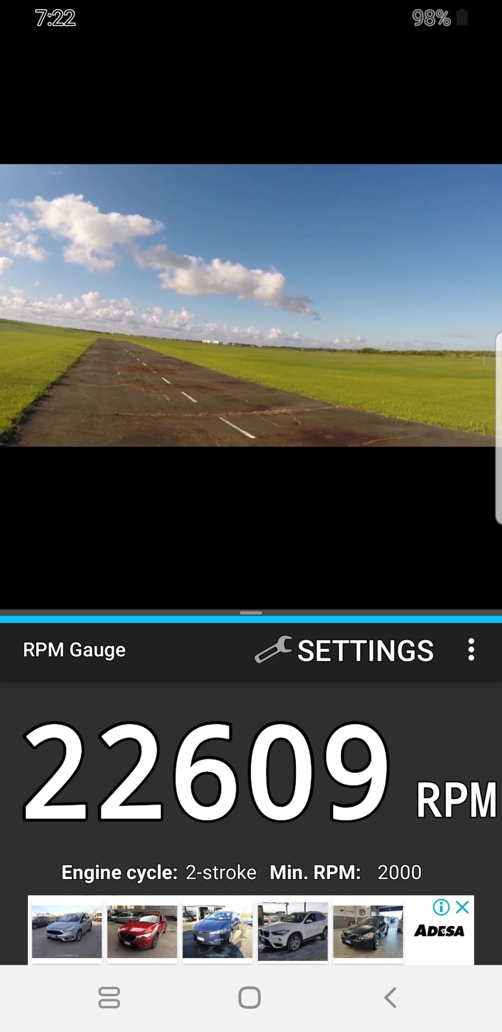

Re: Willy Nillies Simple 250
Nice flight Troy with engine speeds unloading near 22k!
This vid has given me the inspiration that may land an order for the kit with Willy Nillies soon.
I am also flying a home breed Killer Bee on my Lil Roughneck. The weak point of those otherwise very good Killer Bee backplates is the black seal sleeve on the NV. I always make sure the seal is tight and replace it when gets loose around the NV stem, plus pull a silicone tube over it and the NV stem. The early stop of the engine run and fuel left in the tank can be indications of air seep into the spraybar bypassing the NV..
@Brad thanks for referring to my Quickie100 video.. I like becoming a classic reference
. That red postage stamp backplate 190 has a Kamtechnik turbo head and the APC 4.5x3.5 prop, that sent the rpm beyond 28k unloaded even with only 20% nitro in my cocktail.
Those APC 4.5x3.5 props seem to have gone extinct in Europe. I could find and buy only 2 from 2 separate Hong Kong ebayers recently and they are on their way to me. APC in the US would charge me a fortune for shipping from there.
I really like this forum with so much to see and discuss international COX experience with you guys all...

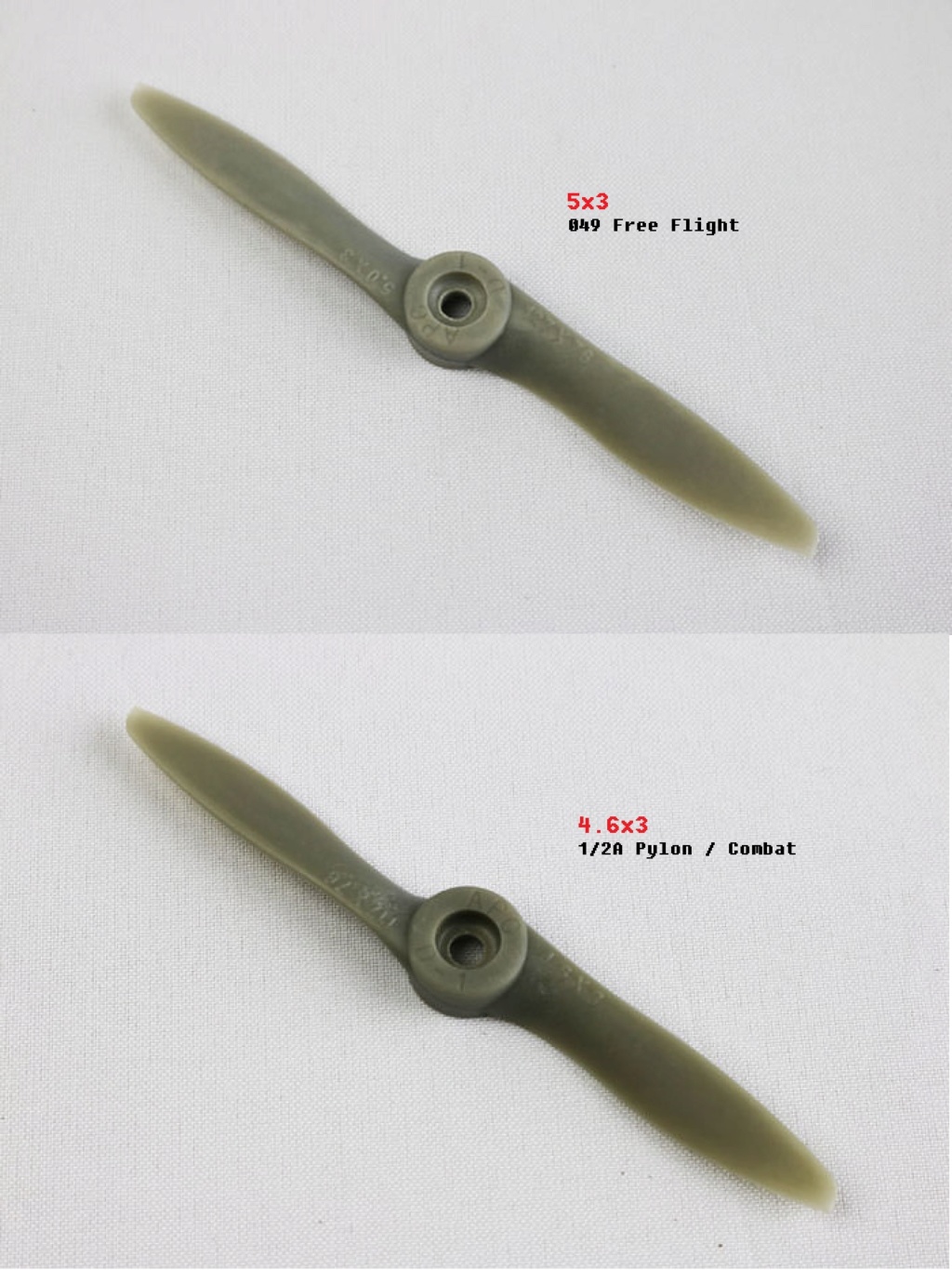

https://www.apcprop.com/product/4-5x3-5/
4.5x3.5
1/2A Pylon / Combat
I buy direct from APC using Pay Pal
In fact just bought some 5x7.5E and
the unique 4.6x3
4.6x3 application in the air with what engine?
One that is running at suitable rpm with a 3P
A KB with a mylar reed and turbo plug makes
near stock TD power with some props this one
30k / 85PS running with the right plane.
G Mark .03 would be my next engine choice.
Thrust will be outstanding with a bare bones
3ch KB on steroids 5.4oz. RTF is possible.
The 4.6x3 at 23k static puts out 10.7oz thrust.
Great thrust ratio will make for instant top end
speeds / massive vertical thrust to make for
freight train power in any direction / good breezy
day prop.
Thank you Eric, certain props create projects.
Andras I am surprised the TD 20 size Quickie 100 hits 11oz with a reed
engine and fuel. Certainly is flying well and weight requires a bit of prop
dia., the 4.5x3.5 has hit a sweet spot with .049 reed power!
The 250 series planes are good test bed planes for reed engines / props.
The size is up to date for today's small IC flying. Troy did you ever find
a way to check the weight of the plane RTF?
The plane weight to beat is 6.1oz / 3ch / TD .049 with throttle sleeve
15cc tank 3.20 mins total run time few passes at trim speeds then
full throttle rest of the flight. I would be willing to build all balsa less
firewall for a shot at 5oz RTF with a reed engine and a 4.6x3 prop.
20 -30cc tank for reeds.
