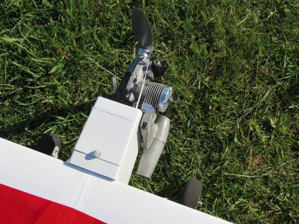

I haven't seen many threads on the Cox Conquest engine, so here is a place/thread to fill in with your favourite mods and other experiences.
This engine is perhaps the best engine that Cox ever made. Even the RC version with the "Enterprise" muffler will leave most modern .15 (sport) engines in the wake.
Here is one mod to start things off, a DIY muffler extension in order to get the funky muffler to clear the fuselage:

Neat piece Kris,
Did you make it yourself?
Posts : 11849
Re: Cox Conquest, mods and experiences.
Yes, I made it myself, I have a small combined hobby lathe and drillpress which works okey for most soft materials and a limited accuracy. The most tricky part with the extension was the inside, I wasn't able to set-up and machine it through in one go, and even had to use a dremel to finish it. Will try to get an image of the inside too.
I'm using the stock Perry carb, and it is a little inconsistent at the lower revs. I guess it is partly due to the lack of muffler pressure, but I haven't dared to drill into the pretty muffler yet. The high-end could benefit from tank pressure too I think, there is quite a big difference when the plane is held up-right.
A standard test (for me) on other .15 engines has been 8x4, and 7x5 props. The ASP .15 XLS will spin an 8x4 prop at around 15000rpm, which is okey I think. The Fox .15BB would only do about 14400rpm, while the Conquest will do a wopping 16500rpm.
The engine shown above has the first generation conrod (cast aluminium) and I haven't dared to push it very hard, apparently the conrod cannot withstand much more than about 22000rpm.

I was wondering how you joined the slots on the extension. Dremels are good for a lot of things. I did many tests with .15 size motors using 10% fuel, 7-5 M Airscrew prop and no muffler, mostly just to see which motor to use for different planes, but also to check mods that I tried like turbo plugs and crank fillets etc. The Conquest was right up there @19.500 compared to a Rossi at 19,000. I bet the Conquest would do better with a turbo head too. The Rossi had a stock head, likely a #2 or 3. The gold head Taipan was18,300, Fox BB 17,100 after removing .018" from the head button. Could not believe how big the combustion chamber was on that. I made up a turbo head for it too for that reading using a burned out Rossi insert. The ASP was 17,600 but with a new turbo head got up to 20,500 which matched the Fora!!!!. I bet the ASP would break with a smaller prop though. LA .15 is about 17,500 for comparison. My TTiger and MVVS were in the 13,500 range. Just to keep things Coxy here, the Sportsman reedy was 12,800. No TD .15 for tests yet.
aspeed- Platinum Member
- Posts : 625
I simply made the extension in a single block of aluminium, using two 4-40 screws to hold it to the engine and two M3 screws (similar diameter to the 4-40 in size but a more common thread around here) to hold the muffler to the extension. The angle for exhaust gas inside the extension is less then 45° (compared to going straight out) but I didn't manage to machine it all in the drill-press (I envisioned a nice "S-curve" but didn't manage very well) so finished the job with a dremel and some JB weld to repair my misstakes...
