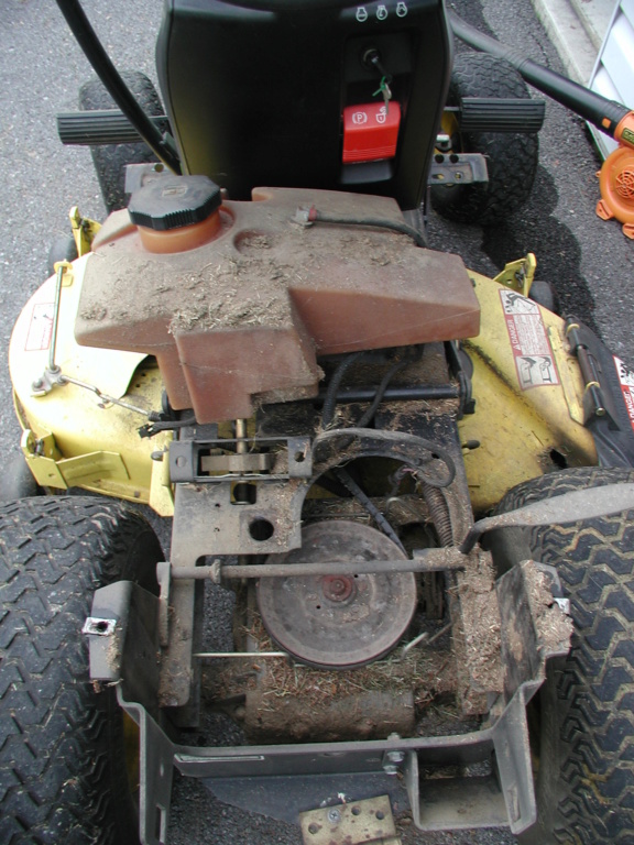

Going along well, the mower just stopped moving. Motor running fine. Oh, oh.....transaxle or drive belt. Hoping for the belt. Got the ATV and pulled it back to the garage after pushing it about 30 yards up hill to a cleared area. Not the first time.

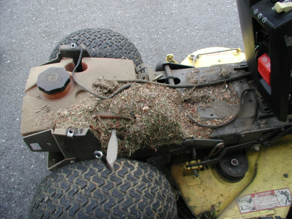

Removed the body pan and found Florida grass and sand everywhere. Cleaned it up and hosed it off.

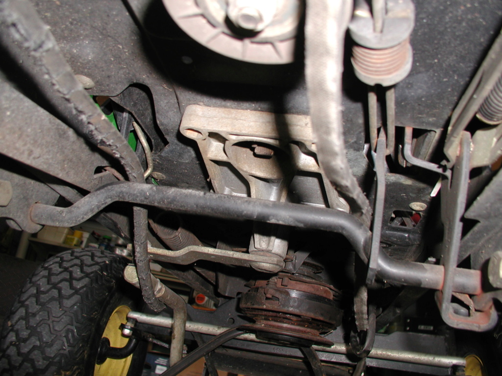

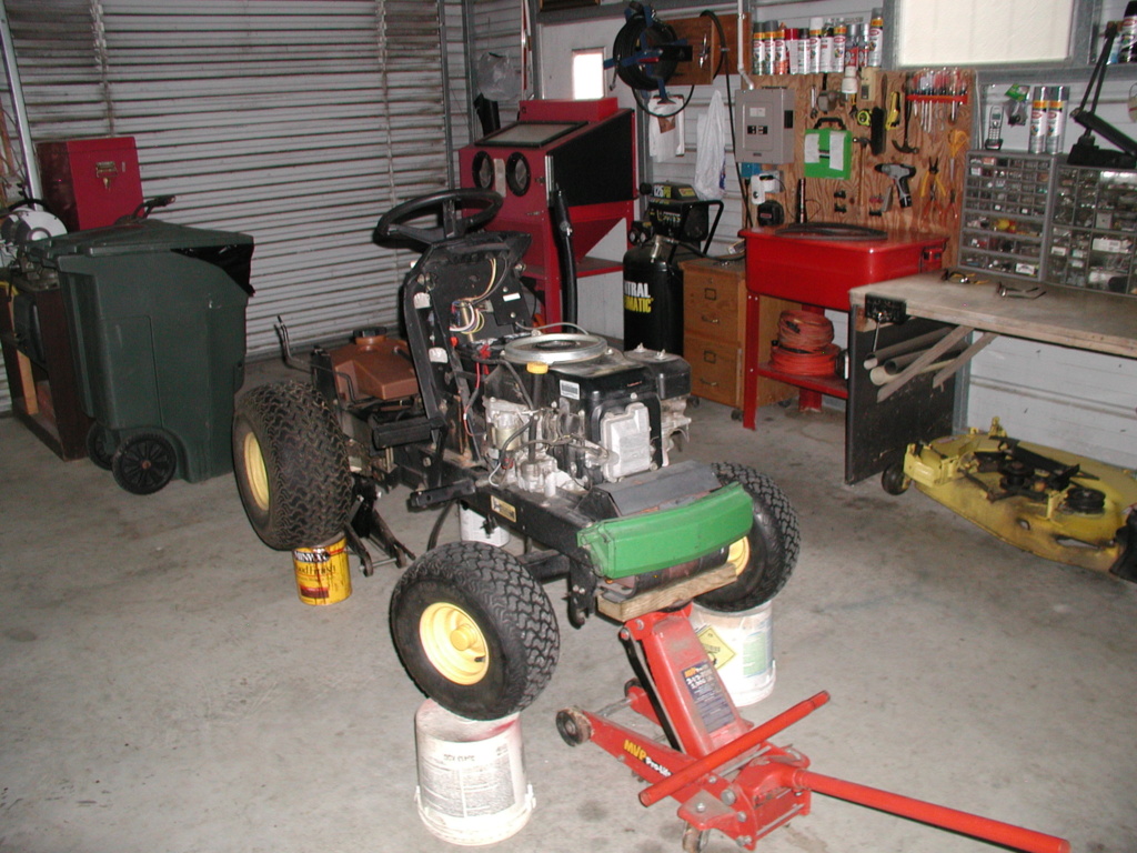

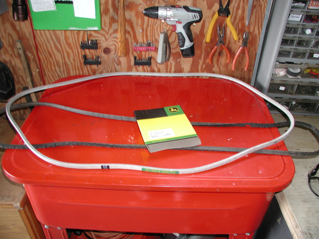

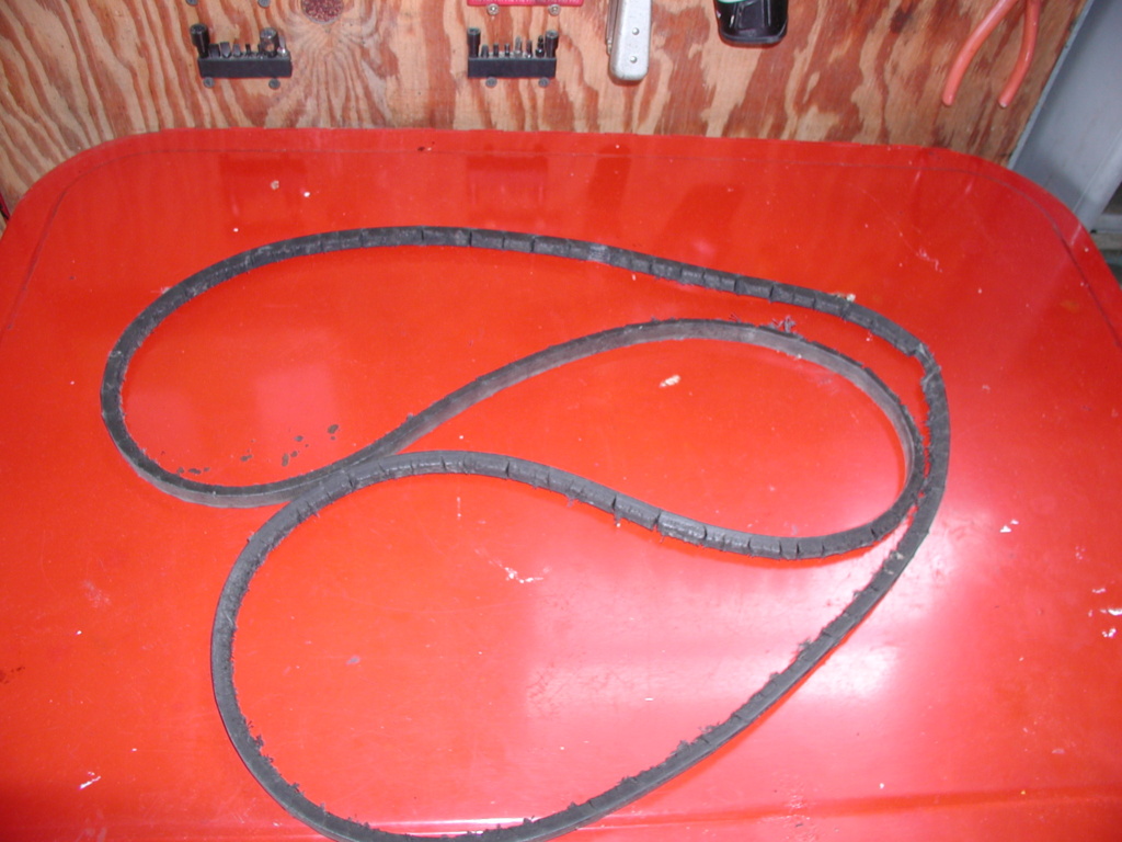

Jacked it up to get a better look. Belt a mess, at least 25 years old, frayed but intact. They did not intend for you to remove the thing nothing in the book about how to do it. A mixture of idler and drive pulleys, guides, springs, steering arms and electrical connections that had to be removed or disconnected. Ordered a new belt.

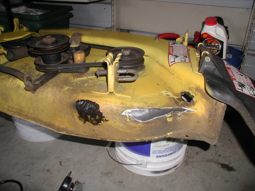

Thought while I have the mower deck off I would deal with the holes sandblasted over time with Florida sand. Doesn't happen here. Used JB Weld on the small hole, probably won't last - and steel sheet bolted in on the larger hole which will be filled in with JB on the outside. Might as well grease the spindles and replace the blades while I'm at it.

I am surprised you don’t have a little MIG welder to close up those holes.

Got one Ron, (belongs to my son) but it works so poorly that I seldom use it.
Used it on the zero-turn mower to repair some cracks and a badly bent/broken hangar caused be me running into rocks and stumps. Dissatisfied, I brought it to the local welder who did a great job. Well spent $45.

Pretty sure it was the belt Bob. Put it in neutral and spun the transaxle pulley with no problem. Put it in gear, spun the pulley and the wheels turned. And as Rod said, maybe a stick moved the belt off the pulley, I did remove a stick stuck up there after I got it in the garage.

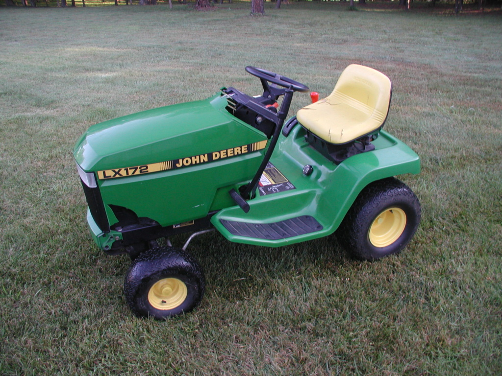

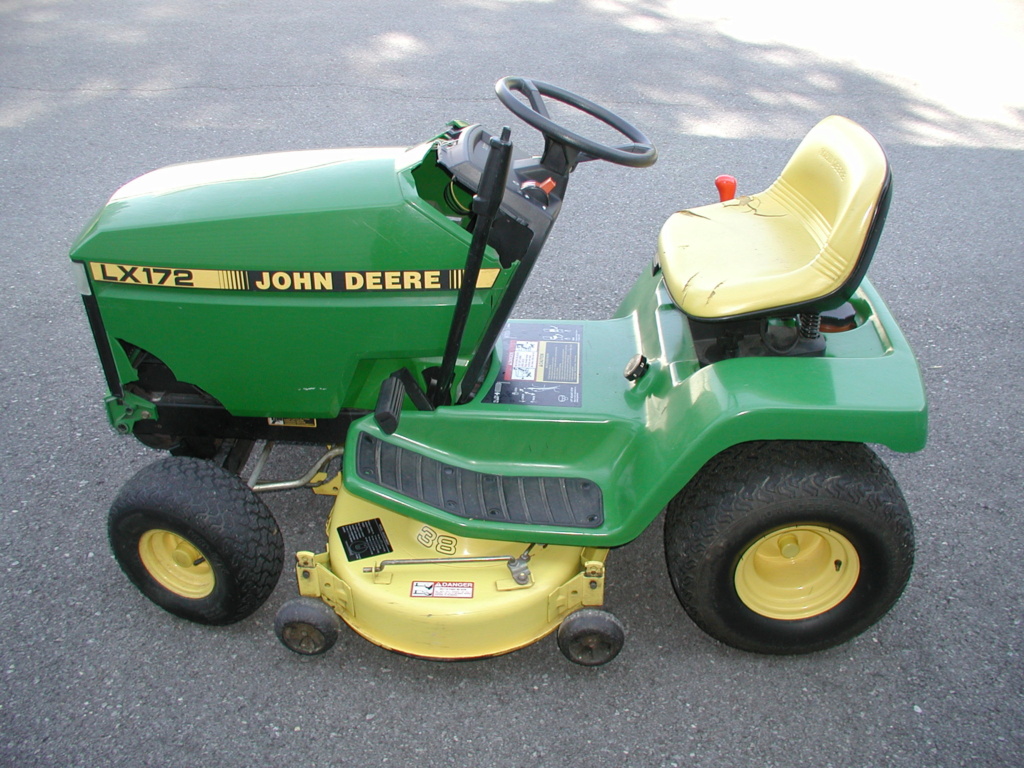

Got a lot done on my John Deere LX-172, 25 years old and a gift from my wife when we retired to Florida. Guess she wanted to ensure i kept the lawn mowed. Florida sand "sandblasted" holes in the mower deck that I repaired with JB Weld and bolted in steel plate. Took about 36 hours for the JB to dry rock hard. I used a rasp to shape it then sanded it down a bit and painted with primer and some Krylon yellow that I had on hand. Not a bad match.
Got the new traction (drive) belt in and replaced it, no easy job but it should be good for another 25. Testing flat out through the woods in fourth gear it held fine.

Hey BOb! Nice repair on the mower deck! Ya can fix alotta stuff with $1300 worth of JB Weld! I’d rivet or screw a patch of hardware cloth on the inside of that opening on the LH side of the hood then bondo or fiberglass over it, sorta like what you’ve done to the deck. I’ve used “Gator blades” on my rider. They’re a little thicker than the standard blades, but turn small twigs off the trees into compost! This year I have run over enough molehills it looks like the inside of the deck has been sandblasted!
