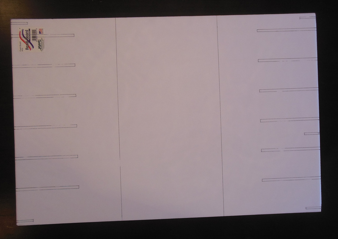

I’ve been constantly “cleaning” my work space and decided I needed to have a better storage method for my planes than just stacking them in any ‘ol corner. I’ve seen people make them out of PVC or wood, but I wanted something cheap. Thinking for a few minutes on it, I figured Dollar Tree Foam would do the trick. Four sheets of foam would make three plane storage racks. The sheets are 20”x30”, so I decided a 10” base and 10” sides would be about right. I started by drawing lines for the base 10” from each side on three of the boards. Then I drew some lines for the cross pieces on the end ½” from the sides. From there, I drew lines for ¼” slots every three inches. One more set of lines for an intermediate cross piece finished off the marking.
![Cheap storage DSCN7215](https://i.postimg.cc/QMypg44T/DSCN7215.jpg)
Then I cut 3” by 20” cross pieces from the fourth board.
![Cheap storage DSCN7225](https://i.postimg.cc/brHD53TL/DSCN7225.jpg)

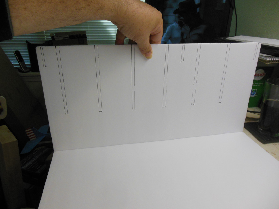

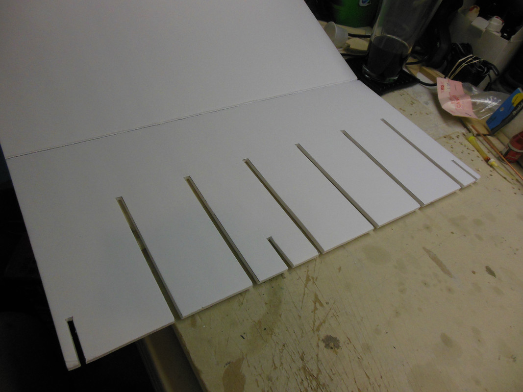

I scored the board down the middle and folded up the sides. Then I cut the slots. The cross pieces were inserted and then hot glue was used to set the end pieces.

I am having a dimensional dilemma. You’ve made a “u” shaped box out of a 30” wide board= 10 x 10 x 10 side, bottom, side. Ok, now you made support rails out of another board that are 3” wide by 20” long, with slots approximately 1” in from each end, making the support 18” wide?? Shouldn’t the supports be 3” x 12” so the slots being 1” in from both sides match the 10” width of the sides? 2nd cup of coffee, an I’m still going HHmmm?
It’s not gonna stop the world from turning, but I think it was just a typo on the 3 x 20 should be 3 x 12. YMMV. Your measurements may vary!

For the supports, I cut ten 3"x20" pieces from one board. I then slotted one end one inch from the end. Made another slot 10 inches from that, and then cut off the last eight inches from the other end, making a piece 3"x12". I just tossed the 3"x8" piece in the trash. I suppose I could have cut the cast off pieces into triangles and glued them into the bottom corners of the box, but I didn't bother. Maybe next time I will.
