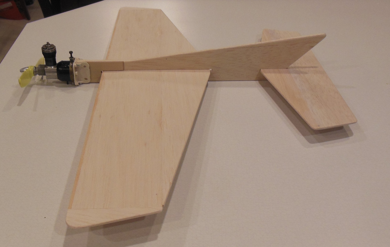

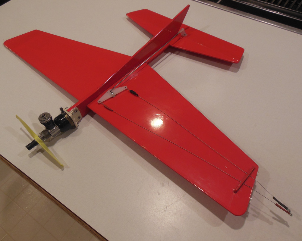

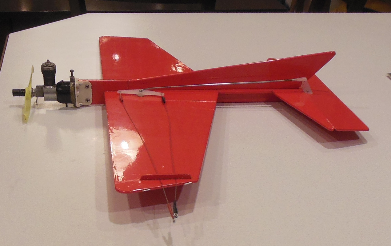

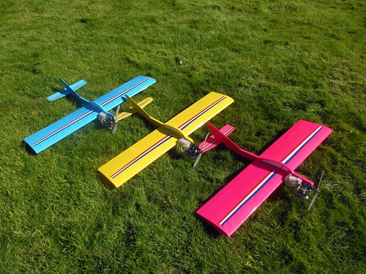

Since I joined the CEF seven year ago, I’ve continually quested for a plane that I won’t care if I crash. But I haven’t found one yet. No matter how ugly the plane, I still can’t bear to crash them. Definitely the reason I’m not advancing. A couple of days ago something made me start thinking of the Testors Ambush. Not sure if it was a thread here or somewhere else. So I looked at the plans again. The whole plane was designed to be built with two sheets of 1/8x3x36 balsa and a couple of scraps of 1/8 ply, so I pulled out a couple of sheets of balsa and printed out the plans.
But, as anyone who’s read my past posts knows, I can’t just build per the plans. I’ve always thought the firewall construction was rather cumbersome. So, to save work and time, the magic Brodak Mount came out. Since the fuselage is 1/8” balsa, I figured I’d use 1/16” ply for doublers and have the right width for the engine mount. Horror of Horrors! I couldn’t find any 1/16” ply! Ah, well. On to the next best thing, if not a better solution. Instead of 1/8 for the fuse, I would use 3/16 for the fuse for more strength and use 1/32” ply for the doublers. I think this is a better, if not quicker arrangement. The rest is more or less stock. Here’s the bare bones plane. The fuse height as designed is exactly right for the Brodak mount.
Since I don’t want to care, I looked for the most unwanted, leftover covering I have. At least the most unwanted that I have enough of to cover the whole plane. So I grabbed the roll of mystery no-name red covering in my box. I really don’t like this stuff, so maybe I’ll abuse this plane more. The pictures look kinda pink, but it’s bright red under my work lights. Here it is covered and ready to fly:

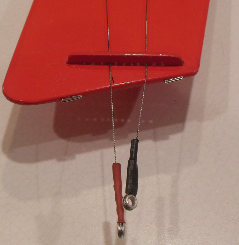

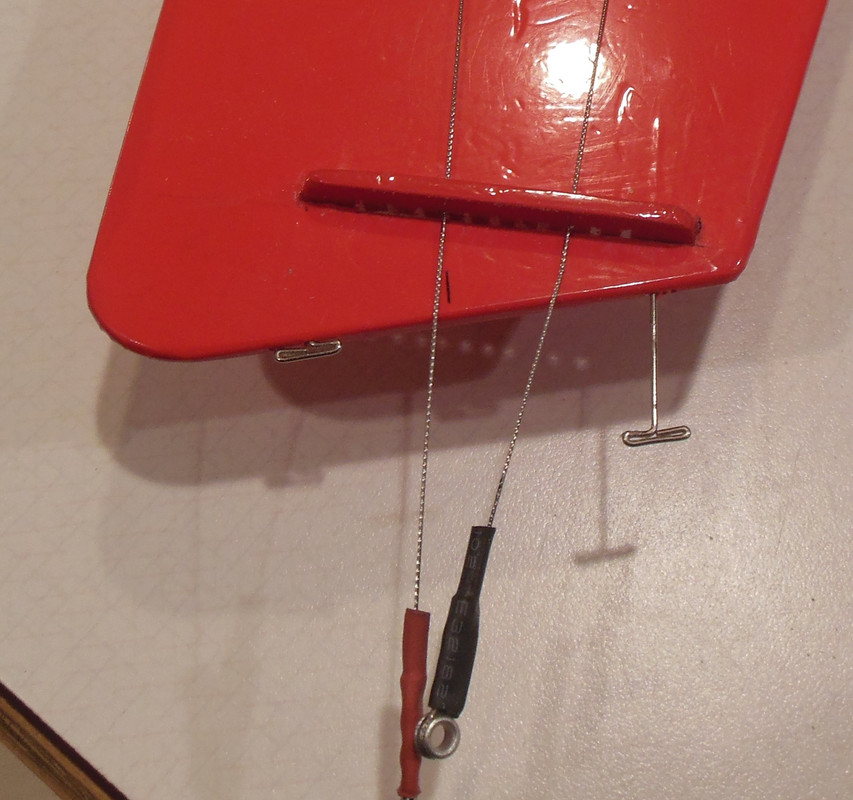

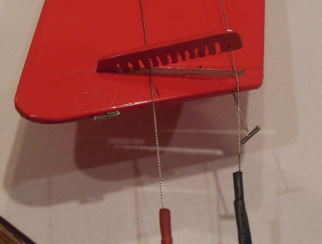

I built the adjustable leadout guide per the plans, but I’m not sure yet if I like it. The guide is a stand lone part that is pinned in place in the wing. One pin through the front of the guide and one at the back hold it in place. To adjust the leadout positions, you pull the rear pin and the guide tilts up so you can select different positions.
Hopefully I’ll get it in the air tomorrow. The Black Widow is well exercised recently and should run like a champ.

It is certainly a nice little plane Mark, and I like to idea of your adjustable lead out. ...just do not crash it even if you built it not to care about crashing! Have safe maiden flight..

Looks like a winner to me . Simple and quick to build , I like the lead out guide and think I'll try it out on my next build . Good job Mark .

Mark, you do come up with some conventional non-conventional stuff. I love the simple design and ease of construction and especially the lead-out guide. The pins are genius and something that I never personally seen before. That's a mighty elevator on that bird.
I have some decades old light blue monokote that would do well for a project like that. But I would use expanded SIG 4" airfoil for the wing cut to those dimensions, but SIG hasn't had that in stock for months despite my protests.

That is really a looker. Great job on it. Simple yet very attractive.

Ron, I appreciate the input. Believe me, I have no shortage of large .25 to .46 sized planes. I build large, too. Currently flight ready are: Two full sized Ringmasters, three full sized Flight Streaks (well, one is a Doodle Streak and one is a FliteRay, and a fourth ARF in a box on standby) an Electric Super Clown, an electric E-Flight PT-19, a Smoothie, a Magician (the SNAFU design, not the PDQ design), and three identical Skyray 35s.
But I'm still just a 1/2A guy at heart. I love flying 1/2A more than larger planes. I usually take a large plane and a couple of 1/2A planes when I go to the field. The Ambush is just something I've been thinking about building for a few years and I suddenly wanted a one-day build that I'm not invested in.

Just re-read the posts. Just to be clear, the leadout idea isn't mine. It is how "Wild" Bill Netzband designed it. I just built the leadout guide as designed.
Also, I forgot to add that I glued in a 1/8" stick of spruce to the leading edge for crash protection. The fuselage is supposed to be built in sections, with the upper fuse glued to the wing and stab, then the lower fuse glued to those. Still seemed cumbersome and time wasting. Besides, I wasn't so sure how strong the sectional fuse would be at the engine mount, even with the doublers. So I built it as a single piece fuse and glued the wing and stab into that. After the plane was covered, I cut out the section between the wing t.e. and the stab, and glued in the strengthening cross piece.

The elevator IS huge. "Wild Bill" Netzband really liked to build big tail surfaces on his planes. Do a search for the Doodlebug over on SH to see how he designed. I have the deflection right at 20 degrees for the elevator. That's the minimum I could go with this elevator horn and bellcrank. The horn is not the one that comes with the bellcrank, it's a Goldberg 1/2A control horn. I also thought about the SIG airfoiled balsa. I have a sheet of 4" airfoiled balsa I saw when I was pulling out the sheets of 1/8" balsa. But the wing root has a 6" chord, and the tip root is 3 1/4", so it'd have a really funky transition from airfoiled to flat about a third of the way in from the tips.

True. But even though they were built to crash, I still hated to crash them. I crashed my BTC-4 about three weeks ago at our club Labor Day fly-in. Only took 10 minutes with some Medium CA to put back in flying condition, but it still hurt.
