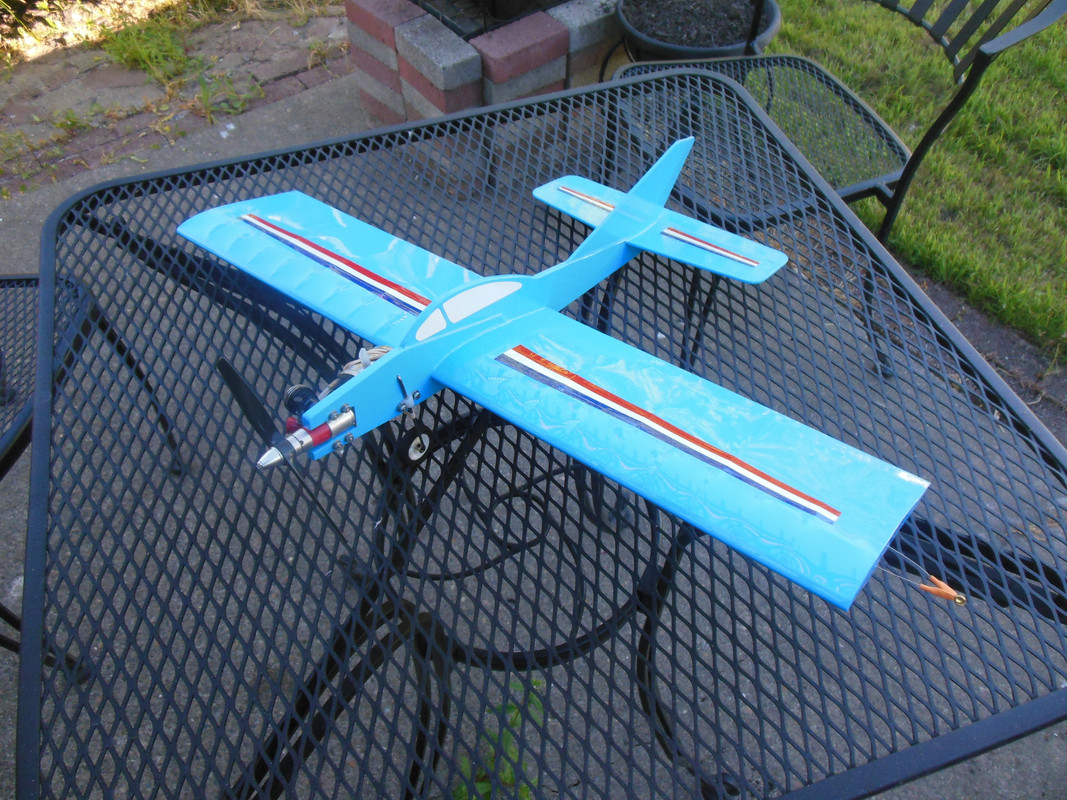

Nice choice of plane! I really like building mine. The spars were kinda wonky but lots of weight and patience was able to build them out. I went with a evo .36 but found it very nose heavey, needed about 3ozs to the tail to get the c.g. right. I think the .25 la would be a much better fit as mentioned above from a weight savings perspective.
Here is the color scheme I went with if your looking for some ideas.
![Sig Skyray 20200610](https://i.servimg.com/u/f61/19/81/83/93/20200610.jpg)

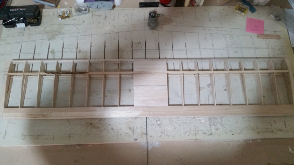

Well I'm on my way building a SkyRay .35, have finished the wing and on with fuselage and getting the wing fitted to it, here's a couple of pictures. I have built this plane with white glue only, first time the CA has really started to mess up my nose and sinuses. So I wanting to ask a question on gluing the wing in just using white glue, i have for as long as i remember glued the wing in with epoxy, who else just uses white glue on installing the wing to the fuselage?
![Sig Skyray 20210122](https://i.servimg.com/u/f52/19/38/13/05/20210122.jpg)
![Sig Skyray 20210123](https://i.servimg.com/u/f52/19/38/13/05/20210123.jpg)
![Sig Skyray 20210121](https://i.servimg.com/u/f52/19/38/13/05/20210121.jpg)
![Sig Skyray 20210125](https://i.servimg.com/u/f52/19/38/13/05/20210125.jpg)
![Sig Skyray 20210124](https://i.servimg.com/u/f52/19/38/13/05/20210124.jpg)

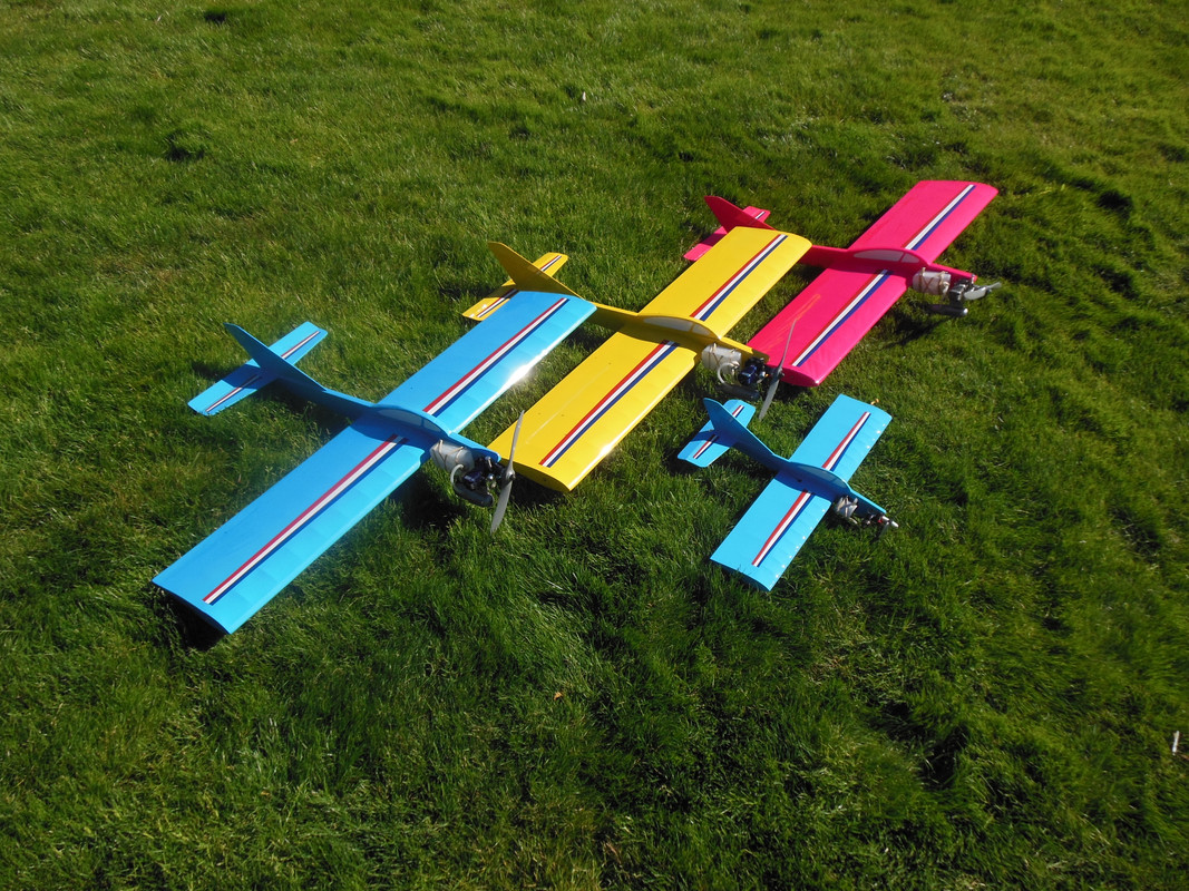

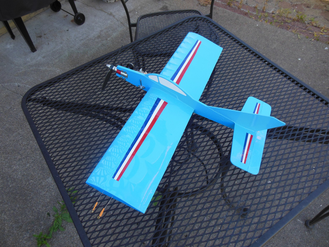

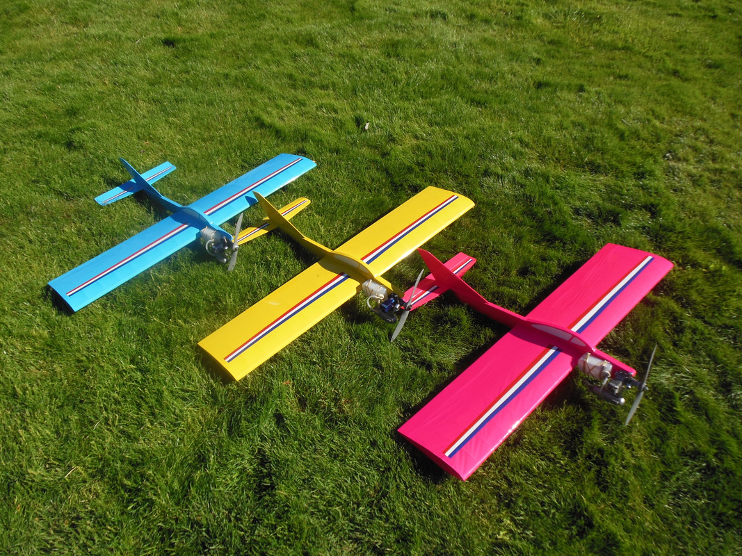

I built a trio of Skyrays a few years ago. All three are identical with OS .25 LA-S engines. I figured I’d take two out and if I crash one, the remains go in a plastic bag and I pull the other out of the car and keep flying.
![Sig Skyray DSCN5342](https://i.postimg.cc/FsgBrpNK/DSCN5342.jpg)
![Sig Skyray DSCN5339](https://i.postimg.cc/kXFx6h2k/DSCN5339.jpg)
I built the pink one because my wife said she’d learn to fly if I built her a pink airplane. She didn’t think a Manly Man would ever build a fluorescent pink plane. Well, I built it and presented it to her, but she politely declined. She always does that… So the pink plane was the first one I took out to fly at the field, figuring if I was going to crash one, it’d be the pink one first and I’d be able to throw it in the corner and move on to the yellow and blue planes. Well, one Wednesday morning I crashed the pink one, and proceeded to pull the yellow one out of the car and keep flying. My evil plan to get rid of the pink plane was progressing nicely. Until the guys at the field started razzing me about real modelers not throwing away planes and such. So, pride in hand, I had it repaired and flying by Friday. I pretty much fly the pink plane exclusively because I haven’t crashed it again. I’ve flown the yellow one a couple of times, and the blue one’s never seen air.
I also wanted a better 1/2A Skyray, so I reduced the rib profile to 53% and made a built-up wing to go in a standard 1/2A fuselage, using standard tail surfaces. I call it my Skyray 110.
![Sig Skyray DSCN5356](https://i.postimg.cc/TYcPqj2L/DSCN5356.jpg)
![Sig Skyray DSCN5358](https://i.postimg.cc/02GnsNPR/DSCN5358.jpg)
![Sig Skyray DSCN5316](https://i.postimg.cc/bNHvH7H9/DSCN5316.jpg)
The Manly Mark
The Manly Mark

Wing looks good and straight , I wouldn't use wood (white glue) on the installation of the wing it doesn't fill gaps good when drying the epoxy 30 mins. is what i have used . This is a good wicking glue .
