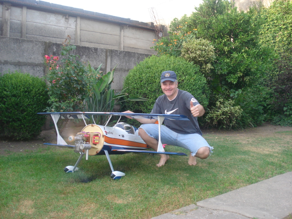

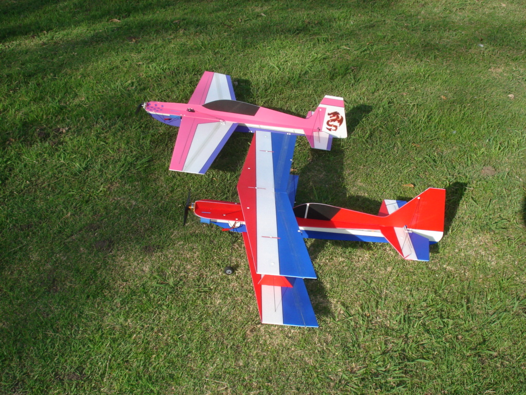

Post  MauricioB Wed Nov 04, 2020 12:00 pm
davidll1984 wrote:Is it just me the pits is the great plane électro 12s ???convertion To 50 cc gaz ???? Like that modèle ultimate bipe y have one wit old sportsman .15 engines fly bad under powered tink of change engine for Good performance of that modèle if some one can help me figur  right size engine To fit m'y model tink of .15 enya cl engines modified To rc posible .19 super tigre 🐅 control Line modified wit carb from cars very powerful engine Witch chose ??? Super tigre little bit heavy tink advice from bether builder than me can help
Hi David, please ask listed questions, that way I can answer you by better interpreting your language. Thank you.
The Great Planes Pitts is exactly this: http://www.greatplanes.com/discontinued/gpma1421.php
I no longer have this model airplane, I sold it many years ago.

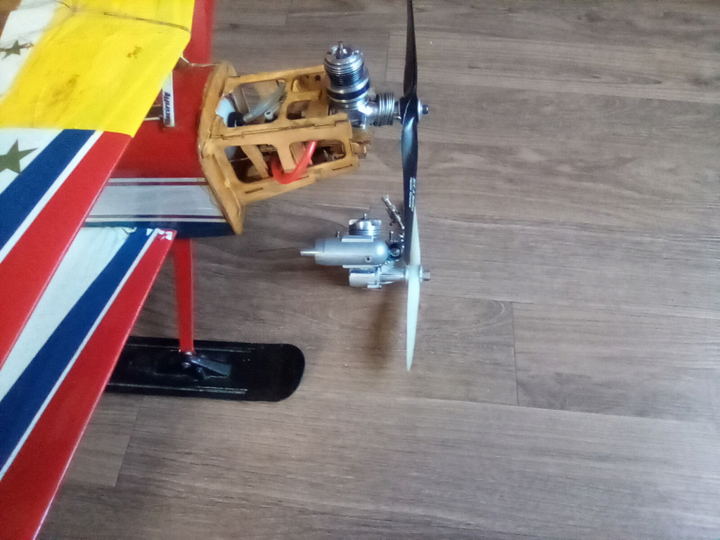

Post  davidll1984 Thu Nov 05, 2020 9:18 am
Hi mauricio m'y model is great plane électro?? Not sur for power 450 480 y did convertion To cox sportsman . Model deserve bether engines for best performance of model y have two engines Not used cant chose Witch engine m'y modified enya .15 and super tigre.19 tink m'y .15 enya Good for him je picturs of Cox Fun Model .049 ... flight, flight and flight!!! (page 3 & 5) - Page 4 16045810
Not sur how To place engine tink y have To place cylinder inside cowl nose tink is impossible To fit larger engine??? Not sur
Posts : 2096
Cox Fun Model .049 ... flight, flight and flight!!! (page 3 & 5) - Page 4 Empty Re: Cox Fun Model .049 ... flight, flight and flight!!! (page 3 & 5)
Post  davidll1984 Thu Nov 05, 2020 9:30 am
Cox Fun Model .049 ... flight, flight and flight!!! (page 3 & 5) - Page 4 16045811
If place engine on side y have To build new engine mount y want best performance result wat if y place engine just like the cox engine ?? Best configuration for engine performance ? Y am lost litle cg on bip is litle harder To Find y have place for extra weight wit cox

Post  davidll1984 Thu Nov 05, 2020 11:19 am
Yes mauricio its that one wat it look new befor its crash wit 450 brushles power rf or Somting wrong wit contrôle after repair y wanted To try m'y cox .15 in it just for fun now tink after see your bip y wanted m'y capable of prop hanging ilimited vertical or close To it for 3d capable need best power To weight ratio tink y am very close To get cg Perfect now wit .15 enya Cox Fun Model .049 ... flight, flight and flight!!! (page 3 & 5) - Page 4 16045910
Cox Fun Model .049 ... flight, flight and flight!!! (page 3 & 5) - Page 4 16045911
Not fixed y have To build new engine mount for him and clean oil tink is the Good engine for Not sur Huh...

David, I've been looking at the Great Planes manufacturer's directions for your model.
SPECIFICATIONS Old Bugger
Stock Number: GPMA1546
Wingspan: 33.5 in (850 mm)
Wing Area: 383 in² (24.7 dm²)
Weight: 27.5-31 oz (780-880 g)
Wing Loading: 10.3-11.6 oz/ft² (32-36 g/dm²)
Fuselage Length:37 in (935 mm)
Requires: 4+ channel radio w/4 micro servos, 950kV brushless outrunner motor, 25A brushless ESC, 11.1V 1250-2100 LiPo pack and prop.
tabla de equivalencia entre motores glow y electricos.
20-size glow engine / 300w electric motor
ADVERTISEMENT
REPORT THIS AD
(OS Max 0.20 engine develops 0.4 hp = 300w electric motor (AXI 2820) )
35-size glow engine / 500w electric motor
(Fox 0.35 stunt engine develops 0.7 hp = 522w electric motor)(AXI 2826)
40-size glow engine develops 1.0 hp = 750w electric motor (AXI 2826 or 4120)
60-size glow engine develops 1.3 hp = 975w electric motor (AXI 4120 or 4130)
90-size glow engine develops 1.6 hp = 1200w electric motor (AXI 5320 or 4130)
1.20-size glow engine develops 3.0 hp = 2250w electric motor (AXI 5330)
DA-50 develops 5.0 hp = 3750w electric motor (AXI 5330)
DA-100 develops 9.8 hp = 7311w electric motor (Double AXI 5330)
From what I can see, your model needs power to be able to perform stunts for what it was created. Unfortunately none of the motors that you have there offer you the necessary power to be able to do stunts and hang the model. It needs a lot of power.
The size of your model is small to fit a powerful Glow motor, you will end up sinking with a lot of weight and the wing loading will expand more and more.
There are some technical parameters to respect, in order to meet 3D stunt objectives.
That model that you have there, if you want to do high-risk stunts (3D), you must motorize it electric, if you place any of those glow motors that you have there, the Cox .15, the Enya or the Super Tigre, you can Maybe fly it but for a calm sport flight enjoyment.
Those engines will not render you for 3D stunt.
If you want, I advise you to do the following: Assemble your biplane with the engine that you like the most of the ones you have there, fly calmly and enjoy a Sport flight or place a powerful electric motor and start rehearsing 3D stunts, the latter it is not the best if you are a beginner.
I prefer that you practice 3D acrobatics, with a Foam model, look, I make these models myself and you really learn a lot at a low cost.
Here I am making the foam models:
Here I am piloting an electric Ultimate of my own manufacture:
You can do it, you can have fun! Thumbs Up

Tank you so mutch for al Good info y réalise now wit .15 modified enya may Not giving best power but wit .15 m'y plane cg look ok no nead To ad extra weight just gear batry and m'y Reciver place in back of cg just behind it plane weight les than its 880 g max y work on the plane tonight wil finish complète its cowl nead repair and the plane weight 860 g no fuel in it it let 20 g of fuel y wil start fly litle over. 880 g wit fuel y build m'y engine for max posible rpm Not sur for prop size get max trust Not tested m'y engine y use lot of litle modification Not sur how engine wil run it start al redy good sign just Prime no fuel in tank de if sound ok after modification

Hi mauricio m'y engine setup upgrades parts and modification To engine is cars .15 carb larger pipe exit modification to crank chaft Intake change litle y tink of ramp inside crank Intake port flow inside sleave modification just To help flow dynamique Not larger Intake port inside piston Intake exit Not change in timing of engine is alredy Good timing cl engines use very litle différence wit rc enya.15 and giving litle extra performance wit carb pipe mod compare To oem rc enya engine y like piston in old enya engine compare To new engine without the top fuel retanig ridge it help wit hi flo presurised carb setup piston retain fuel inside its chamber its like place wasp .061 carb wit pipe To cox tee dee .051 wooott rpm gain y wil try it today engines is redy worked al night on y dont have internal picturs its m'y secret like Ford wont tel Ferrari is secret at last Not in publiques Cox Fun Model .049 ... flight, flight and flight!!! (page 3 & 5) - Page 4 Screen27
