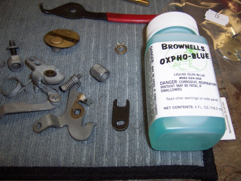

For everyone else, Birchwood Casey will work, but the best gun blue by far is Brownell's Oxpho blue.  Cost's a bit more but the results are well worth it.  I used to buy it by the quart.  But it is available in smaller sizes.
Don't worry about getting it inside the cylinder.  I just dump cylinders on a string into the solution (I keep a small bottle for that) for 30/40 seconds remove it, rinse with cold water and burnish with a cloth or soft tooth brush with Remoil which neutralizes the blue.  Some advocate baking soda, but I find that an unnecessary step.  When your through use a .45 caliber brass brush through the cylinder to remove the blue which in my humble opinion isn't going to hurt a cylinder requiring a reblue anyway.
I have done about 10 Cox cylinders this way with no ill effects. Many firearms too along with car parts.

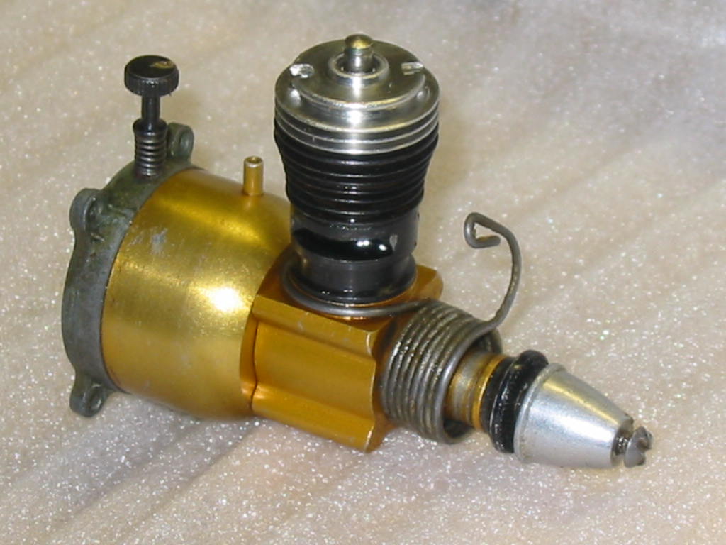

Post  sosam117 Sun Dec 06, 2020 7:00 am
DougW
I have photos of a refurbished Golden Bee.
I purchased it from R/C Group.
Cylinder blueing (bluing) 01-gol10
When I got it. I could feel a rough spot when the piston made it to the exhaust ports.
Someone (previous owner) used a Cox wrench and buggered up the cylinder area at the exhaust ports.
After taking it apart and cleaning it, I was able to see the tool marks on the cylinder exhaust ports.
Using a very fine diamond file, I removed the "burrs inside and outside of the cylinder exhaust ports.
Cylinder blueing (bluing) 02-gol10
Then, I made sure everything was good, I removed the cylinder and using the Brownell's Oxpho blue, I blued the cylinder.
Just like rsv1cox did/does:
"I just dump cylinders on a string into the solution for 30/40 seconds remove it, rinse with cold water and burnish with a cloth or soft tooth brush with Remoil which neutralizes the blue. When your through use a .45 caliber brass brush through the cylinder to remove the blue which in my humble opinion isn't going to hurt a cylinder requiring a reblue anyway."
Reassembled the cylinder onto the Golden Bee and your done.
By the way, this was the engine that had the epoxy in the screw holes (fuel tank) and the venturi seal area.
Cylinder blueing (bluing) Golden18
Completed Golden Bee
Cylinder blueing (bluing) 049_go14

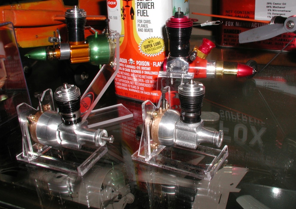

This guy is the king of the juiced up anodized Cox engines. Forgot his name something like Juenne. He has posted here before but the member list doesn't show it.
Cylinder blueing (bluing) P1010609
A couple of the engines that I have done, both rescued from the trash heap. Chucked up the stepped muffler equipped engine in the drill press and using 400 grit paper (notice the bluing in the exhaust ports) and sanded off the blue. Painted the backplates with gold Krylon. They won't see fuel. Hangar queens.
Love the contrast between the two backplates. One manhandled by a gorilla with a screwdriver, the other not.
