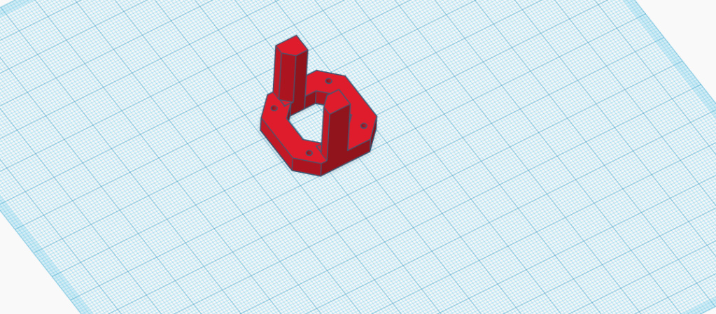

Post  NEW222 Sat Dec 12, 2020 1:02 pm
Well, I think I may have something now. A bit crude, but will hopefully work and make do. The only thing I could not figure out though is how to round the corners, so I left them square which is no big deal to either trim off, file round, or even leave them as is. Unfortunately though, I will have to wait patiently to print it so it is currently untested.....
Well, Now I've Done It..... Brilli10
Posts : 3824
Well, Now I've Done It..... Empty Re: Well, Now I've Done It.....
Post  NEW222 Sat Dec 12, 2020 1:04 pm
Picture is actually upside down. The groove in the center is the bottom for both air for the intake and extra room for the fuel tubing.

Post  Jason_WI Sat Dec 12, 2020 1:24 pm
At the side bar click basic shapes and select all under shape generators. There is meta fillet on page 12.
Size the radius you need. Align to the corner you want rounded using the align tool. Convert to hole then group to round the corners.
Well, Now I've Done It..... Round10

Post  NEW222 Sat Dec 12, 2020 2:36 pm
Well, that went pretty well. Hopefully my measurements worked out with the radiuses..... If not, I may just need to make them 1mm bigger on the top. Only time will tell. Wish I had it here so I could try the design out already. Anxiously waiting. Now to try out different things. I guess if ya screw it up, just start again!
Thank you very much for your time and help Jason.
