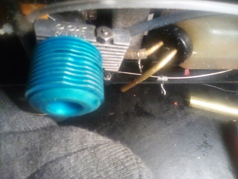

Norvel wit its inserts its posible To just use the glow plug insert wit m'y larger heatsink wil fit over the cox engine heatsink look Need help identifying this glow head 16162810
Need help identifying this glow head 16162811 its inserts wit som sort of thick shim wit the larger heatsink tink the norvel heli also fit Good wit that insert glow plug Keep this piece like gold can make engine run very Good if set correct

I prefer to adjust the cylinder height and And use just one chim wit one head gasket works Good with the car .. at least My video speak from ther self Piston should never pas tdc And lower its cylinder for compression Old Bugger most hi comprestion glow plug wil do that To so ?? Unles piston conecting rod nead bal reset ? Wil Not bent conecting rod lower its cylinder wil damage engine
