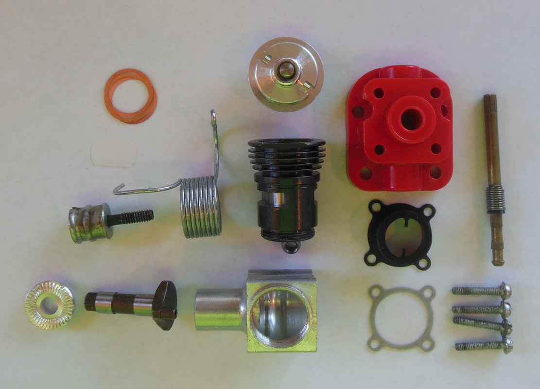

Okay.  Got everything here for my Killer Bee clone.  Looking through my stuff, I’m surprised how many old junk backplates I have that have fine needles in them.
What a friend gave me. - Page 2 DSCN7804
A little time and it all went together.  I sanded the crankcase to remove the ridges around the screwholes, and then just followed the normal assembly routine.  Yes, I did use a metal thrust washer, I just forgot it on the above photo.
What a friend gave me. - Page 2 DSCN7808
Still not sure about the cylinder.  Not knocking Bernie, I know what he’s working with, but the piston drops right out of the cylinder when the cylinder is held up.  I’ll run the engine and see how high it will peak out.  If I’m not satisfied, I’ll have to resort to pulling the piston/cylinder from a TD not currently in use and use a real #4 P/C set.

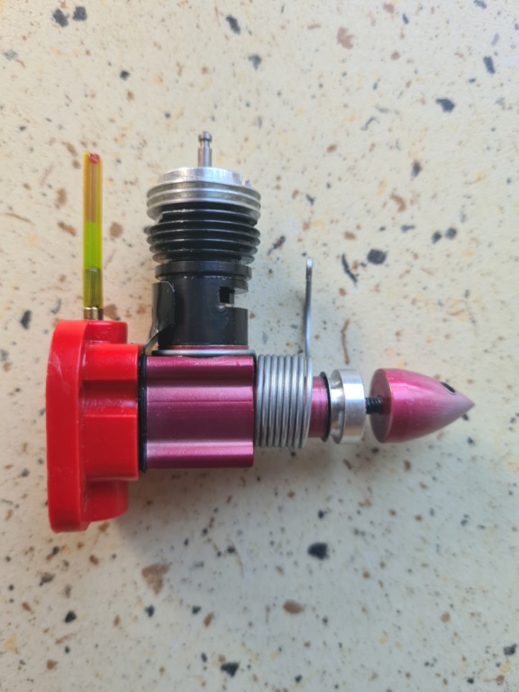

I also put together a KB clone several years ago that I named TeeDeeReedie because of the No4 cylinder I used. It takes turns with other horseshoe  backplate reedies in powering my Lil Roughneck, and is a terrific runner after many tens of ours of service. Still as new compression, balljoint only reset once.
What a friend gave me. - Page 2 20190921
Even though it has the KB crank that is known to have a loose fit in the case in general, it has a good fit and does not wobble at all in the purple anodized crankcase I bought from Bernie. The cylinder piston fit is tapered (!) despite the thick wall later production cylinder. It has 2 bypasses but only a single booster in each bypass flute. I do not recall where I bought it, maybe on feebay.
I added a DIY screen to the KB backplate- with no notable loss of power - to protect the engine..a Kamtechnik turbo head completes the tuning measures but now the engine has a Merlin clamp and plug on it.  One of my favorite reedies.
What a friend gave me. - Page 2 16227810
What a friend gave me. - Page 2 16227811

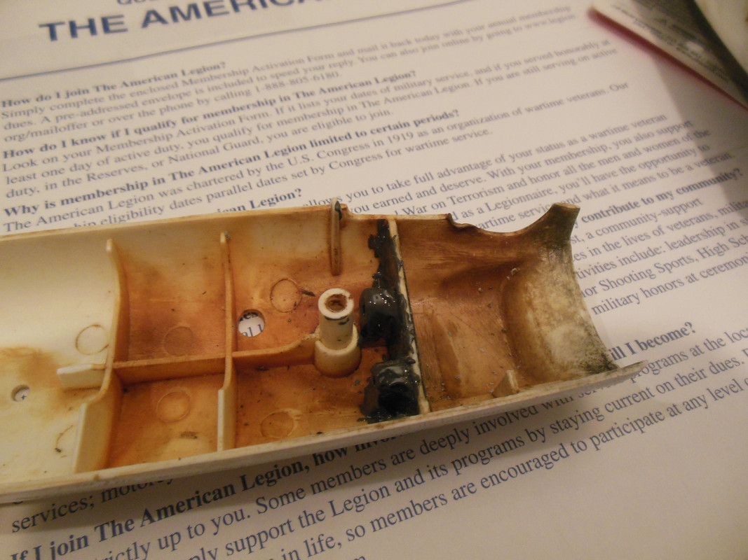

Well, as I was afraid of, the plastic is just too brittle and isn’t going to hold.  I guess I’m going to have to find some easy, ugly fix for this.  Not worth trying to be clever.
What a friend gave me. - Page 2 DSCN7811

batjac wrote:*** SIGH ***
The Phantom Mark
Oh well, the old college try Mark. Doesn't have to be pretty to work. Eager to see the final product.

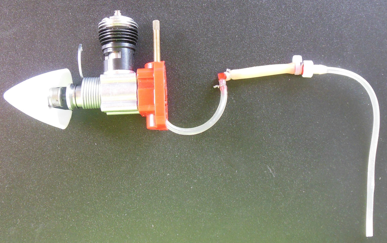

So I trimmed the tubing down to size and put a 90 degree fitting instead of the standard 180 degree fitting for the bladder.  The fuel system is now complete.  I should have enough room in the fuselage to put in an ounce of fuel.  Just ready to test run and see where the needle needs to be set and how many RPMs I get out of this thing.
The Phantom Mark
Try reinforcing that screw boss with plastic strips on the outside. Also fill the hole then drill new hole and tap.
