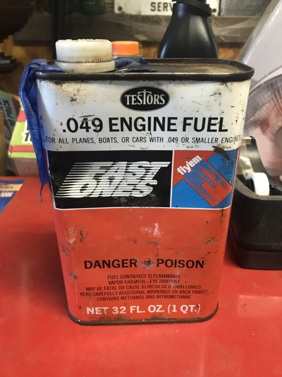

The two old cans of fuel I used is an early 1970s Cox fuel, and a ~mid-late 70s Testors "Fast Ones" .049 fuel.

Nearly 3/4 full, I found this can of fuel at a flea market a couple of years ago. The can has some internal rust, although the fuel is clear. The can has been sitting out in the garage on the work bench since I brought it home, and it has left a little ring of oil around the base with a little bit of residue around it... so it could be very slowly seeping at the seam. It is still about 3/4 full. The fuel is a shade of pink, similar in color to the Sig Champion fuel. It smells normal and you could feel the alcohol evaporate on your fingers. https://www.coxengineforum.com/t13245-testors-049-engine-fuel-can
While the engine was still running off the Sig and starting to act like it was running out, I fed it some of the Testors fuel first as that was the can I could get open. The cap on the Cox can was too tight for my oily fingers to get open. The engine bounced back to life but performance was not the same as with the Sig. I didn't readjust the needle as it ran. I let the engine run off the Testors fuel for another couple of minutes, then I started to feed it some of the old Cox Fuel. As I fed the Cox fuel, the engine started to even out and run more smoothly. Unfortunately, I didn't get all of that on camera.

After it ran out of fuel, I refueled it with the Testors fuel and started it back up. This time, I had to turn the needle almost a full turn open for the engine to run smoother.
You cannot go by any of the run-times in the videos as by the time I started the camera, the engine had been running for a while as I walked back and forth across the yard to grab the fuel can to include in the video. Each time, the engine ran until the fuel was gone.
After running a couple of tanks of the old Testors and Cox fuel, it was covered in a lot of oil. The engine was definitely tighter at TDC. Upon a closer look, the cylinder is coated with an excess of varnish and the inside of the glow head is now a dark brown.

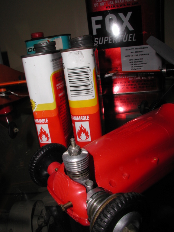

Anyone remember the first time they ran a Cox engine, or any glow engine!!!
The first glow engine that I ever ran was a Cox Space Bug Jr. bought in 1953, sounded like Jacob's with the 50 year old fuel. Maybe I'm wishing a bit as my hearing isn't what it used to be, but it brought back memories of that event. Wow, I thought the first time it caught and I leaned it out, this thing is awesome. Vivid, and I remember it to this day.
My daughter in law's grandfather gave Mark this can of Cox fuel, never been opened and the only one I have with a UPC label. Searched UPC history and found the first UPC label was on a ten pack of Wrigley's gum in 1974.
Somehow they dropped the "Super Lube" labeling.
