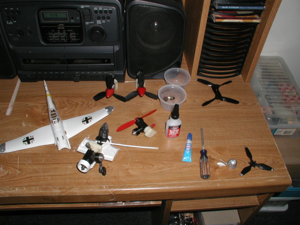

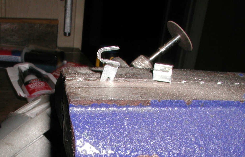

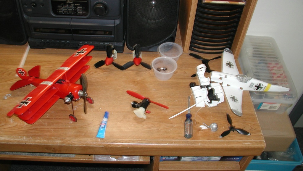

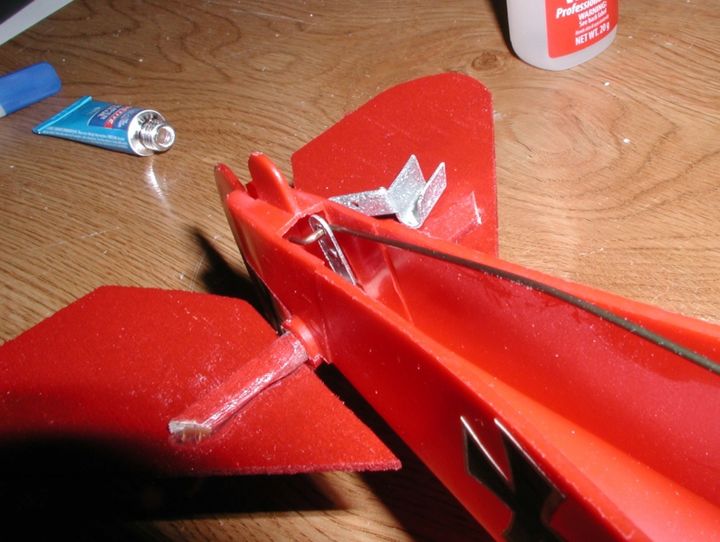

Post  rsv1cox Thu Aug 12, 2021 8:30 am
Yeah, but high class junk, hense the junque. Neither has been ran.
Flea market Cox Fokker five dollars from years ago missing the flying tail that Cox employed on this model flaunting convention. Testors Fly-em ME109 (ebay buy $?? because I did not have one) with the "pipe-bomb" .049. Really thin plastic unlike the thicker plastic used by Cox on wing and fuselage. Lot's of warp on the 109, little to none on the Cox.
I had a choice, ruin the vertical stab/rudder by cutting the tabs (they snap in and don't come out by design) or come up with my own solution. Works but no center section on the FT. Dowel rounded center, flattened sides, cut to fit CA'ed connector. Still work to do!
Plastic Cox/Testors Fly-em Junque P1011388
Plastic Cox/Testors Fly-em Junque P1011387
Plastic Cox/Testors Fly-em Junque P1011389
Pipe bomb locked up. Really locked up!!! Heat gun heat started melting the sacrifice propeller, switched to my purpose built Cox wrench. Still rotated on the drive washer. Had to put lock washers on either side of the wrench before it let loose. Yeah, I know VICE! But after years of practice I know the difference between "snug" and OMG.
Plastic Cox/Testors Fly-em Junque P1011391
Plastic Cox/Testors Fly-em Junque P1011392
Plastic Cox/Testors Fly-em Junque P1011390
Plastic Cox/Testors Fly-em Junque P1011393
Plastic Cox/Testors Fly-em Junque P1011395
Plastic Cox/Testors Fly-em Junque P1011394

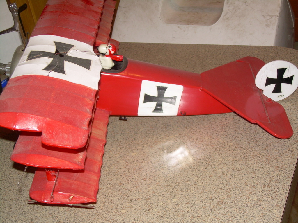

Post  Ken Cook Thu Aug 12, 2021 4:36 pm
Sorry for the thread hijack Bob. Yabby, not to take the wind out of the sails but the DR-1 landing gear is the worst design to have on a control line plane. In other words, it will almost immediately rip the gear out of the fuse on contact with grass. Control line gear tends to splay on impact so anything attached to it is going to exit immediately.
        Yes, it's a cool plane. They're extremely draggy which means it needs power. I built this Sterling DR-1. I truly believe a fart offers more power than the #2 Black Widow I have on this. A TD wouldn't be much help here either. The short nose required almost 3 oz's of lead on the inside of the cowling. It flies like a bowling ball and performs about the same. Whenever things get scaled down, they fly worse and this plane barely has survived flying. It's a shelf queen for me. I built it 37 years ago and it's flown about 6 times. I almost didn't recover it one day and called it quits before it re-kitted.
             Just a dust collector nowadays. Sun is fading the color and age has it's covering splitting thanks to the horrific Aero Gloss .
Plastic Cox/Testors Fly-em Junque Dscn2964
Plastic Cox/Testors Fly-em Junque Dscn2965
Plastic Cox/Testors Fly-em Junque Dscn2966
