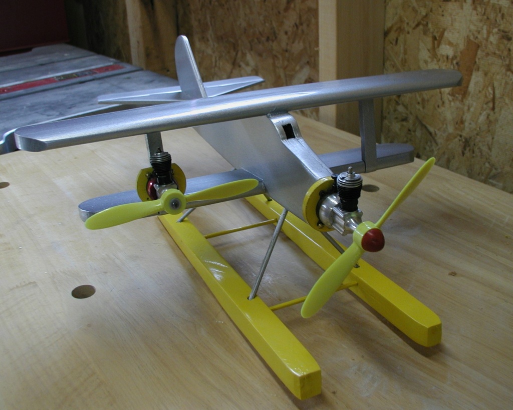

Engine day today.  The fun stuff!
The third engine is "Out for delivery".  The other two look good, clean reeds and fuel tanks.  Going to gas them up and hopefully run them this afternoon.  Got to thinking, I have no .020 spares, if a glow head is no good I will have to rob one off my Sky Copter.  Heck, I'm not even sure if I have a .020 Cox wrench.

Got the third Pee Wee in this afternoon.  Looked good.  Just a smaller version of the .049.  Funny after playing with these for fifty years + you can look at them and gauge their quality.
Of the three I thought it the most likely to run, and run well.  I wasn't disappointed.  Filled the tank with 25% Cox fuel, opened the NV about four turns, primed and flipped.  Took about three.  Running slighty rich I leaned it out to a perfect hum that lasted a couple of minutes. Never a stutter.

The other two.  Not so.  The unanodized fuel tank has little compression, and the other red anodized tank just dragged on the flip.  I was sure the crank shaft's relief was plugged with goo.
I gave up on low compression, going to replace the top end from one of my Sky Copters it's that bad.
Red anodized, I filled the tank, dropped some prime and just flipped with no attachment to the glow head.  Probably about five minutes before I could feel it loosen up.  Attached the clip and got a couple of burps off the prime, then longer burps.  Still doesn't feel right so it gets some needed reed attention.

Post  rsv1cox Wed Oct 06, 2021 7:25 am
Used the Sky Copter's top half on one engine and cleaned the reed on the other.  Didn't bench test them thinking that they will run.  Should.
Balances aft of where it should, a drilled hole in front of both pontoons and filled with .45's will fix that.

What it looks like without the cameras flash.
I build Rene's wacky Cox tri-motor pontooned tether car/airplane among other things - Page 2 P1011771
Got hubs and buttons to match coming from Bernie.  Still waiting for wheel collars to run it.
