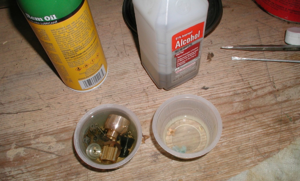

Mean-while I got the vintage Golden Bee today. Nasty greasy thing as I have shown before.
Got it all cleaned and assembled and expected a nice smooth pull-through and a compression pop. Didn't get it, just that dreaded mid-pull though drag indicating either a bent crank, bent con-rod, or out of round cylinder.
I knew it wasn't the crank, and didn't expect a bent con rod. Then I remembered, when I was putting it back together i noticed this dimple right between the exhaust ports. Going to swap our cylinders tomorrow to know for sure.
Oh, - Cylinder - 2 bypass no booster. No Made in USA on backplate. High compression head. Thin Wall.
Clean, but still not pretty.
