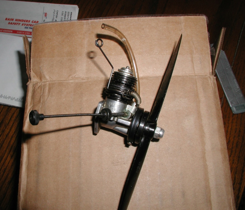

I have never run one of these that I can recall. Unusual that the piston, throttle, or starter, was not locked-up so I thought I would give it a try. Wrong needle and severely bent, but I have others and selected the best.

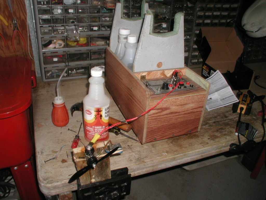

Cleaned out the fuel tank and added fresh seven-year-old Cox 25%, primed the intake, flipped the prop a couple of times, added fire and using the starter let it go. Started first try running weakly. Reached for the NV and got knuckle smacked, these things still sting. Died.
Turned the needle out a turn and using the roto starter, got smacked again by the starter but it was running rich. Carefully turned the needle in a half-turn and ran the throttle between idle and full which was not very much.
Hot off the mail truck - Running a Throttled Wen Mac VII P1012710
Hot off the mail truck - Running a Throttled Wen Mac VII P1012711
Good first try, got to play with the fuel tanks position and try a different fuel. It will go on one of my P-26's.
