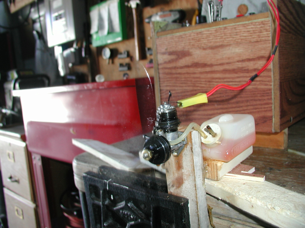

I can't recall ever running one of these.  Cox 25%, Wen Mac 6/3 prop.  Recomended 1 1/2 turns on the needle.  Cox clip works well.
Easy start using Wen Macs starter.  Throttle arm set close to idle.  Running really rich, castor bubbling.  Leaned it out twice before I could get a good throttle response.  Idle all day in the single digits, but could only get about 5700 rpm out of it max.  Old fuel, I mean really old fuel and I never got it really leaned out.  Rinky dink fuel tank set-up hot glued on.
First picture is after I shut it down, pinched tubing with long nosed, used a lot of fuel.

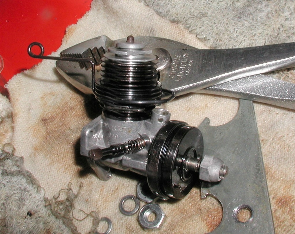

Totally locked up engine.  Berryman's/soapy/clean water dip.  Heat, would not loosen.  Starter not the engine.  Usually I can free it by rocking back and forth.  Not so this time, after about 15 minutes I gave up and got out the pliers.  Big no-no for me but..........securely clamped on the outer ring, twisted counter-clockwise it popped free, and no tool marks.  Fine now.

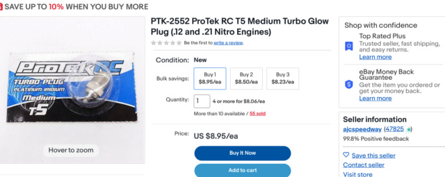

I've tried the "Kamtechnik"glo head adaptor for use with "turbo plugs", They work great and gave me about 200 more RPM compared to the standard 7810 testors head. The OEM testors heads are getting difficult to find and buy.
https://www.ebay.com/itm/165357735595 or direct from Greg: https://kamtechnik.com/product-category/testors-mccoy/
The big benefit is you can select the turbo plug that best suits your needs..hot to cold.
