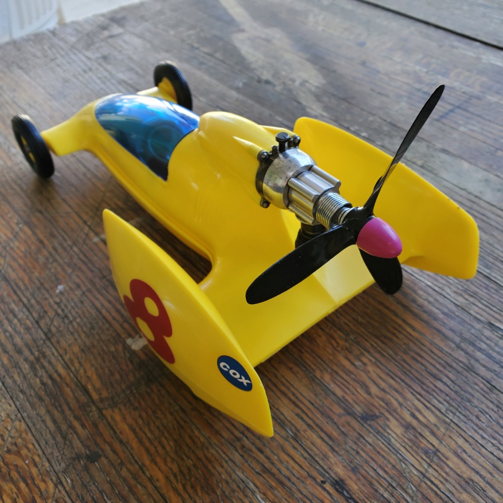

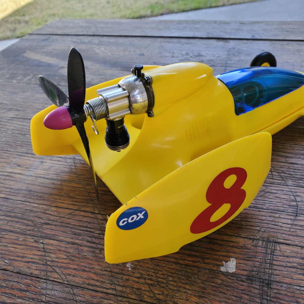

Version 0ne:
Yellow No 5 1968
Type 1 Body: First shown as Box-art in 1968 Cox Product Catalogue.
Red No 5 decals on rear wheel spats with oval Cox decals on the upper rear of the wheel spats.
Canopy dark blue.
No Roll Bar slots or cross reinforcing in rear wheel spats.
Shrike Cockpit
Steel axles with horseshoe shaped clips for wheel retention. Yellow wheel hubs, front hubs chrome finish which Is not all that resistant to glow fuel.
Rounded profile ribbed front tyres and square profile block-tread rear tyres.
Engine: Cox .049 Baby Bee with three bladed non safety tip pusher prop with pink rubber spinner
Version Two:
Yellow No 8: 1969?
Same Box Art as previous year.
Type 1A Body: No Roll Bar slots in body but now with cross reinforcing in rear wheel spats.
Red No 8 decals on rear wheel spats with oval Cox decals now inside faint raised ovals on the upper rear of the wheel spats. Otherwise the same as previous year.

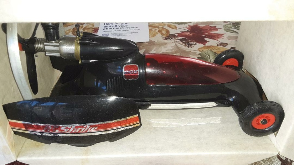

Version Seven:
Black R/C 1981
R/C Shrike: (pictured in 1981 catalogue)
Type 2 Body: Colour Black. New body mould now with profile driver, internal changes for housing R/C gear, including hole in belly pan recess for on/off switch and tapered hammerhead accommodating steerable front wheels operated by a single channel Sanwa/Cox Unit.
Alloy Roll Bar. Silver/chrome and red strip decal with RC Shrike wording on rear wheel spats with Cox Silver/chrome and Red squared decals on either side of body behind canopy. Silver/chrome trim decal along each side on the belly pan

Hello guys,
I'm new to this site. I picked up a few days ago this Sealed Cox mail order box. The only printing on the box was the Cox address and the number 9602. After opening the box I found a black car but, was not the RC version. I thought all black shrikes where the RC version. Look at the pictures and let me know what you think. Could it have been build at the end of the production run? Using what parts they had left over? I have searches the web a few times and can't find anything on a non RC black shrike. Does this make it more valuable or rare?
Anthony
Anthony

The slit exhaust cylinder and snap starter show it must be a late production Shrike. The square COX decal with rounded corners is also one of the last COX insignia I guess. I am not familiar with the value of Shrikes but this does not seem to be an old stock, that is probably priced higher than late models.

Hi Anthony.
IMHO that Shrike would definitely have left the factory in 1981/82 as an R/C Shrike. If you look at the rear between the body and the rear wheels spats there will be a small hole which was for the aerial. Also, underneath the car in the square recess there will be a slot with on off moulded in the plastic.
The real give away for me is the front axle and wheels. The R/C version is quite different and very fragile to frontal impact. Someone has replaced it with a standard Shrike one to continue to use the car as a normal shrike. If you dismantle the body, you’ll probably find one or both of the axle mounting spigots broken or missing.
Dave
Dave

Ok let’s backtrack a bit here. Cox part numbers for Shrikes were 9100 and 9200 up till 1996 when Cox sold to Estes.
In Estes 1997 catalogue the Red non R/C Shrike is now listed as CO9100 and CO9161 with mini starting kit. In fact all previous Cox products have CO shown in front of the original Cox product number. Neither Shrike option listed by Estes from 1998 onward.
On the box end pictured above it shows 9206 and underneath what looks like 3000-CO74. The CO in the part number is possibly a clue. Is this an Estes reference number and is yours and others like it, hybrids made up from leftover stock by Estes.
Didn’t Estes do something like that with Cox engines? Do we have any members here who used to work for Estes.
I might need to get one for my collection of Shrikes
