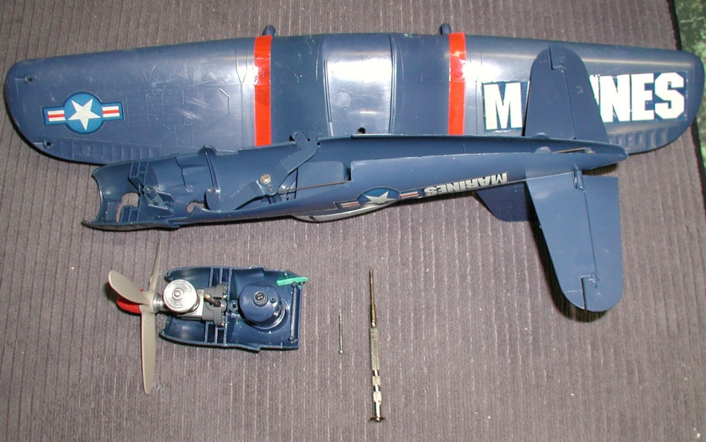

Pretty good condition, I only had to construct a false canopy.  Ran it some time ago but did not fly it.  Flew the other one.
Gummy castor slung engine and fuselage.  A single screw holds the engine module on.  I like it.  Makes maintenance easy.  And the fuel line nipples are substantial and do not break unlike the break prone Wens.  That screw will only accept a #1 jewelers Phillips screwdriver.

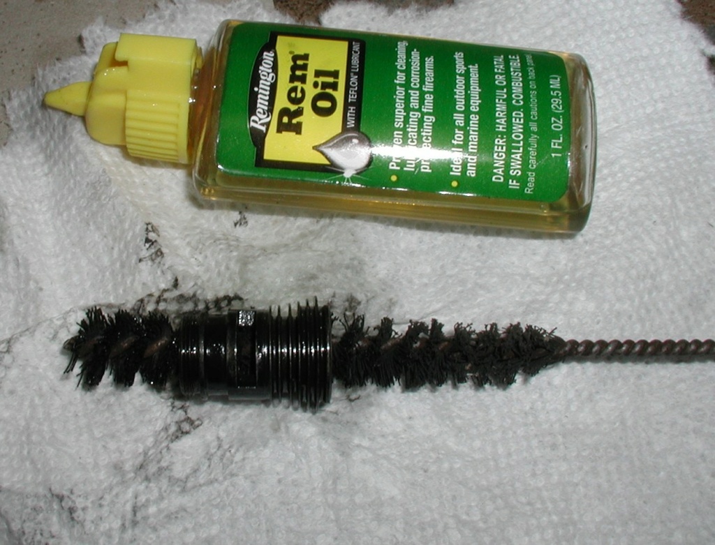

Refinished the brown #3 cylinder.  Did not have to reset the connecting rod, nice tight fit.  Chose not to remove the reed but cleaned it in place. Same for the crank shaft.

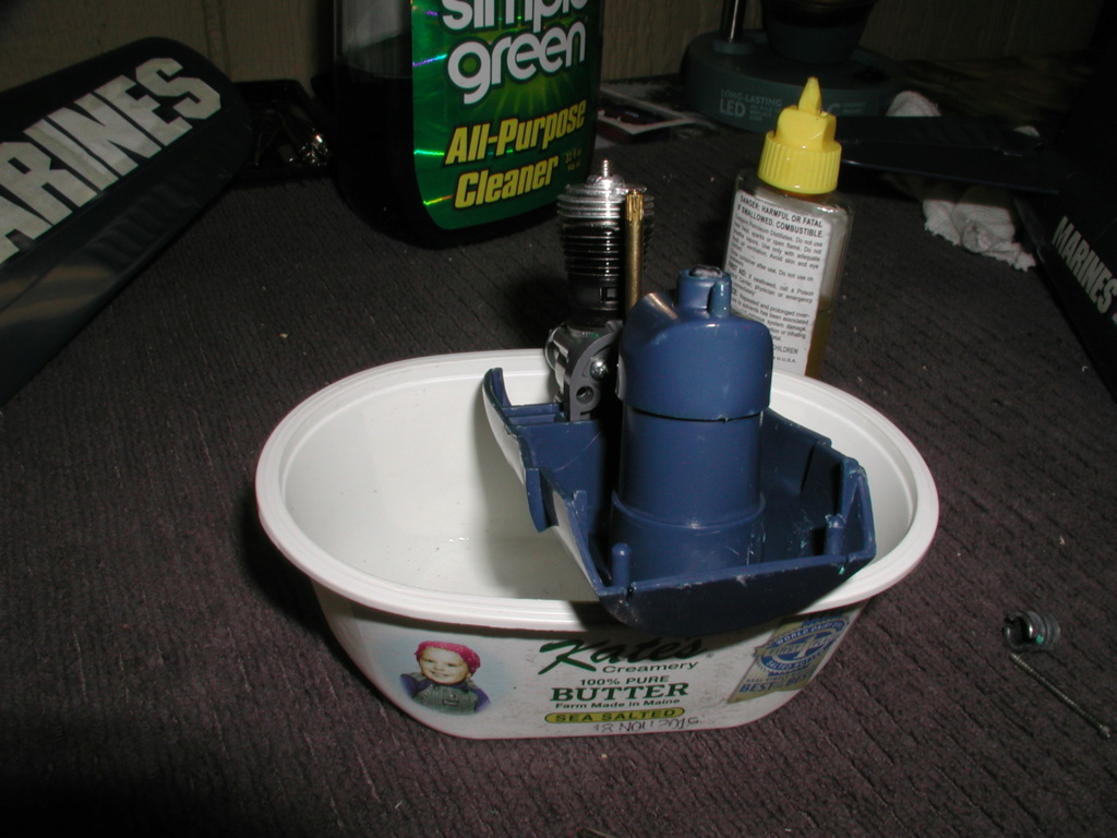

On the fuel tank.  Simple Green works well to clean it.  Hold it under until bubbles stop.  Let it sit for an hour or so.  Shake it, then shake the rest out.  Hold it under warm water until bubbles stop, shake it out and do it again until water runs clean.  Then blow it out dry with low volume compressed air.  Low volume you can blow the plastic tanks apart.  Ask me how I know. Sad
