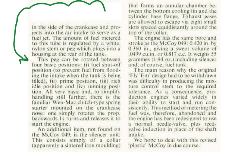

OK...so here's Peter Chinn's review of the "first" version pf the 8000 Testors 049:
http://sceptreflight.com/Model%20Engine%20Tests/Testors%208000%20%28first%20version%29.html
here's the position lever description:

I discover that I can pull the lever.
And I can remove it too
Easy to push on.
Easy to push on.

I have two Zero's, both have that POS needle valve. It really is two positions, horrible and worse. Talk about reinventing the wheel. There was nothing incorrect or troublesome with the standard Testors needle. For the life of me, I can't see how if expense was a issue they would use this.
