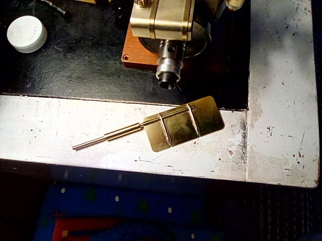

I made my own flywheel drive schaft and coper tube wit nylon bushing inside I made threads in the driveschaft to screw in the flywheel seems better than with a flexible cable but I think it will vibrate Huh...

WOW Daved your all over the place building boats // how will you start the one you show as speed boat ? Looks very close to get a starter rubber around the flywheel . I hope it works for you with this much work into it Very Happy

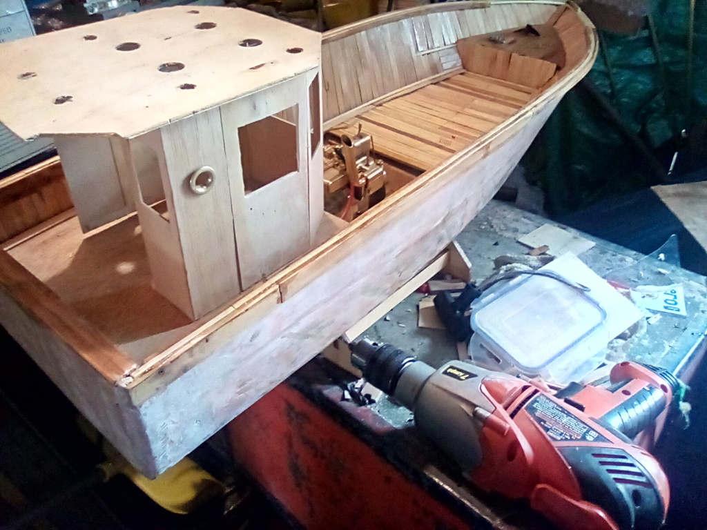

Post  davidll1984 Mon Jul 04, 2022 10:39 am
It's going well and looks more and more like a fishing trawler or a tow boat or a crab fishing boat I don't know but it's coolBuilding a gas powered windmill and now a boat  Img_2364
Building a gas powered windmill and now a boat  Img_2365
There are still a lot of details to do and I had a small problem that I lost a lot of time figuring out what the problem was. The radio receiver worked perfectly but as soon as I started the engine the servos went crazy moving in all directions no matter what even with all the electronics and servos outside the boat several feet away the engine was causing interference I ended up finding thanks to a flying lama who had made a short video explaining the same problem with a very simple solution it was The spark plug cap Inside its just a piece of wire I made a small modification and now everything works look the vidéo explain how i fix this 4th of July Flag Fireworks cheers
