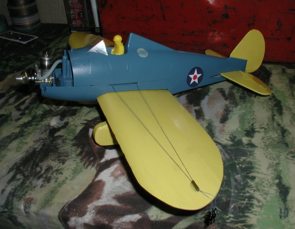

Post  rsv1cox Wed Jul 20, 2022 7:44 am
M&C, joining balsa and plastic together you're going to have a few.
I started this months ago as a time filler, not a serious project but it turned out rather well with proper balance and a weight reduction.  Compromise, I had to run the elevator control rod outside the fuselage, not contained inside like the original.  Also I had to drill out the engine holes a bit to accept #4 screws as the mounting holes in the body were stripped.  No engine cowl either, had plans but too complicated.
A beginning.  Bought a bunch of parts.

Lost over 2 oz in weight.

rsv1cox wrote:M&C, joining balsa and plastic together you're going to have a few.
I started this months ago as a time filler, not a serious project but it turned out rather well with proper balance and a weight reduction. Compromise, I had to run the elevator control rod outside the fuselage, not contained inside like the original.  Also I had to drill out the engine holes a bit to accept #4 screws as the mounting holes in the body were stripped.  No engine cowl either, had plans but too complicated. [...]
Mistakes and compromises - My Wen Mac 60% balsa 40% plastic P-26 Peashooter P1013603
[...] Lost over 2 oz in weight.
Mistakes and compromises - My Wen Mac 60% balsa 40% plastic P-26 Peashooter P1013610
Wow! What a transformation, from its hideous form to its well being! It's alive, Bob, it's alive! Very Happy

Balances about 3/4" back from the leading edge.  That box of parts benefited or completed three other Peashooters, mostly cowls.
Wing on the far right plane is half balsa.  The balsa wing on the hybrid was made by wetting and forming over a real plastic P-26 wing securing with about a dozen rubber bands and left to dry for several days, multiple coats of sanding sealer helps it retain it's shape.

Starting decals.  I built this with the thought of flying, now I have so much time in it I'm having second thoughts.  But...............

That box of parts yielded three P-26's.
The top fuselage on the left is the one used on this aircraft. I had cut it back all the way to the firewall, decided I went to far grafted it back on and just cut off the mangled part. The half wing at the top got a grafted on piece of balsa and made up another one.

Bob, I know you don't have to do anything. I was referring to your balsa / plastic hybrid model:
Mistakes and compromises - My Wen Mac 60% balsa 40% plastic P-26 Peashooter 2022-049
I was just suggesting something very simplified without the radial engine restored in the nose, like what Walt Musciano would have done. But, you already did a huge amount to restore it.
Actually, to duplicate the fat fuselage of the P-26 is amazing what some modelers did. I looked at Outerzone at some of the CL examples between 21" to 23". They planked, then sealed before doping, giving an authentic looking model, more than I'd ever want to entertain to do. (I prefer fairly simple builds. The most complex I ever did was Carl Goldberg's half-A RC Skylane 42. It was beautiful when I completed, but involved more building than I most of the time was willing to do.
Hence, I stuck to simpler sport models.

Out of nine, my only complete unfueled/unflown one George.  Those inproperly placed stars and bars decals peeled right off.
Mistakes and compromises - My Wen Mac 60% balsa 40% plastic P-26 Peashooter P1013616
I haven't given up on doing a cowl.  I have a history of coming back to these after a while.  I really like this paint, plastic wears it well and the color fits most Navy aircraft of the era.  I removed the original Wen Mac prop and replaced it with one that a PO painted, nylon, probably wouldn't run it but it matches the model better.  More lipstick.  Smile

Yes, I look on these small aluminum drink cans with a curious eye thinking how I could use them for cowlings.
Mistakes and compromises - My Wen Mac 60% balsa 40% plastic P-26 Peashooter P1013622
Problem is they would work well on balsa models but plastic models have a lot of detail molded in that could not easily be replicated.  But, thinking I may give it a try.
I'm not having any luck doing something similiar.
Mistakes and compromises - My Wen Mac 60% balsa 40% plastic P-26 Peashooter P1013623
Mistakes and compromises - My Wen Mac 60% balsa 40% plastic P-26 Peashooter P1013624
Mistakes and compromises - My Wen Mac 60% balsa 40% plastic P-26 Peashooter P1013625
What suprised me with the Peashooter is the over two ounce weight reduction.  Considering the 1/4" hunk of balsa required to ensure horz stab stability and the platform for the lower fuselage plus the added paint it's pretty significant.
Anyone want a Peashooter?, this isn't a bad deal considering the throttled engine.  Wierd fuel line that I don't understand.  He would take $125.00.  Been there with him.  Buy it so I don't.  Sort of like Jacob posting ads for engines that he has too many of that are for sale on ebay.  Smile
