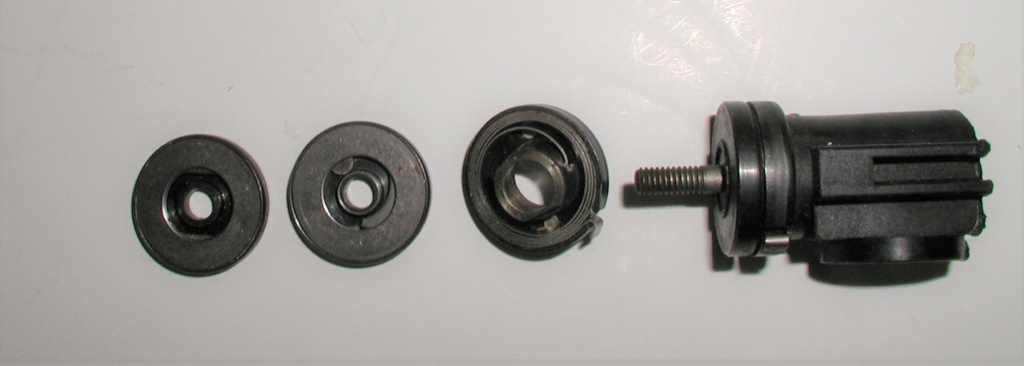

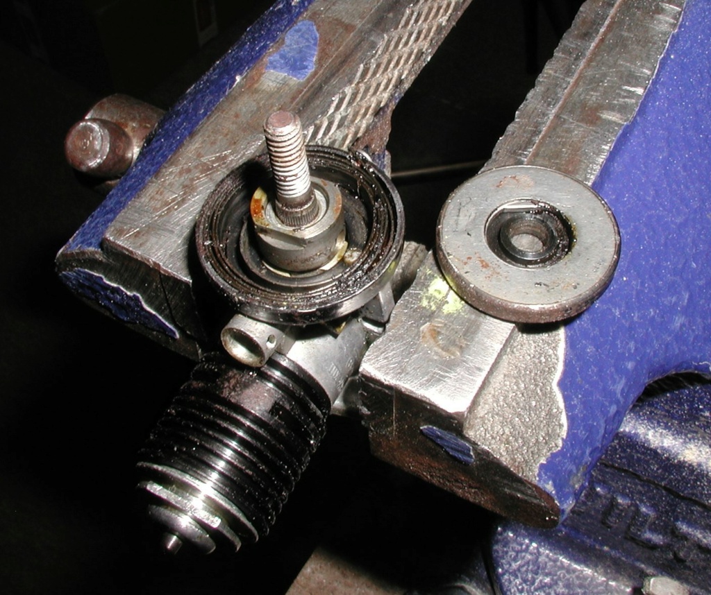

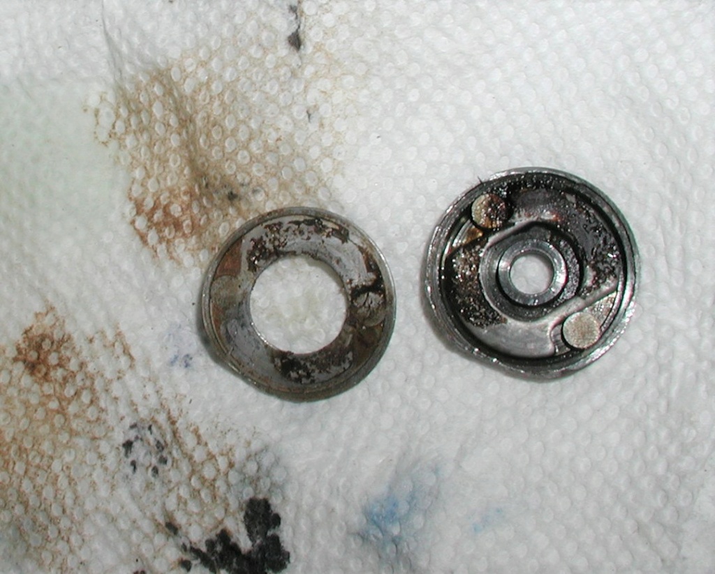

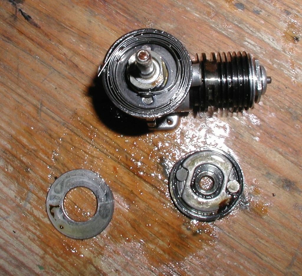

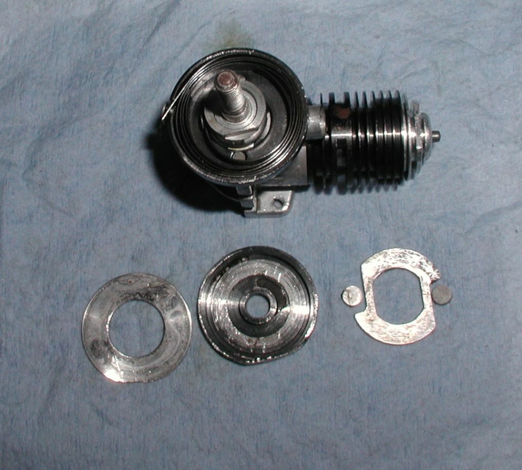

But the starter, forget it. your not going to "fix" it.  The inner part is sealed, crimped around the edges.  If you attempt to disassemble it your going to ruin it.  Better a long soak in Berrymans. The only way to avoid castor buildup in these starters is to flush them out after every run with Remoil then flip until your fingers hurt then blow out with compressed air.  Unfortunately nobody ever did that back then so we are stuck with a bunch of gooed up starters.
For the curious.  It's a mess in there.
A Wen-Mac  SNJ-3 Navy ;Update and need some more help P1013920
A Wen-Mac  SNJ-3 Navy ;Update and need some more help P1013921
A Wen-Mac  SNJ-3 Navy ;Update and need some more help P1013922
A Wen-Mac  SNJ-3 Navy ;Update and need some more help P1013923
A Wen-Mac  SNJ-3 Navy ;Update and need some more help P1013924
A Wen-Mac  SNJ-3 Navy ;Update and need some more help P1013926
A Wen-Mac  SNJ-3 Navy ;Update and need some more help P1013927
A Wen-Mac  SNJ-3 Navy ;Update and need some more help P1013925
If your engine/starter is stuck. Soak it in Berrymans or do an anti freeze boil. attach a metal propeller and heat, rock gently back and forth. Hopefully it will free up. If not, use Remoil around the starter interface and engines ports. Rock some more, Berrymans, heat, Remoil your only answer plus a lot of careful labor.

Post  rsv1cox Wed Aug 24, 2022 9:12 am
latole wrote:Thank's for the very good hints.
Engine is stuck. Is it the starter or the piston/ cylinder or both ? I'll have to check
Berrymans; this one ?
A Wen-Mac  SNJ-3 Navy ;Update and need some more help Captur88
No, this one.
A Wen-Mac  SNJ-3 Navy ;Update and need some more help P1013928
Apply heat with a heat gun, carefully rock back and forth, apply Remoil or any light oil to the engines ports and slot between the starter, more heat, more rocking. It will loosen up.
