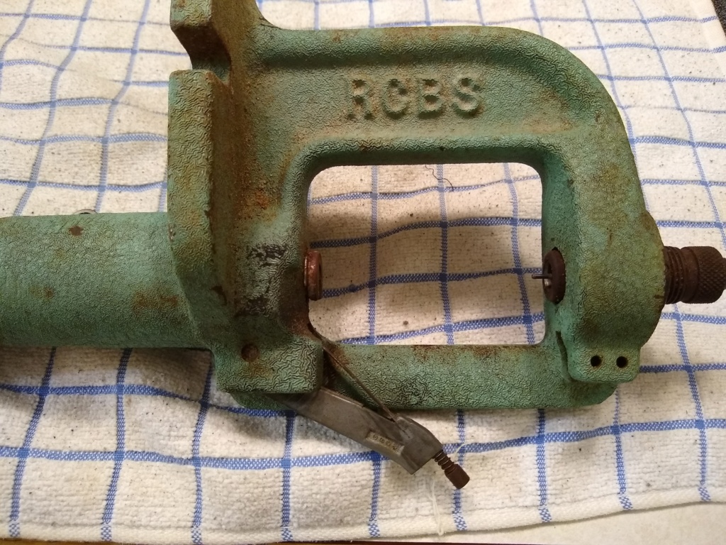

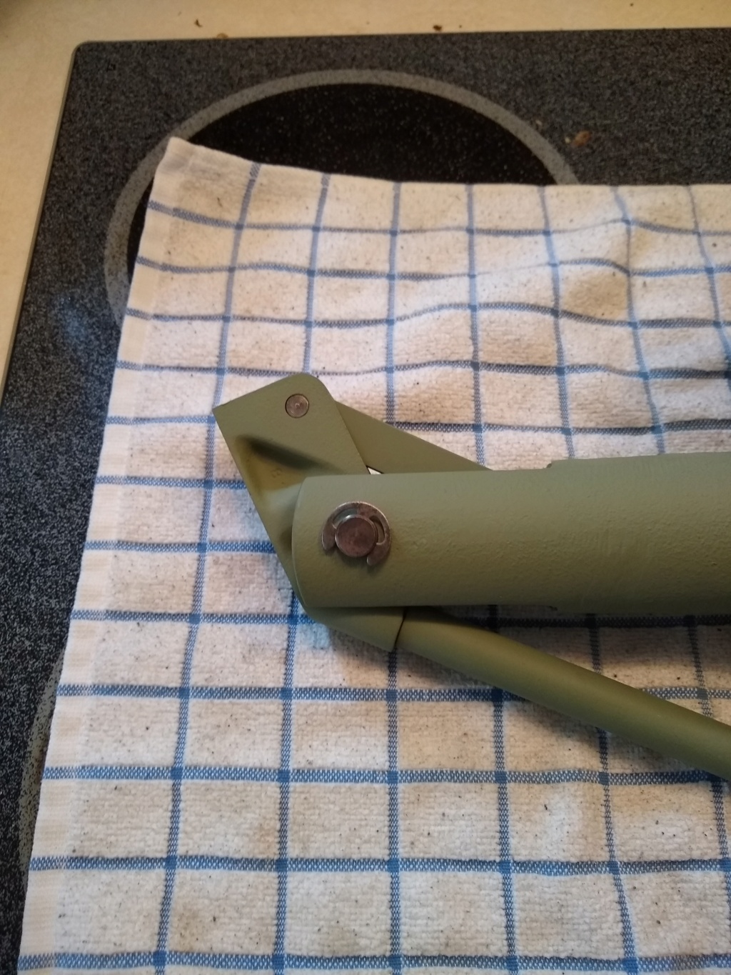

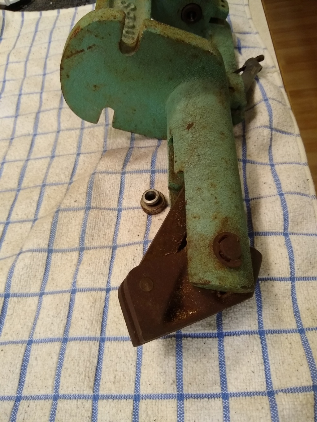

Bob (rsv1cox) is my hero when it comes to bringing the dead (engines, that is) back to life -- his work is stellar and I certainly fail to meet his standards. However, a friend brought a reloading press and powder measure by the other day and asked if I could do anything with them. Here is a quick picture essay, without comments, of the before and after.
RCBS Reloading Press Restore:
RCBS Uniflow Powder Measure Restore -- this was tightly locked up:

LooksGreat to me! Did you use anything special other than fine steel wool and elbow grease? They both look like new.

Marleysky wrote:........Did you use anything special other than fine steel wool and elbow grease? They both look like new.
Quite sometime ago, I built an electrolysis tank for rust removal -- it's particularly good for removing rust from complex parts and from pitted metal. After disassembly, the press frame and large parts got a good cooking. Then, like Bob, it was steel wool, toothbrushes, brass brushes, fine sandpaper, and a fine wire wheel on a mandrel. The electrolysis took the press down to white metal; the powder measure body was just well cleaned. I reblued what was needed, repainted the press and reassembled.

GallopingGhostler wrote:.......Worked like a charm, but would never try on aluminum or magnesium, too strong and reactive. It also etches the steel, so one can overdo it......
The electrolysis will remove paint, but is pretty gentle on steel. However, you do need to keep an eye on it.
