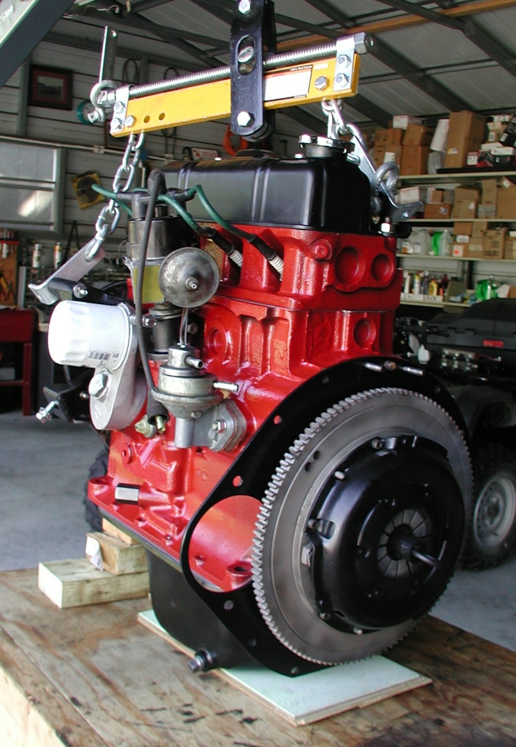

Anything is repairable, the question is - is it worth it.
Witness my 1977 MG Midget. I paid $250 for it. Rust bucket. When finished (not bad) I sold it for what I had in it , about $2200. But my labor - down the drain. Hundreds of hours of it. No matter to me, I loved doing it, but to others...........
Krylon rattle can paint job. Same dry rotted tires that were on it when I bought it. plus, plus...... It was one of those - see if I can things.
