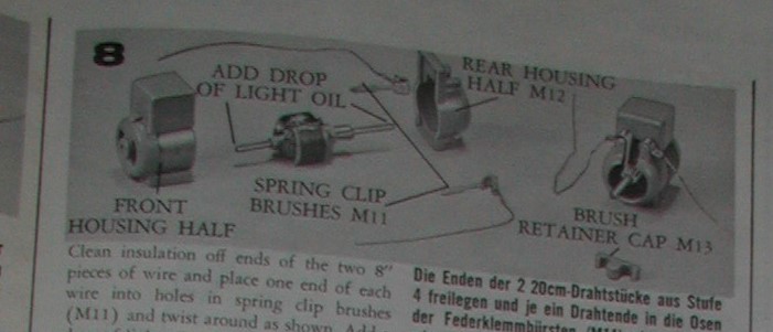

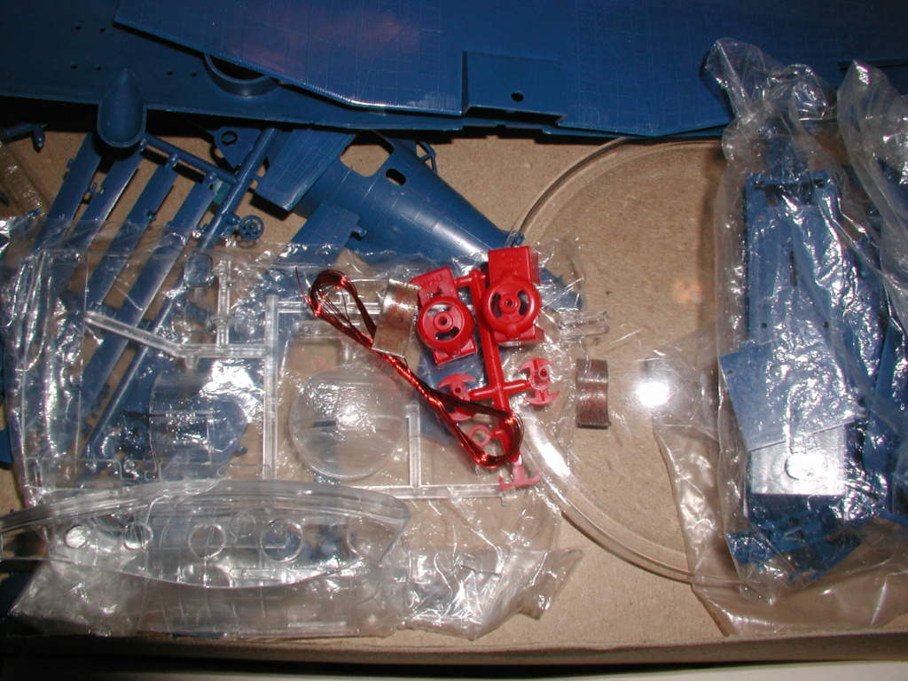

Lindberg Avenger motorized.  I remember building one of these small do-it-yourself motors as a kid.  Nerviously checking the parts I found three armature laminations missing, recovered the shipping box and found the eighth, still two missing.  Still trying to figure those canopies/turrets.  Kit's are cheap, eaiser that looking for those things alone.  Must have been a kid putting it together.  I don't understand the speckled paint, but he did a great job on detailing the crewmen.

Neat old motor kit with the Avenger Bob….I hope you find the missing laminates….. A little later tech but I’ve assembled motor kits for airplane use…. Interesting process…

Unless you insist on exact original there is no problem with making those 2 rotor laminations from plastic sheet.
This will keep the rotor dimentions as designed at the expence of a little performance loss.
If you change out the old ferrite magnet with a modern "rare earth" version you stlll end up with a motor much stronger then original.
You could then also change the copper wire to a thinner version and wind more turns on the rotor.
This will reduce the rpm and increase torque for a more scale look while running.
Also if you have thin bronze tube that fit snug around the axle then using that as a bearing will improve the lifespan of the motor.
