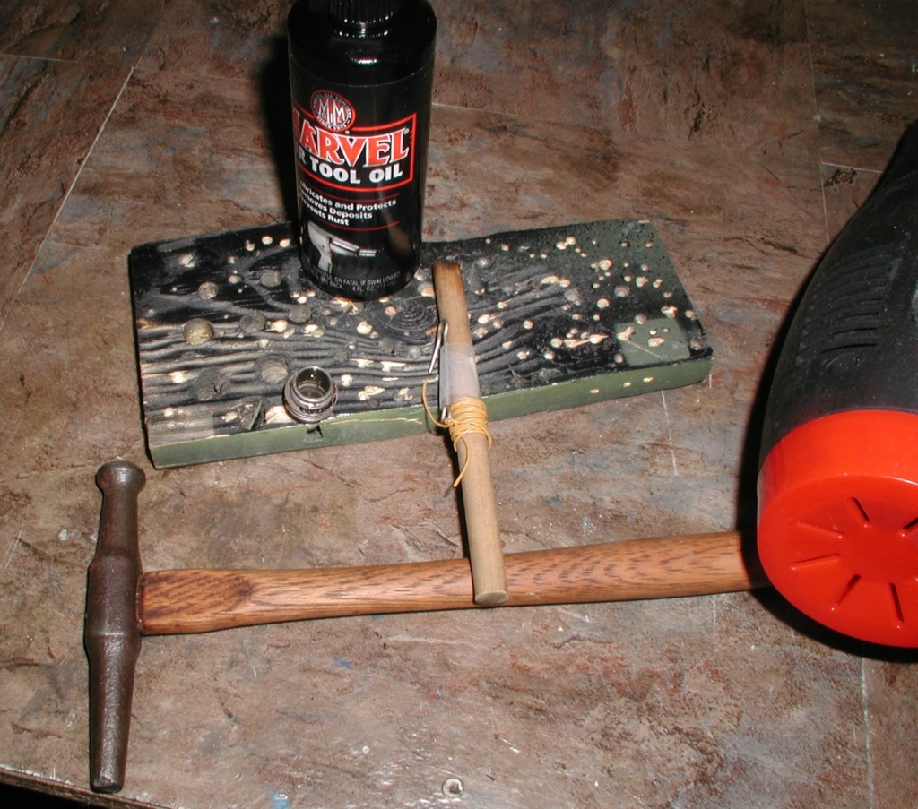

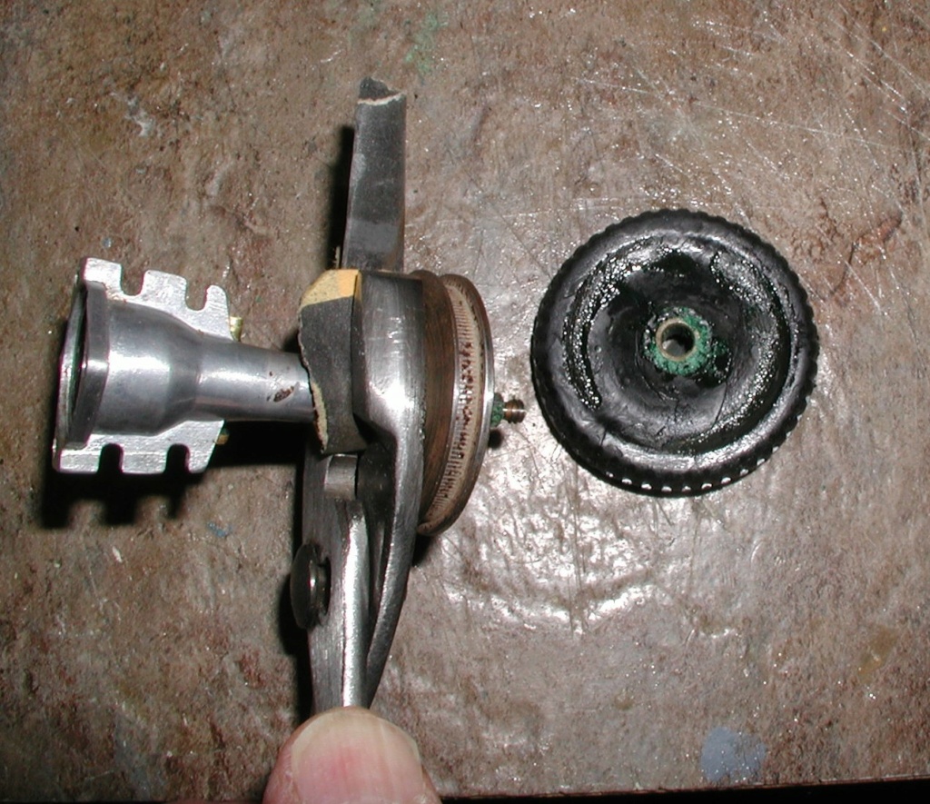

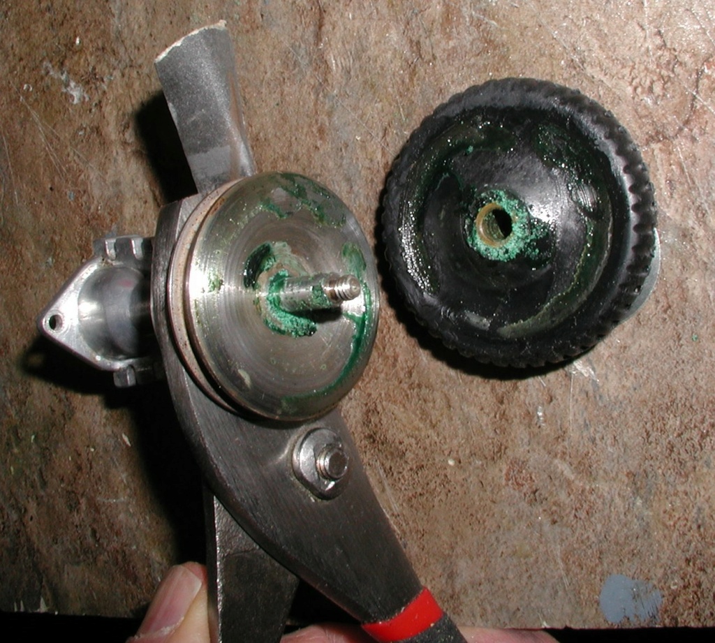

After removing the engine, heating it a bit and a drop of light oil in the ports I tried to turn the wheel.  Groaned to a slow turn it suddenly stopped.  Hard stop.  Turned it in the other direction, another hard stop.  Know that, been there.  Broken or disconnected connecting rod.
Disassembled it and yes, the collar had come off the piston.  Perhaps by someone (PO) tried turning the wheel against the top fused piston dragging the collar off.  A combination of tubing and a brass drift reattached it.  Chances of staying put. Don't know, but it did not go back on easy.
