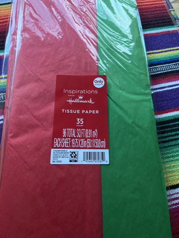

Tissue - I cannot for the life of me remember WHICH forum had discussions last year about tissue, but I will risk it here.
Inspirations, Hallmark, SPECIFICALLY for Walgreens at Christmas - I have NO idea why this special batch seems to have nicer grain than any other Hallmark tissue, but it does.
Pre-shrinks on a frame super easy, on model super easy, and looks pretty good.
if you are heavy handed with the mist? the red will spot and run a bit.
has a really nice grain, and its cheap. PLUS? its on SALE at half price now.
I just picked up 2 bags of red and green, 35 sheets, $2.50, It also comes in white, 90 sheets, $2.50.
the walgreens by my house has 3 shelves full of it. I probably have more than I can ever use, but I will stop by in a few weeks and see if they have dropped to 75% off.
If you build, if you need tissue, if you live near a Walgreens, if you are cheap like me? - - I recommend stopping by and checking it out.

I wouldn't use it for covering. It works well for already covered models. I cover with silkspan or polyspan followed with the Hallmark domestic tissue for trim. I like the glue stick method and then apply the trim brushing it down with rubbing alcohol to activate the glue stick. I prefer Jap tissue but it's harder to locate. One real problem with this tissue is that it fades very quickly in the sun. If you use it, cover your model with a towel.

Those cheaper tissues use the cheapest dyes, which are not sunlight stable. For wrapping presents, use as a covering in decorator bags holding gifts, making temporary flowers, they work great.

and i prefer the white to the red/green dyed

However, if you are cheap, and you need tissue to cover a model - and you don't like "plastic planes"
this stuff is cheap, works, has grain, and holds dope well.

I tried testing on a couple of projects to prolong my supply of Esaki and dope….And just to experiment…..The red and blue is Hallmark tissue…. The yellow is dollar store special …. Both were applied with white glue and water….. Then coated with Helmsman spar varnish which is UV resistant…. And seems to withstand fuel well too….The red/blue hasn’t seen a lot of daylight but the yellow has and is holding up OK….The varnish will darken a bit over time but doesn’t bug me too much….
