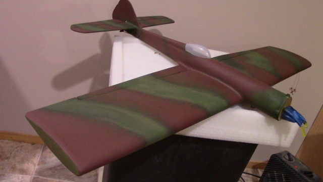

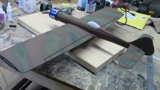

Finally....
covered with SIG medium silkspan ..SIG nitrate dope
some flaws in the tissue job were addressed with the help of Minwax stainable wood putty, my index finger, more dope and numerous slits made with the #11 blade to make the loose tissue submit to my will...especially in the concave areas.
The OD Green and brown are Tamiya Acrylic....lacquer...?
I know you are all in awe of how artistically the camo motif was executed..it's a gift I guess.... H^^
I don't know how wise it was to do this .....but instead of using Tamiya thinner at $500 / gallon I used 91% Isopropyl alcohol as a thinner
I have Brodak Butyrate Clear on order along with "flat" butyrate dope thinner
Rumanian IAR 80 Fighter decals are available in 1/72 scale.
I might try my hand at making my own 6 TIMES LARGER insignias to dope onto the plane before I hit it with fuel proof dope....
but
What would be the best material to make a DIY DECAL out of..then maybe apply with dope to the top side of the wing panels...?
I plan on many bumps and bruises for this plane while I try to learn to fly a recognizable pattern and DO plan on building another IAR 80 once I get a chance to wring this one out.PAW .049 CONTROL LINE MODEL - Page 3 Rumani24

PAW .049 CONTROL LINE MODEL - Page 3 Empty Re: PAW .049 CONTROL LINE MODEL
Post  getback Thu Mar 23, 2023 6:51 am
The plane looks good ! Are you omitting the wing tips ?
Posts : 9426
Post  TD ABUSER Thu Mar 23, 2023 10:40 am
getback wrote: Are you omitting the wing tips ?
Thanks..!
..no round wingtips until I find the best leadout position.
If there proves to be ample power to do all the stunts..then I'll add rounded wing tips and this way I wont need to make the leadouts adjustable when a more "educated" version of the plane is built.

Post  TD ABUSER Thu Mar 23, 2023 10:29 pm
At this point it needs a coat of fuel proof dope...a couple insignias, a better looking cowl and a better looking canopy.
I should try to find a beer can that looks more "Army Issue" .
There is actually a malt liquor called "CAMO"....
a now defunct brand called "SCHMIDT" had a "limited release" camoflague design on their cans IIRC .
The plane weighs 10.5 ounces, more like 11 ozs with a coat of fuel proofer and a few pennies for wingtip weight.
I have no idea what 13,000 and a 6.3 x 4 prop can deliver..I want to be able to fly the Stunt Pattern from a swiveling Lazyboy recliner with a drink in my free hand..
PAW .049 CONTROL LINE MODEL - Page 3 Rumani25
PAW .049 CONTROL LINE MODEL - Page 3 Rumani26
