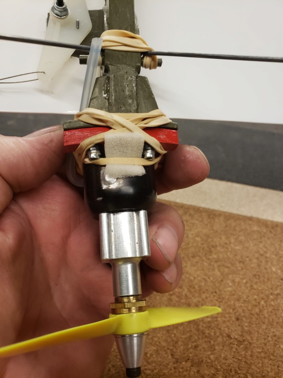

Well one of the fields that we are gonna go fly at has a dirt ball diamond..and I do think too much also..New build for the girls 16767610
New build for the girls 16767611
So I took a 1/8" thick piece of chainsaw airfilter and loosely covered the air inlet..Will see if it likes running with it..
Then after welding up the tank overflow on the bottom, the new aluminum backplate had a vent next to the needle..kids filling tank with syringe creates fountain when full..so I made a overflow tube setup. The original overflow worried me that a on hard landing it would be getting bent and clogged with dirt..overthink is a way of life.

Post  rsv1cox Sat Feb 18, 2023 4:35 pm
I like it.
You and Yabby are builders in kind with your breakaway engine mounts.
Good job - Bob
Posts : 8990
New build for the girls Empty Re: New build for the girls
Post  Yabby Sat Feb 18, 2023 5:47 pm
Looks really good. Turned out very nice. I must say though, my breakaway rubber band engine mounts havent done much breaking away as everything around them seems to break instead. lol! Bu they make engine on and off easy and changing engines between planes. Nice to see someone else giving them a try also.! Thumbs Up

Post  Michpatriot Sat Feb 18, 2023 6:30 pm
Thanks fellas..but there was just one last thing nagging me..what if the..well now its ready!New build for the girls 16767710

Post  MauricioB Sat Feb 18, 2023 7:35 pm
your airplane looks beautiful, you have thought of many details, great!
The rubbers that hold the engine, if there are many turns, are stronger than the screws themselves. the rubbers that you use there, wet them with castor oil and put the tension in such a way that they act as a fuse, otherwise they will be more rigid than the screws.
Remember that it is important that it acts as a shock absorber and not as a tensioner!
