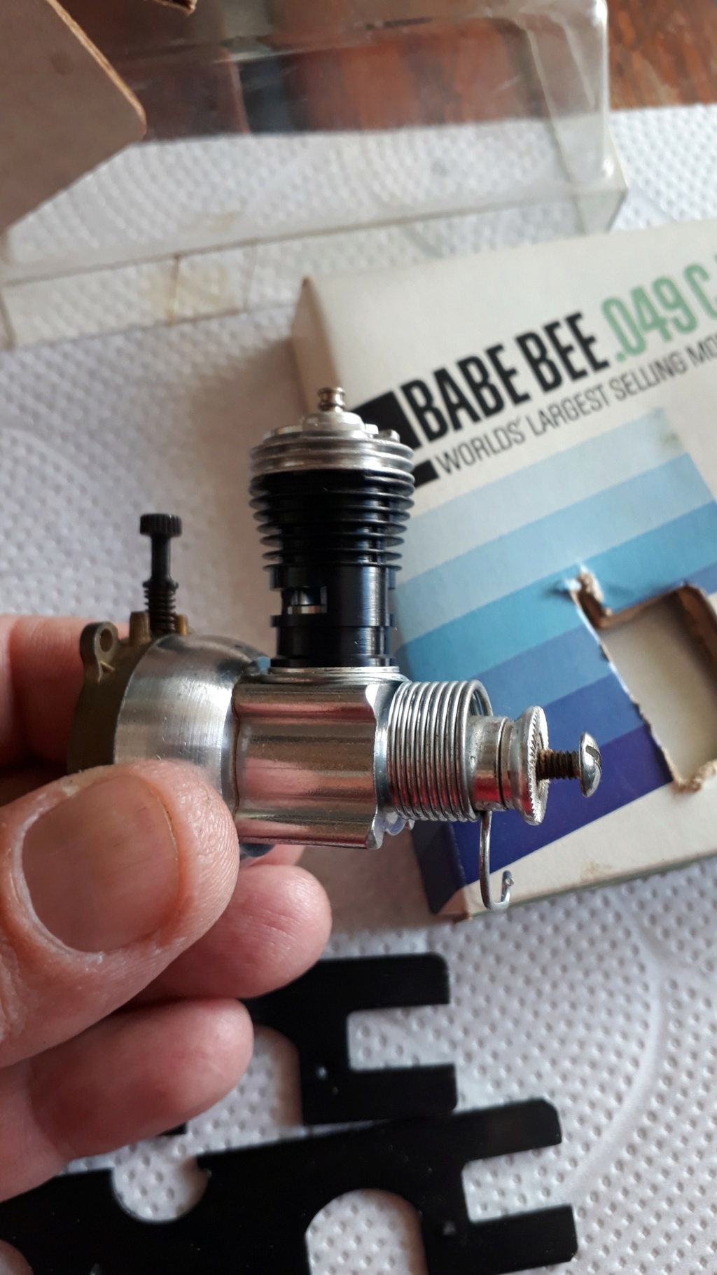

Well, it's about another Cox Babe Bee .049 engine, which popped up online. I liked this engine for the year of manufacture, for its box and for its cylinder, it is the number 2 of a single transfer.
Upon receiving the engine, I noticed that it was really new without use, they had tried to remove the glow plug, but without success, since I noticed a small mark on it, then, I took a Cox tool and trying to remove it, the cylinder seized. It came along with the glow plug.

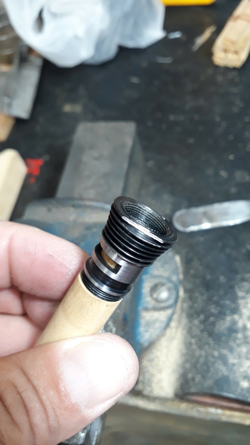

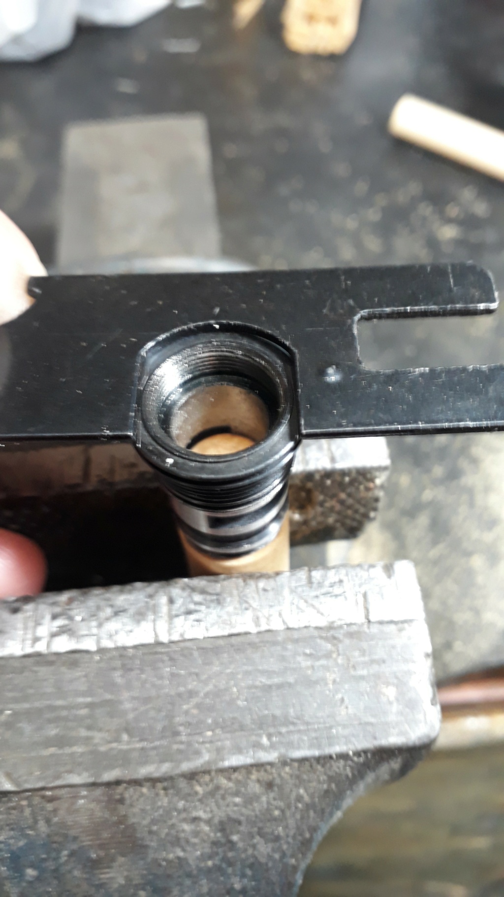

For this reason, I decided to do a process on the integral cylinder:
1)Anchor for the Cox key that allows it to be held securely.
2) Grinding of the outer wall of the cylinder, to place an acceleration ring in the future and that works perfectly without play.
3) Touch up the glow plug itself with the lathe to remove that old mark from its previous owner.
4) bluing of the cylinder to return to its original color.
5) Armed and put in its box waiting for a project or it will remain there as a collector's item.
Here are the photos!

Tu obra en ese motor es perfecto, calidad alta definitivamente Your work on that engine is perfect, definitely high quality.
- Posts : 4076
Re: New Acquisition..
Mauricio. You have done an excellent job of refurbishing that engine. Please share with us the method that you have used for re-blueing the cylinder.
Rod.
Rod.
- Posts : 3770
Excellent job on the cylinder redo for throttle ring and removal slots , that looks like a process i have not used and came out very Nice ! .... A project ? will bee interesting because the BB doesn't have a lot of power and knowing you fly RC only .
Posts : 9418
I always love to see your beautiful, precision work Mauricio ….
The Bee is a classic and will be in good hands under your ownership….. Is there some special reason the #2 cylinder appealed to you?….. I like them too, Not all have to be most powerful possible ….
Roberto
Roberto

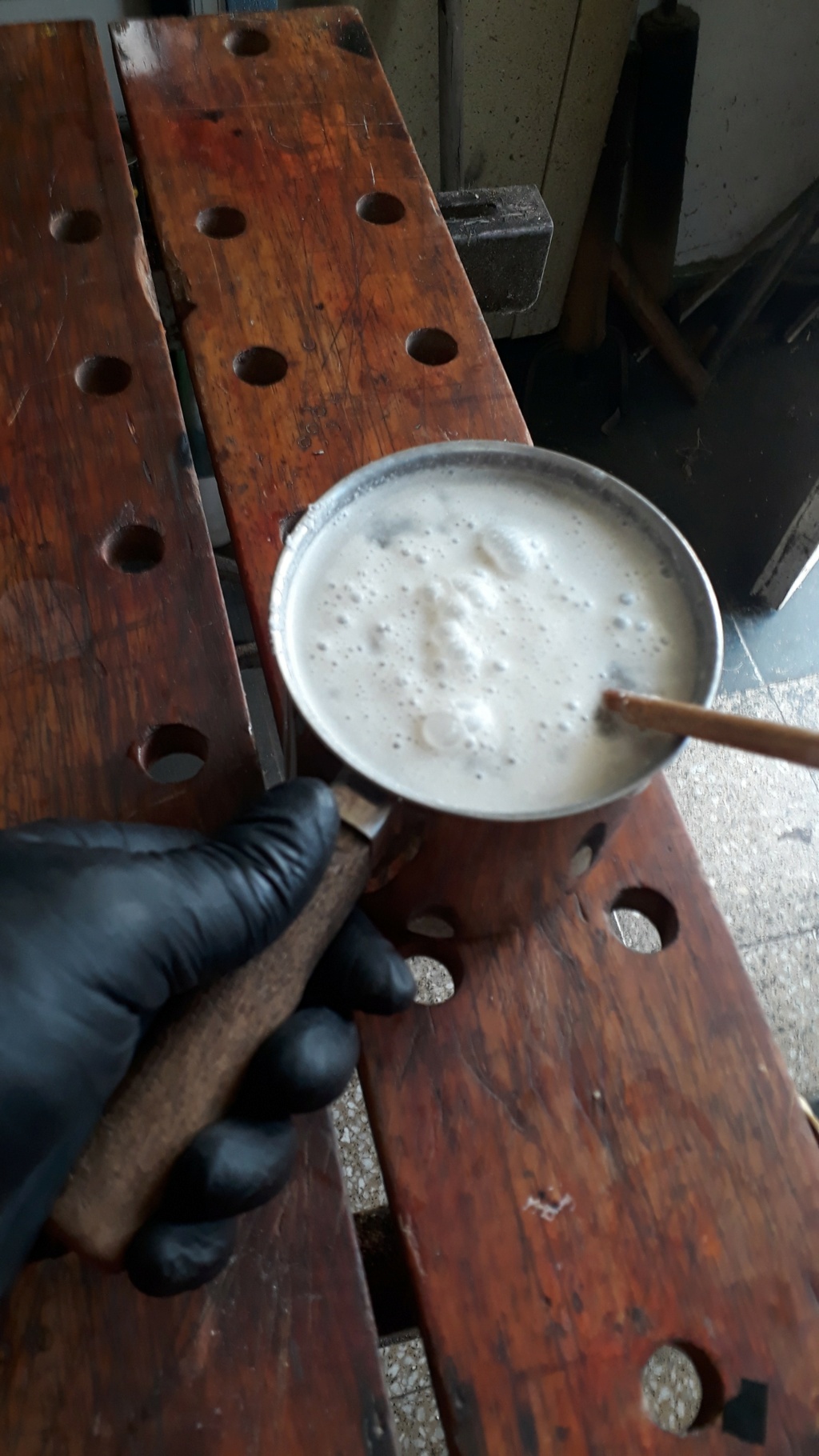

bluing
Items:
Stainless steel container.
Metal container (metal does not matter)
clean common water
Potassium nitrate
Caustic soda
medical alcohol
Heater
Tweezers
Wooden rod
Safety equipment:
Gloves and goggles
Procedure:
In the stainless steel container place:
6 parts of water
6 parts caustic soda
1 ½ part of potassium nitrate.
With a wooden rod and protecting your eyes with goggles, and your hands with gloves, stir the content until you get a good mix, (you will notice that the caustic soda and potassium nitrate remain at the bottom of the container.
Place the container in a heater and wait for the mixture to boil, stir the mixture in the meantime.
With the mixture boiling, place the piece to buff previously degreased with alcohol, with a holder (it can be a piece of wire).
While the piece is submerged in the mixture, at intervals, stir the mixture itself on the sides with the wooden stick.
Leave the piece for about 30 minutes in the boiling mixture.
Lift the wire or hanger that holds the piece to bluing with a pair of pliers and contemplate the colouring. If the color is not the desired one, submerge it again for another 30 minutes.
Remove the submerged part and remove the mixture from the heater.
Place common water in another metal container and place that container in the heater, place the piece with the hanger in common water and leave it there for about 20 minutes with boiling water.
Remove the piece with pliers and contemplate the coloring. The process should be finished.
If the color is still not as desired, repeat the entire procedure.
After the process, clean everything with common water.

That is a different stroke for bluing and works well , I don't understand how the process can turn the bare metal to a blue/black ? There are some dangerous ingredients in the formula that you don't want to breath , But i am sure you already know this .... Very nice flight ( I remember see you build this now and that you had used the BB for power ).

I also like the magic recipe and ingredients of the bluing process... I am a bit lazy and prefer the simple gun-blue fluids, sold by gun shops, and apply the bluing fluid on the de-greased cylinder external surface with the help of a cotton ear bud.
The bluing fluid should possibly avoid contacting the cylinder internal surface. Even if the blackened spots on the cylinder inside wall will disappear after a few engine runs, the fluid itself is changing the metallurgy of the cylinder internal wall in a thin layer, that, being as accurately fit as it is, you want to avoid.

András, does the bluing chemical treatment weaken the steel surfaces? If so, are we talking a few molecules thick, or, considerably more? Perhaps etches away enough to compromise longevity and fit?balogh wrote:The bluing fluid should possibly avoid contacting the cylinder internal surface. Even if the blackened spots on the cylinder inside wall will disappear after a few engine runs, the fluid itself is changing the metallurgy of the cylinder internal wall in a thin layer, that, being as accurately fit as it is, you want to avoid.
- Posts : 4076
George, yes, the bluing may make the top layer of the cylinder surface brittle and wear off..I am not sure how deep the material transformation is, but would think that with the small dimensions of these engines any unwanted material loss is better to be avoided to save compression..

Thanks Eric!...of course, I've been doing this for a few years. You must do the process outdoors...you don't want to end up becoming something strange hahaha

About the way to strut I have to tell you the following:
The process generates a thickening of the surface, for this reason if you do not want to thicken the interior of the cylinder, placing a wooden stick as seen in the procedure, the cylinder will remain intact inside. Now in my experience with some old and heavily used cylinders you can put the cylinder in without the wooden stick inside, just a piece of wire to hold it, the bluing process will thicken the inside surface and then after the process of bluing, you must make a readjustment or seating of the cylinder and piston.
To do that, the technique I use is the same as the video I did where I start with a Norvel .061 engine, that is, you use a heat gun, and a starter, with the addition of mineral oil.
Through this procedure, I have recovered some engine by improving its compression. It is important for recovered cylinders that this process has been done to use castor oil, not synthetic, that helps a recovered cylinder even more.
