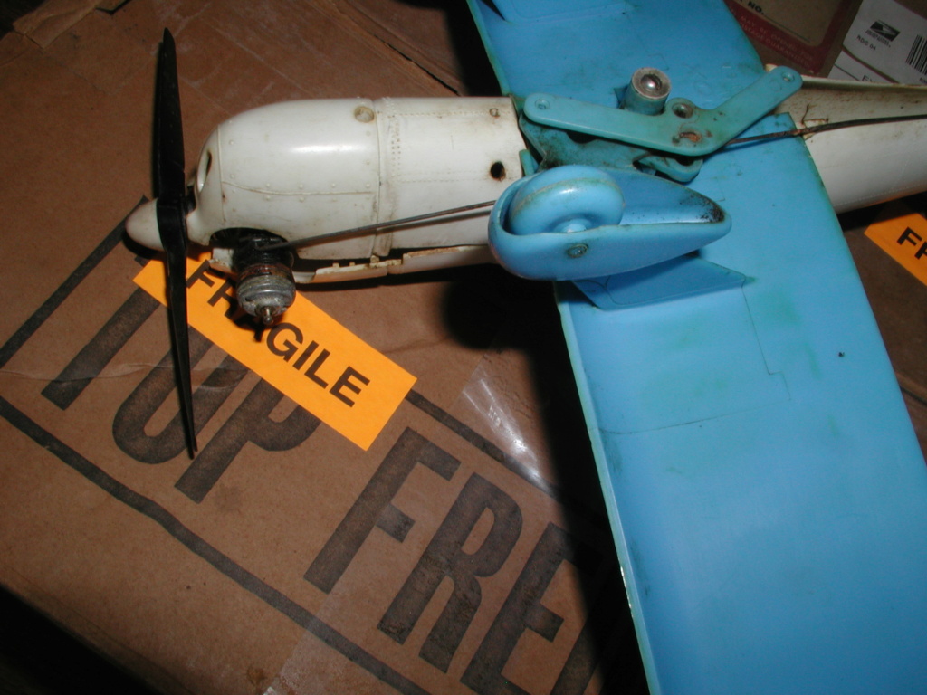

Opened up the flaps on the box and found this:
Throttled Cox Ryan ST arrives with a Comet connection.   P1015380
Throttled Cox Ryan ST arrives with a Comet connection.   P1015379
Throttled Cox Ryan ST arrives with a Comet connection.   P1015378
Box has been around since before zip codes.

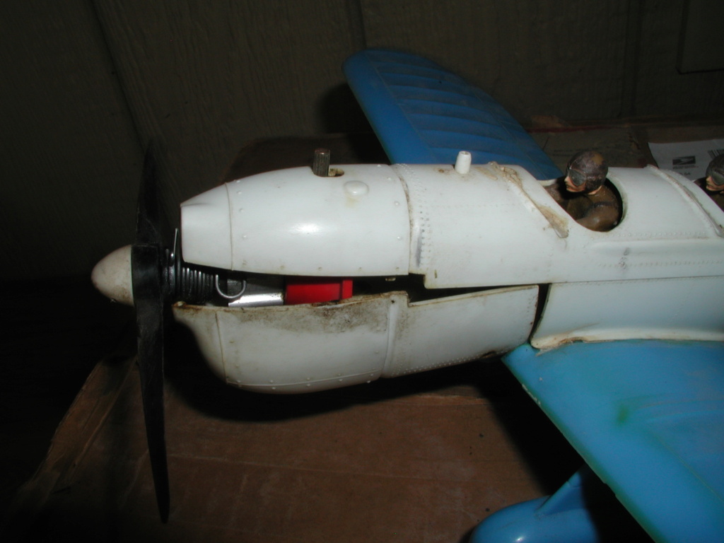

Ryan is a little crispy missing one fuel filler/vent nipple, probably broken engine cowl mount peg and windshields. Rust or goo on the cylinder but the head appears to be high compression. No wrinkles on this one. Pilot guys still have most of face etc. coloring. No Berrymans dip, just very very light dish detergent.

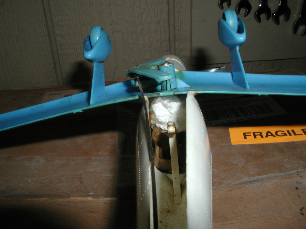

The wing doesn't seem to be held on with anything, but there is something strange stuffed up in there. Paper towelish.

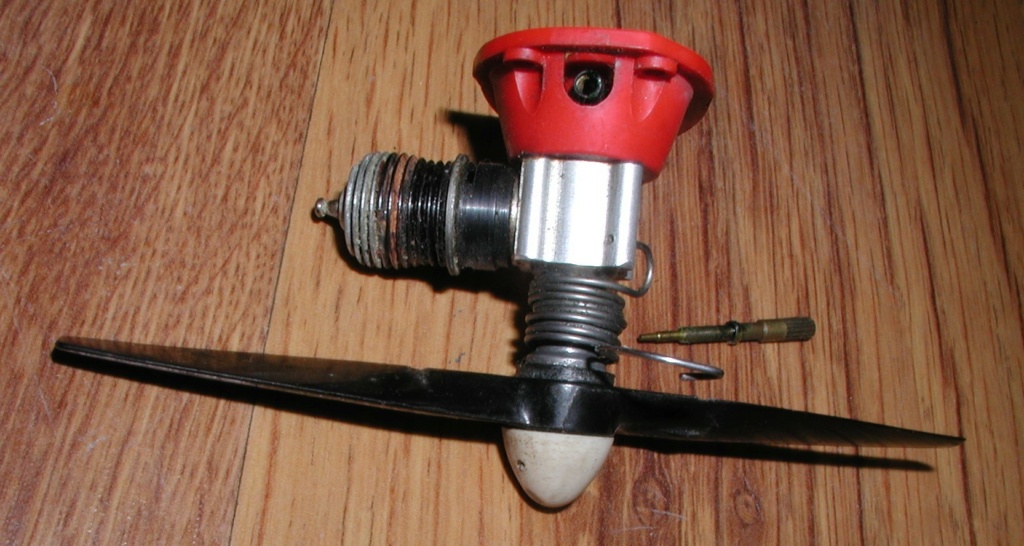

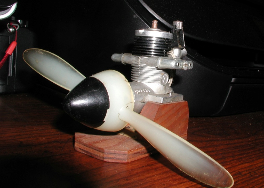

Thanks Robert, cute but that throttle ring is giving me grief.
Everything was castor locked.  I don't know how the ring guys do it.  They must clean that ring after every flying day or count on fuel and heat from running to loosen it up on the next one.  It took a lot of heat (heat gun) to get it to rotate but then only with maximum effort.  Subsiquent applications of heat, Simple Green, Carburator cleaner, soapy hot water, and Marvel Mystery oil did little to improve.  So I tried to remove it.  Got out my VACO snap ring pliers to spread the keeper and I could not get it off.  I know when I'm beat!  So, if ya can't beat them join them.  Left it dragging, I don't think the bell-crank actuated arm is going to move it.  Perhaps after it 's warmed up.
Check out that hole in the case.  Dual purpose. Throttle ring and starter snap ring.
Throttled Cox Ryan ST arrives with a Comet connection.   P1015390
Throttled Cox Ryan ST arrives with a Comet connection.   P1015392
Throttled Cox Ryan ST arrives with a Comet connection.   P1015391

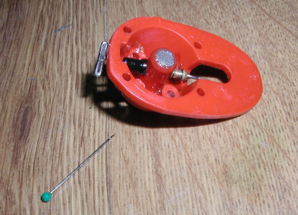

Usually I can only get a common pin through the NVA to clean out the goo, but on this .020 I could get the larger T pin through too.  On most .049's you can't.

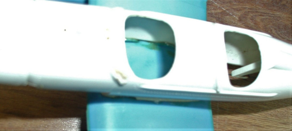

Cox fixed up the little guys with instrument panels.  More attention to detail with the Ryan than the PT-19.  Flight suits have castor goo, but they don't care.  They are held in by a peg and a hole - press fit for ease of assembly.  Paper towel stuffed in there was to hold them up.  I drilled out the hole a bit to fit over the peg and red tubed them in.
Windshield next.

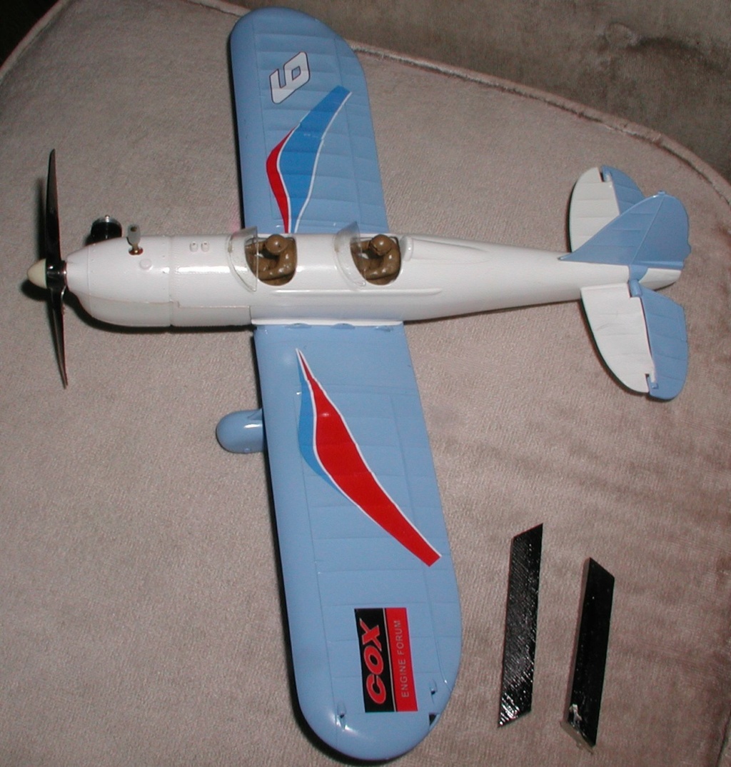

And Robert, yes a little at a time.  Still needs windshields and a tail wheel like I did on the other one but I had to put it together just to see if I was making any headway.  Smile
With Joe's gifted Camel which started the whole thing.  The Camel is no poor sister.  Very well done by Testors.

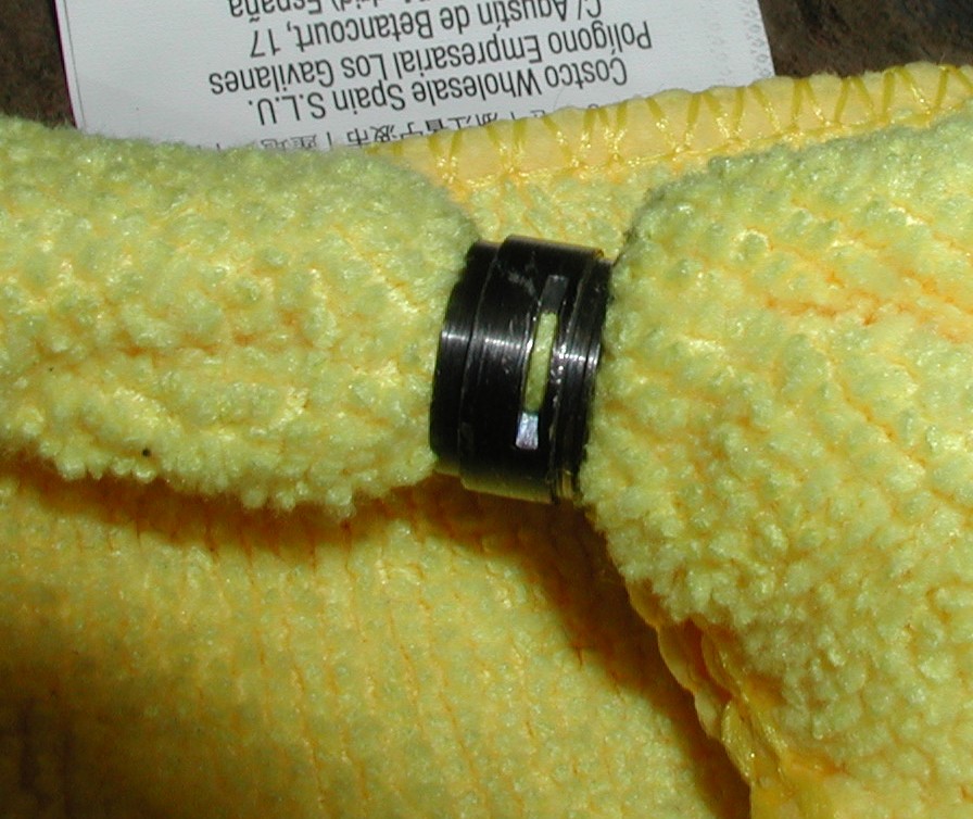

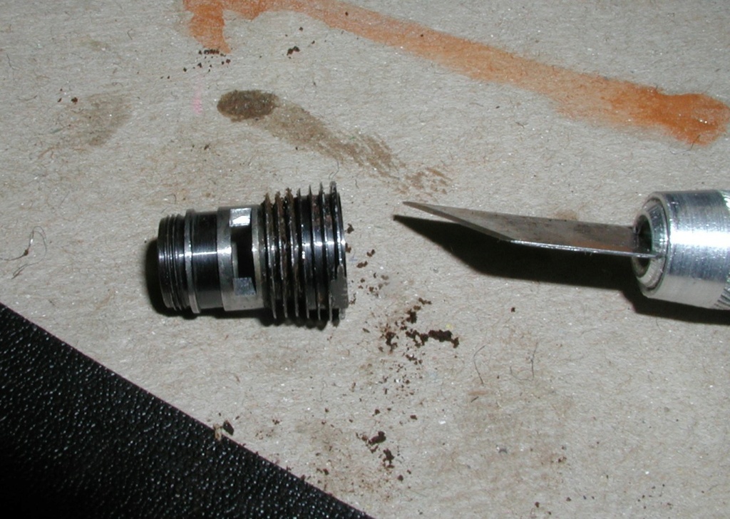

No more Mr. Nice guy, that sticky throttle sleeve is coming off.
One last try, heat and still to sticky to move.  Ring would not come off.  Brutal.  Don't care.  Burned fingers gave way to pliers.  Don't care if it scratches, but it didn't.
Throttled Cox Ryan ST arrives with a Comet connection.   P1015421
Throttled Cox Ryan ST arrives with a Comet connection.   P1015422
Throttled Cox Ryan ST arrives with a Comet connection.   P1015423
Alcohol bath, fine steel wool, backside of an exacto got the embedded burned castor out of the fins,  more toothbrush.  Oxypo gun blue fixed the existing scratches.
Throttled Cox Ryan ST arrives with a Comet connection.   P1015424
Throttled Cox Ryan ST arrives with a Comet connection.   P1015425
Throttled Cox Ryan ST arrives with a Comet connection.   P1015426
Microfibre towels make nice bore cleaners, didn't have a gasket when I got it.  Added one from CI.
Throttled Cox Ryan ST arrives with a Comet connection.   P1015428
Throttled Cox Ryan ST arrives with a Comet connection.   P1015427
Throttled Cox Ryan ST arrives with a Comet connection.   P1015429
No, vice did not distort the cylinder.  Snug not tight.  Marvel Mystery Oil.  Turns over with a nice compression pop and the sleeve is smooth as silk.  Cox makes them good..........and tough.

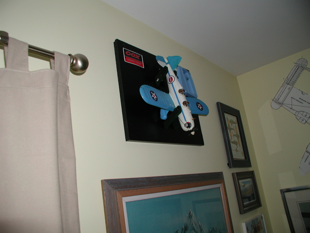

Post  rsv1cox Sat May 20, 2023 3:09 pm

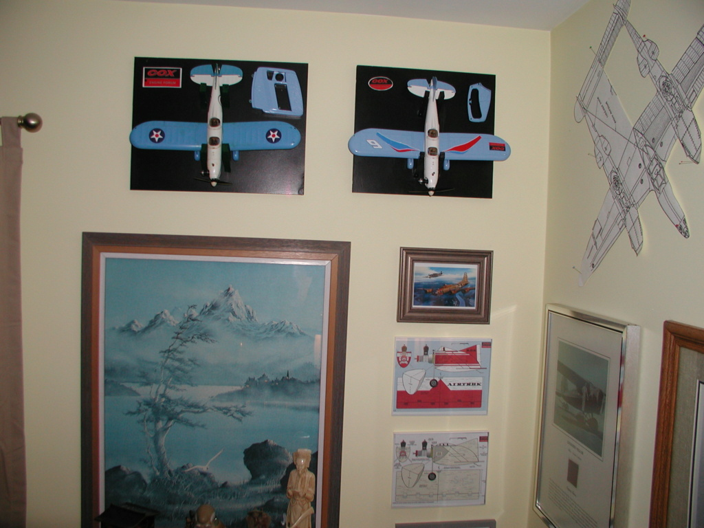

Change of plans.
The display will not fit between the ceiling and the propeller like I thought it would.  Losing my eye!
Solution was to move the Peashooter picture over rotate it 90 degrees and put it there instead.  Not a bad fit for the Ryan but were I to do it again I would have cut the same size mount board instead of using what was at hand.  Planes now match the handles.  Both planes are easily removed.

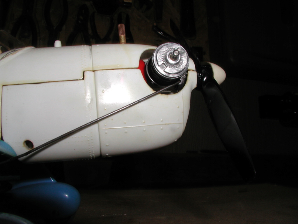

It was clean on the outside Robert, but despite applications of every goo cleaner that I have I could not get the sleeve to rotate freely, more like not at all.  But once off alcohol cleaned it right up.
But, the standard non throttled version did get airborne sometime last night.  Came down this morning and found it on the floor.  Lawn dart style straight down.  Sometime last night three of the uprights failed.
