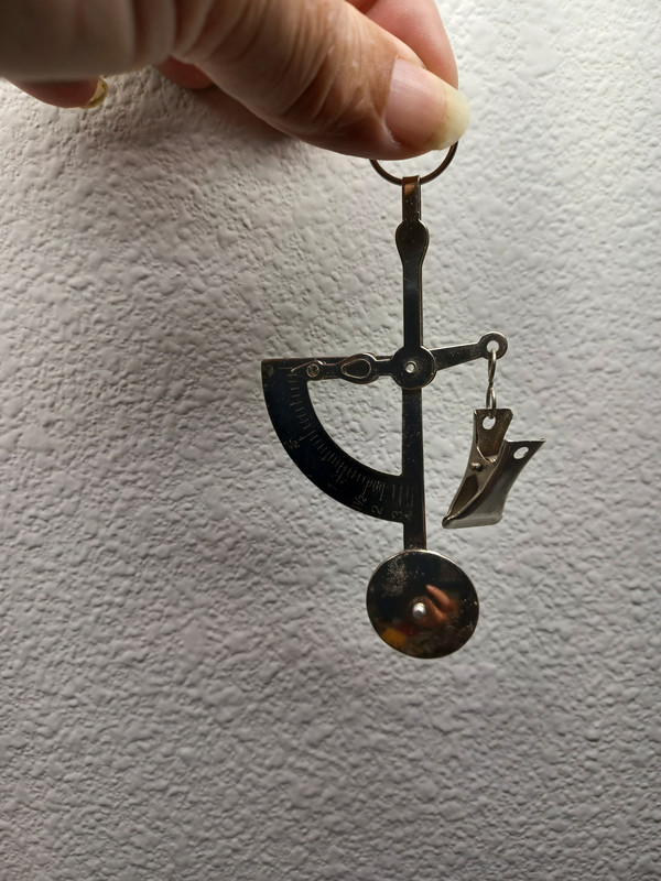

Post  GallopingGhostler Sat Jul 01, 2023 2:29 pm
When I built my R/C planes, I didn't have a weight scale but didn't need one. If you built and equipped per plans / instructions even with then standard servos & battery pack, it would fly as intended.
Q-Tee was designed to haul then standard R/C flight pack. I had Dunham Bantum mini servos & lighter 225 mAh 4.8 V nicad batteries, so I was within limits being lighter, flew well under Golden Bee power.
Actually, I take that back. I did have a small handheld balancing beam manual postal weight scale, it provided a confidence check. Wink

Post  batjac Sun Jul 02, 2023 1:06 am
GallopingGhostler wrote:When I built my R/C planes, I didn't have a weight scale but didn't need one. If you built and equipped per plans / instructions even with then standard servos & battery pack, it would fly as intended.
This is the scale I had back when I originally built the Q-Tee, a four ounce postal letter scale:
RC planes are so much heavier! 20230702-005048
The Goin' Postal Mark
