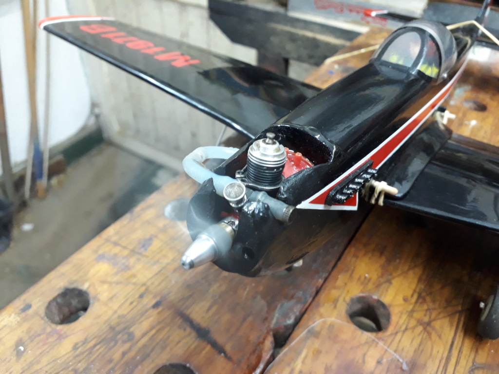

Well, really, what András says happened to me too.
A) The new generation glog plug loses compression in the center (cathode or anode), not against the cylinder.
B) the glow plug works fine at high rpm, wanting it to keep the rpm low (with restrictor ring), the engine stalls.
(I made several attempts with the fuel, finally I took a glow pluj from the old manufacture (in Cox bags), the engine works correctly, in high and low rpm.
This happened to me when I made the Micro P51 Mustang.
I can make a video for the case as soon as I have time showing the above.
I never made the claim, I took it as a fortuitous case of a product that does not meet 100% of its quality.

Although we did have some leaky 049 heads some years ago (they were not properly pressed), we did not come across any 010 versions like this so far. Which doesn't mean that it can't happen. Again, we warrant what we sell.MauricioB wrote:good. Here are the glow plugs I received. On the left is the one that loses compression through the (cathode or anode), it makes a micro bubble or balloon when it is in operation.
It doesn't hold the engine running at low rpm, probably due to pressure loss.
It is dated the day of the test in the plastic envelope: 08/04/2019, (April 4, 2019).
The other glow plug on the right came with this one, but I haven't used it yet, (I put a Cox Vintage glow plug on my engine).
I don't remember the exact supplier, but it is possible that they come from Mr. Bernie, since he buys some accessories through my importer, Mr. Ojeda.
Indicated with an oval and green arrow .010 that's original vendor handwriting, someone on the vendor's team might be able to recognize it.
Mr. Bernie only the letter marked in green is that of the supplier. everything else is my own handwriting, do you understand? In my comment I try to indicate that.
I can maybe trace the supplier, I have to contact the importer and see if he has the order, but I don't claim anything, I just share a personal experience.
MauricioB- Top Poster
- Posts : 3456
Re: 010 head stops glowing
Admin wrote:MauricioB wrote: On the left is the one that loses compression through the (cathode or anode), it makes a micro bubble or balloon when it is in operation.
Might be able to carefully apply some high temperature RTV sealant or epoxy like JB Weld around the contact to seal it.
I've had old original Cox heads leak and blow bubbles around the contact post before.
thanks Jacob, look, I have sometimes solved this problem by enriching the fuel with castor oil, ie running the engine with high castor oil for a while, as it works, in some cases it has been sealed with the oil itself.
