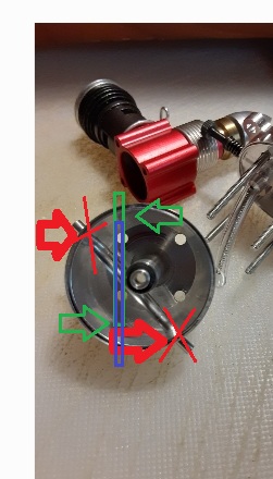

MauricioB wrote:
Cox International wrote:Not sure where those heads are from, as we don't package them that way (not is it our handwriting). We also would not write "gaskets" in Spanish.
Although we did have some leaky 049 heads some years ago (they were not properly pressed), we did not come across any 010 versions like this so far. Which doesn't mean that it can't happen. Again, we warrant what we sell.
MauricioB wrote:good. Here are the glow plugs I received. On the left is the one that loses compression through the (cathode or anode), it makes a micro bubble or balloon when it is in operation.
It doesn't hold the engine running at low rpm, probably due to pressure loss.
It is dated the day of the test in the plastic envelope: 08/04/2019, (April 4, 2019).
The other glow plug on the right came with this one, but I haven't used it yet, (I put a Cox Vintage glow plug on my engine).
I don't remember the exact supplier, but it is possible that they come from Mr. Bernie, since he buys some accessories through my importer, Mr. Ojeda.
Indicated with an oval and green arrow .010 that's original vendor handwriting, someone on the vendor's team might be able to recognize it.
010 head stops glowing - Page 3 20230718
Mr. Bernie only the letter marked in green is that of the supplier. everything else is my own handwriting, do you understand? In my comment I try to indicate that.
I can maybe trace the supplier, I have to contact the importer and see if he has the order, but I don't claim anything, I just share a personal experience.
Last edited by Cox International on Thu Jul 27, 2023 11:37 am; edited 1 time in total (Reason for editing : Typo)

010 head stops glowing - Page 3 Empty Re: 010 head stops glowing
Post  MauricioB Thu Jul 27, 2023 10:34 pm
Hello Mr. Bernie!!...
I understand that some part can fail. I do not claim anything, I repeat, I only share this experience.
Exactly when I detected the problem, I discarded the glow plug and I didn't inform him of anything, it is that I keep in mind that this can happen, we are very far away (cost distance) and I let it go.
I appreciate your attention and your support, if at any time I make an order, I remind you.
A hug from Argentina, thank you.
