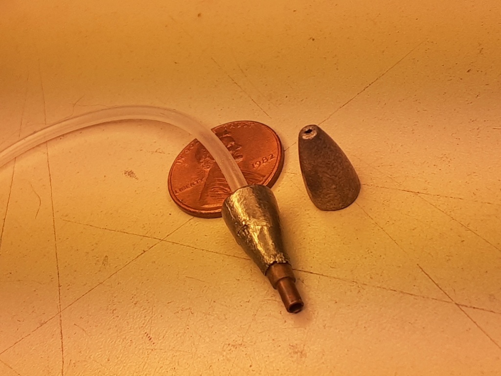

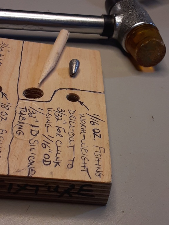

I made this little fuel cell clunk from some small (3/32" OD X 1/16" ID) Silicone tubing that I sourced from Amazon.com, a 1/8 oz. "worm weight" (fishing item) drilled-out.. and a short piece (5/16"L.) of 3/32" dia. alloy tubing. This forms a "compression-fit" when assembled.
a small clunk (fuel pick-up) Small_12
The "final" drill used is a 7/64" (I needed to start with a 1/16" and increase in succession)

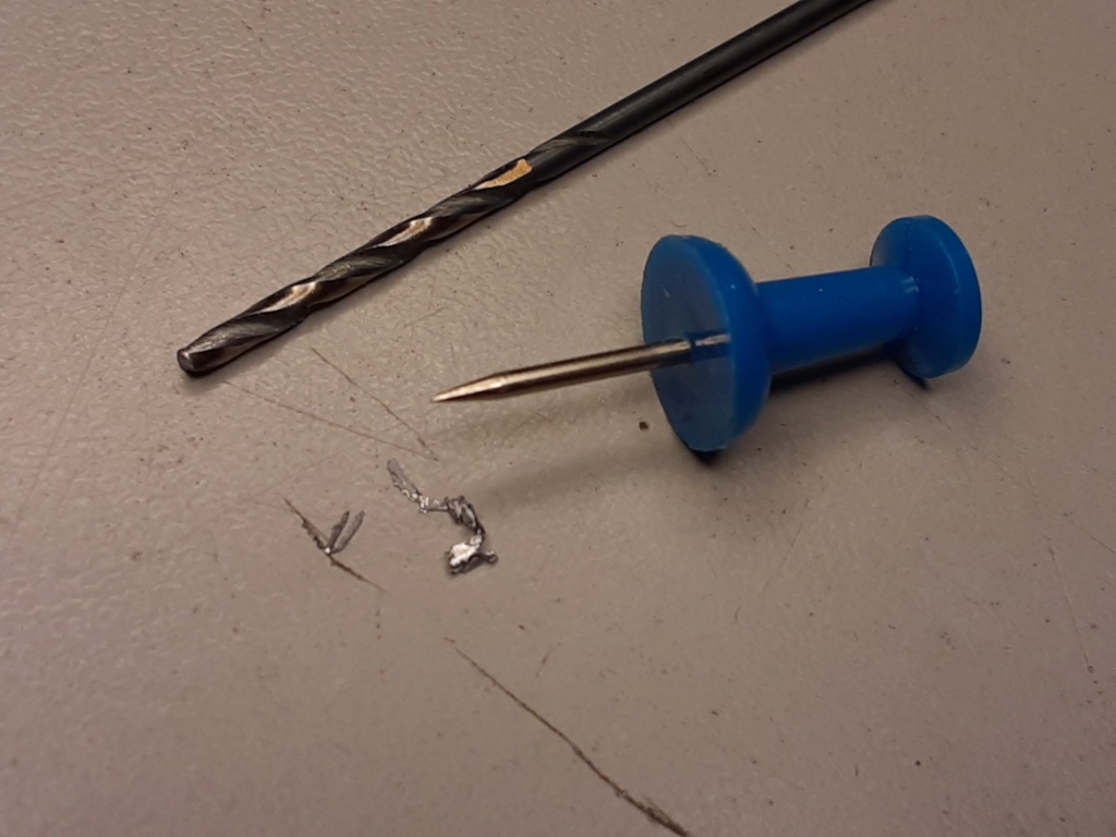

I ended up making a fixture to drill-out the weights using my drill-press. It's a small block/pad of 15mm baltic ply into which I drilled a 1/4" thru-hole. I then tapered the top-side slightly for the 1/8 oz. worm-weight to fit into. The weight is then "tapped-in" squarely using a small hammer. This keeps the weight from spinning-out while drilling. The weight material (antimony?) is soft and sticky. This is why I needed to use four drills.
a small clunk (fuel pick-up) 20231111
a small clunk (fuel pick-up) 20231112
To remove the weight, I use an awl inserted from the underside of the block/fixture.. and give it a light tap.
The drills "load-up" with the sticky chips even if performing pecking-strokes. This 1/16" drill is tool #1.. followed by a 5/64" then a 3/32" and finishing with the 7/64". The push-pin works great for cleaning chips from the drill flutes.
a small clunk (fuel pick-up) 20231110
The tapered "tip" of the weight is thin where the final (7/64") drill breaks-through.. and as a result; can become jagged. This is why an awl works well for removal from the fixture. I've been using an 80grit sanding-block to cut the tip back into thicker material for when the 3/32" alloy tube/pick-up is inserted with silicone tubing attached (doesn't need much.. maybe between 1/8" and 3/16"). The pick-up assembly gets pressed-into the weight from the TAPERED-SIDE.. and is a tight fit.

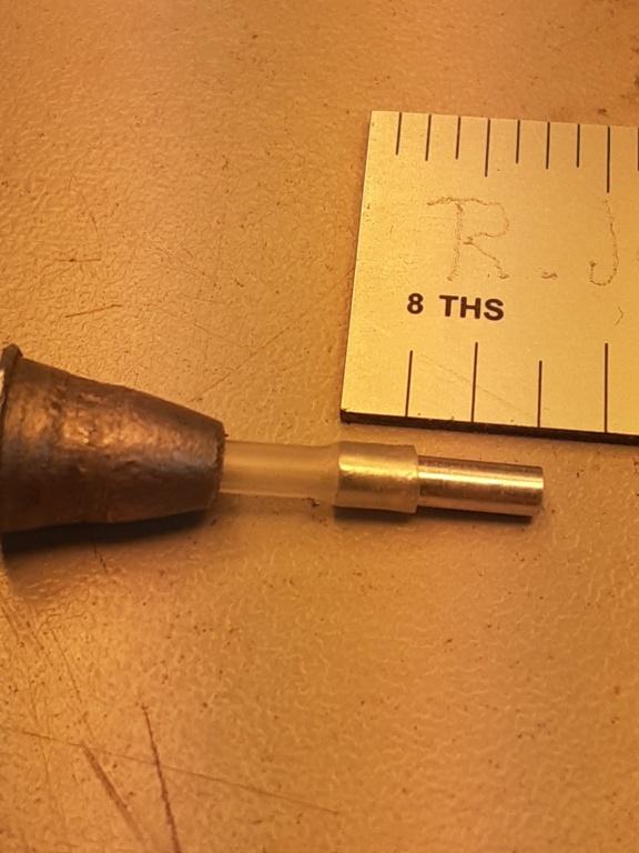

Here's my latest clunk with a 3/32" (OD) aluminum pick-up tube. It seems that a 3/8" length is plenty.. with approx. 1/8" length of silicone tubing attached.
a small clunk (fuel pick-up) Small_15
I drilled a 3/32 hole in the side of my fixture.. to aid in cutting an alloy tube to the correct length with a dremel/cut-off wheel.
a small clunk (fuel pick-up) _093_a10
Pulling the silicone tubing through the nose of the weight from the backside.. stretches its diameter slightly smaller around the pickup assy. making it easier to press it into the weight.

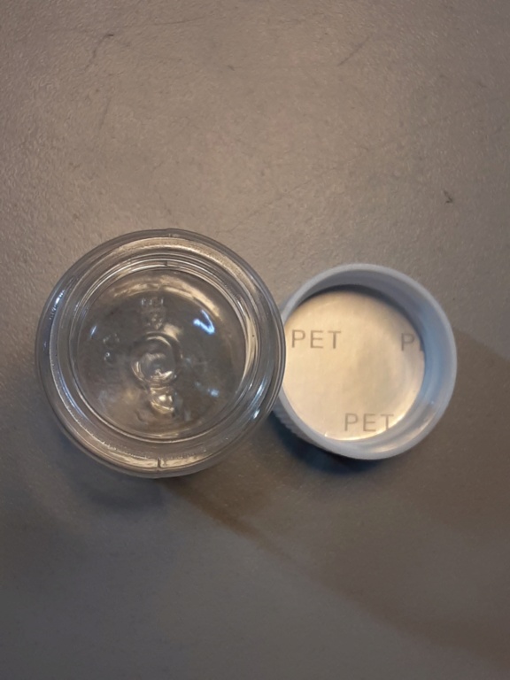

The one dozen 15cc clear plastic bottles w/caps arrived early today (Amazon Prime) along with another package of the 3/32" X 1/16" silicone tubing.
a small clunk (fuel pick-up) 20231118
a small clunk (fuel pick-up) Amazon14
Just a reminder.. that this silicone tubing's ID is .059" (sold as 1/16") which is significantly larger than the Dubro sm. size that I've been using for decades. This latest stuff I found is more fragile.. due to its wall-thickness. Some smaller tubing will be coming in a day or so. I want to see what works with these new bottles..
The new 15cc (.5 oz.) is the stubby on the right..
a small clunk (fuel pick-up) 20231120
the above photo is deceiving.. when compared with a bottom view of the same bottles;
a small clunk (fuel pick-up) 20231121
The cap comes with an insert/seal.
a small clunk (fuel pick-up) 20231122

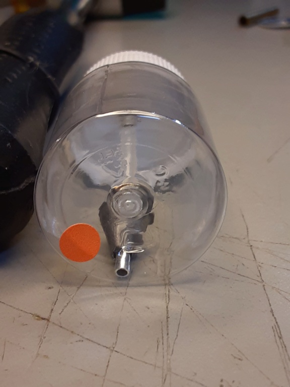

The clunk seems to work pretty well.. Note the position(s) of the orange sticker on the bottom of the bottle.

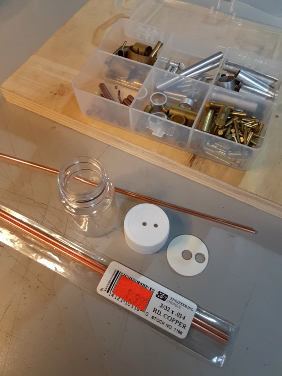

Post  roddie Wed Nov 08, 2023 8:26 am
This has been a learning experience. The hard-tubes (all) are 3/32" copper. I used a short piece (.750") of 3/32" Aluminum tube and a pointed-tip on my soldering iron to melt holes through the cap.. which worked very well.
a small clunk (fuel pick-up) 20231124
a small clunk (fuel pick-up) 20231125
The cap-seal got a re-make for the use of my 1/8" hole-punch. I used the same thickness coated-paper (.020") from Duracell battery packaging. and used a 15/16" circle-template to trace a new cap-seal.
a small clunk (fuel pick-up) 20231123

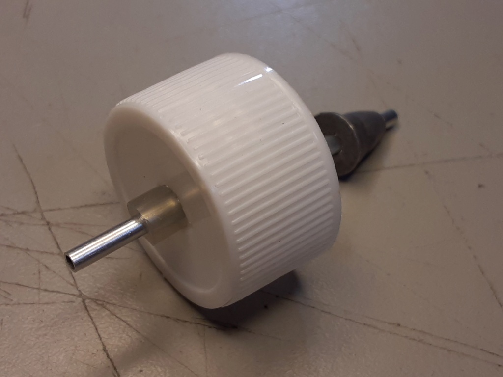

OCD... I cut the copper feed and vent tubes.. and soldered flat-washers on them which will bear-on the outside of the cap.

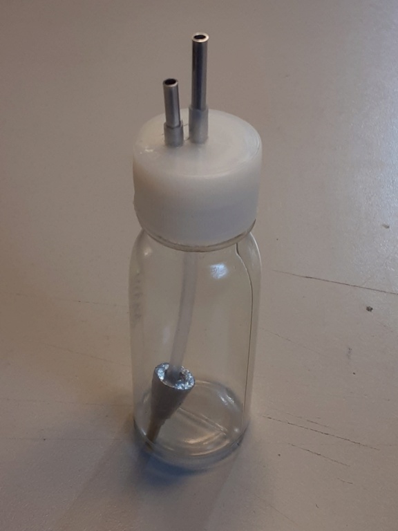

Here's the final-assembly with cap off to show the inner detail.
a small clunk (fuel pick-up) 20231127
and cap on.. showing the soldered-washers on the feed and vent-tubes.
a small clunk (fuel pick-up) 20231129
