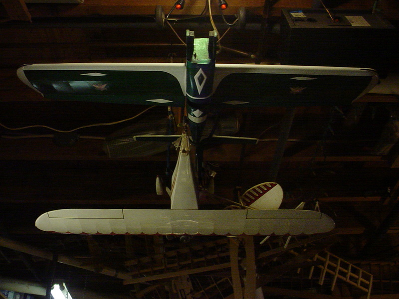

That Skylark is slick Ken! If you lived nearby, I'd give you my uncovered Warrior. God only knows if I'll ever do anything with it. I think my Dad had a Chief.. They were all Veco/Sterling kit guys; my gramps, dad and uncle.. although my uncle also built Top-Flite kits and built some models from plans (the Jr. Falcon). My dad and uncle are still with us.. but neither would think of picking up a handle to fly now. My dad has diabetic-neuropathy in his feet.. and his brother in-law (Uncle Vin) has had trouble with dizzy-spells that started coming-on decades ago. He gave me his Renegade recently. The only thing he has left of the hobby is the ST .35 that was on it. He's given me most everything else.
The Warrior has nice lines.. even if utilitarian. I think my dad designed the trim scheme.
![Warrior "flapped" stunter - Page 2 11-4-116](https://i.servimg.com/u/f37/18/50/45/90/11-4-116.jpg)
I decided to give the model a warm home. Plus.. I made it fit up in to the basement ceiling right next to his more recent Monocoupe.

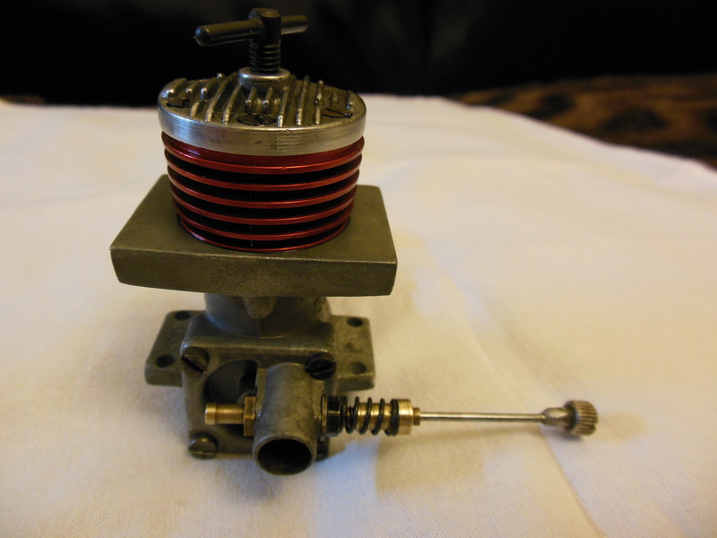

Stripping down an engine should always be a last resort and I never really see the need to tear apart a runner.
Caution is needed and there are always reasons why a motor might need more than a wipe down. The ingress of dirt in the venturi, in my opinion, always needs attention but ....... there is always a but .........a combat engine that has eaten dirt is usually pressed back into service. It is a contest engine and the chances are that there is very little that is abrasive in the dirt.
I would remove the back plate and flush out with fresh fuel.
I see no necessity to take apart a regularly fired up engine to do a spotless spring clean - it is a working beast. If I was putting it in a new model - then I would clean up the outside but with just a toothbrush and a selection from the myriad of fluids that I have.
I have never used a "crock pot" because I don't have one and prefer other methods.
When I get an engine and can get it to turn over with very little effort then I clean the outside - bear in mind that the majority of engines I get are considered scrap or "for parts" - but I have selected that engine because it is a golden oldie.
Here is an example of what I would call a partial restore. An old ED engine - 60 years old when I got it, and seized (They usually are!). A couple of hours in Hoppes No 9 and here are the before and afters.
![Warrior "flapped" stunter - Page 2 Ed_res10](https://i.servimg.com/u/f37/17/71/25/79/ed_res10.jpg)
![Warrior "flapped" stunter - Page 2 Ed_res11](https://i.servimg.com/u/f37/17/71/25/79/ed_res11.jpg)
Why would I do this? It isn't a perfect example or considered by me to be a shelf queen.
I want to see the serial number, make sure that the mounting lugs haven't been butchered, check for cracks and see that all the screws are intact (not been forced open by a gorilla with a chisel!)
Many engines I wouldn't contemplate touching but some ........

The venturi on this went to complete a Space bug - the crankcase was bored out and shortened to take a Bee crankshaft, the piston and cylinder were cleaned - the cylinder blackened and used for another restore.
The crankcase, Bee crankshaft, rear plate/ reed assembly were used to build the engine in the "Rocking Donkey".
![Warrior "flapped" stunter - Page 2 Rockin10](https://i.servimg.com/u/f37/17/71/25/79/rockin10.jpg)
So - I agree with Ken and you should think carefully before stripping an engine as the chances of ruining it are high but ....... some will not clean themselves or free up easliy.
