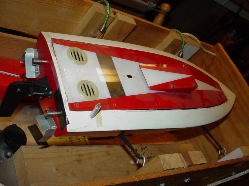

Hey Dave, I'm hoping you'll be running your model... so I thought I'd give you an idea on a "caddy" that I built for my smaller "built-up" Dumas Deep Vee 10 (also known as "Short Stuff") This is an onion-crate that I got from the Super Dave market..
I added 4 vertical furring-braces with cup-hooks to attach sm. bungee cords to, for a cradle. Heavy rubber-bands would be better.. and with some foam-rubber padding around the cup-hooks. (to avoid possibility of scratching)
I built this model back in the early 90's. The hdwe./running gear is all Graupner (from Hobby Lobby) It ran at a speed of about 15 mph with the stock 540 "can" motor and a 6 cell NiCd pack that I had to custom-build, with 3 cells on each side, straddling the motor.. with a jumper-wire connecting them. A "brushless/LiPo" conversion would do wonders.. because it's a pretty heavy little boat for being only 18" long and having a 6" beam.
