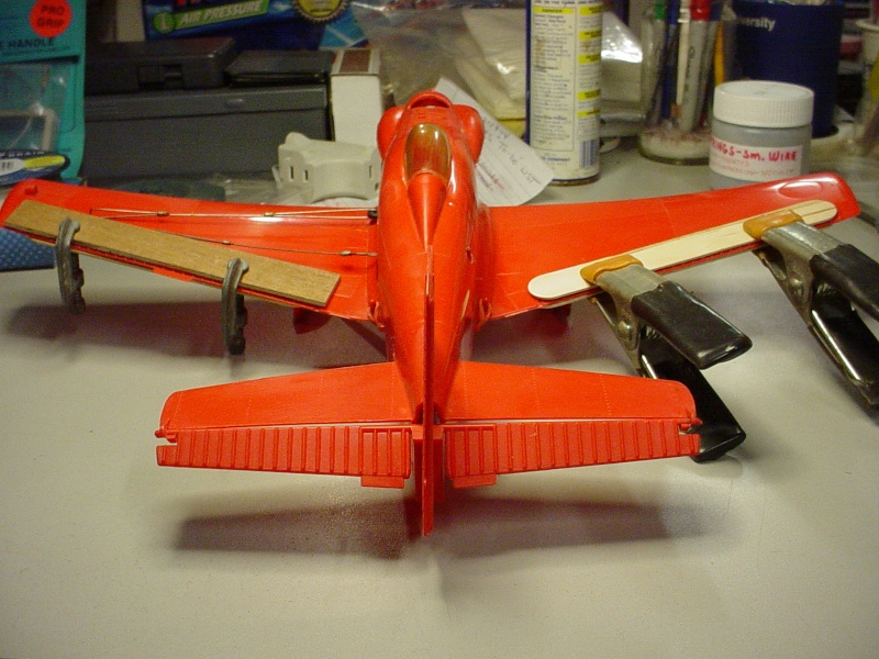

I noticed very slight warping along the trailing edges of my Cox Cosmic Wind models' wing... probably from years of sitting in a box with other models that hadn't been used in years and in disrepair. This airplane only flew a couple times... because it was too hard to stooge-launch from the grass where I used to fly... and was certainly no fun to land on the grass either.
I want to try flying it this weekend over pavement, with the 42 ft. regulation line-set for the speed contest... just to get myself used to turning circles again.. before I fly the Rare Bear. This model was furnished with 2 props from Cox.. which I still have. A 5 x 2 and 5 x 4.. with special molded hub to which the spinner snapped onto.
I clamped pcs. of wood along the trailing edges in hopes that this would straighten them out. Would using a heat-gun while they're clamped, help to "set" the edge back straight?
wing warp on Cosmic Wind 4-11-110
The outboard wing's leading edge looks like it dips slightly too... any thoughts on this?

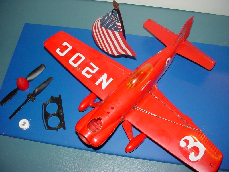

Here's an older pic that shows the props/spinner and handle that came with the model when it was new. The decals were peeling.. so I removed them today.

Roddie: I would go with the hair dryer on low to start with. The plastic doesn't need to melt to flow, just get warm. Also the wood pieces need to be hard and NOT flexible like the tongue depressors.  When the plastic is warm it should take the form of the flat hardwood pieces.  Two Cents

Thank you happydad... I think that's sound advice. I have some 1/4" x 2" maple stock that I could rip in half... and cut 4 pieces about 6" long. They'll be thin enough to clamp easily. I'll try the hair dryer 1st... let it cool-down for an hour or so... then check it and repeat if needed.

Warped plastic is a BEE-ITCH, a heat gun works great...until your plastic melts without warning, I've found steam from a teapot or a hair dryer works better, safer. have cold water to dip the warm plastic in works more then anything, as it seems to "lock" the newly warmed plastic into shape. Reforming plastic is almost a art in itself.

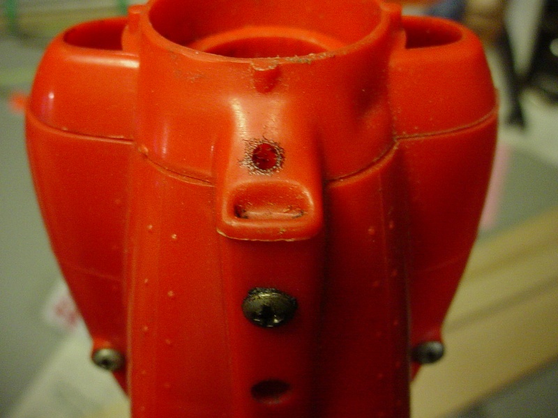

Note that the model has a rather large slug of "lead" in the nose from the factory. It is secured with a screw on the bottom and could be removed for balancing.
