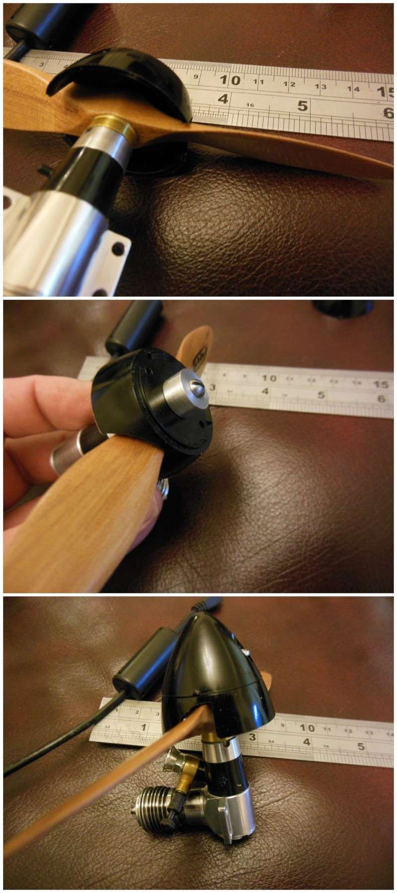

Post  ian1954 Sun Jun 01, 2014 4:35 am
I do!

Didn't get spacers with my spinners - hole slightly larger but easy to centre.
1.5" spinners Spinne11
This is obviously not a Dubro spinner - the plate is not between the propellor and the engine.
When I search for 1 1/2 " Model Aircraft spinner - I find loads like the one I have but in the UK. There is not makers description and they are shipped "loose" - no packets with labels.
http://www.rcmodelcentre.co.uk/spinner-rc/cat_60.html
According to this site the manufacturer is Radio Active
http://www.modelshopleeds.co.uk/catalog/index.php?manufacturers_id=32
They are
http://www.radioactivemfg.com/index.htm
Sorry if this doesn't help.

In a discussion with Roddie, he brought up that that rotational mass might load down the engine. It's a valid point, does anyone else care to weigh in?
I want the spinner to blend into the nacelle for a streamlining effect as well as an aesthetic look.
