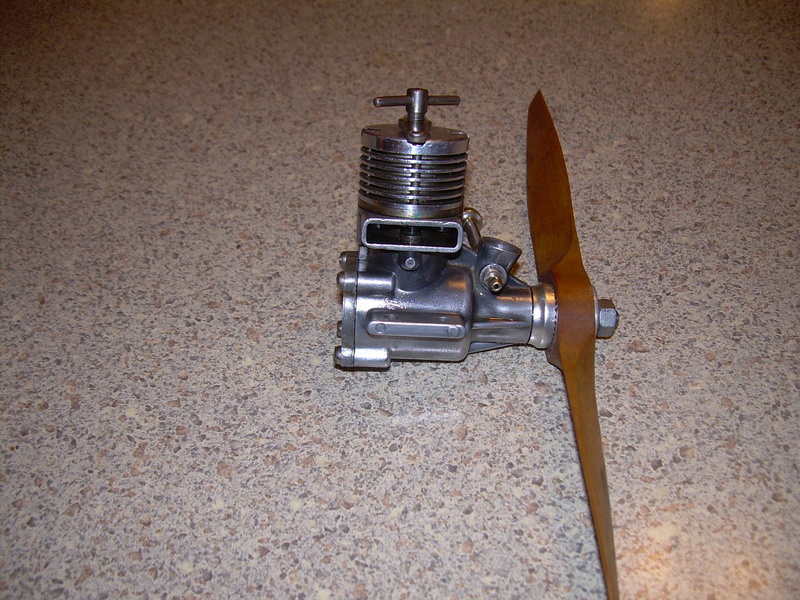

Post  Ken Cook Sun Dec 18, 2016 7:22 am
I managed to get this back together last evening with the help of Bob Brooks. The Enya diesels are not very common in these parts. This one had some pretty bad damage. Cracked drive washer, broken prop washer and a damaged bearing. If I had to fathom a guess, I would say it took a shot. The backplate showed some scars which I polished out and threads on the shaft needed some attention. This Enya is bushed and ball raced. A very simple design and easily serviced. Robust rod internally and heavy duty crankshaft. A very nice piece which will be a lot of fun to run on the bench. It feels very smooth and I'm looking forward to running it.
      Enya .15 diesel MK II Dscn2617
      Enya .15 diesel MK II Dscn2618

Post  fit90 Sun Dec 18, 2016 11:10 am
That is a beautiful engine. You did a super job bringing it back to its old glory. I hope it runs as well as it looks good for you.

Post  rsv1cox Sun Dec 18, 2016 3:19 pm
Nice job Ken, of all my Enya's not one is a diesel.
Thanksfully, there is a Bobby Brooks. I live off him or he off me, don't know which. I see that he has a connecting rod for a .15 diesel. Nice to know. I need one for my Thunder tiger variant .15II but it's one of the few parts that he does not have.
Got to look your's up on Bob Allans' compendium. Did you take a "before" picture? Another member here uses kerosene and 800 grit to polish his engines and they come out beautiful too. Are those normally polished like the Enya .09 and .15 II's? They are the only two Enya's that I know of that are, most are a matte finish.

Post  Ken Cook Sun Dec 18, 2016 3:28 pm
Bob, this case is certainly different than most Enya's I've owned. At first I thought it was a result of a bad crock pot soaking as I've seen some cases ( OS MAX-S ) become mottled and discolored. I just used Mother's sparingly followed by a light scrubbing with a stainless brush in the nooks and crannies. The top cylinder fins appear to be chromed aluminum. Bob has almost all parts for this engine. A real neat piece. I wasn't going for appearance that much as functionality is important here. I did note that it weighs just slightly more than the glow.
