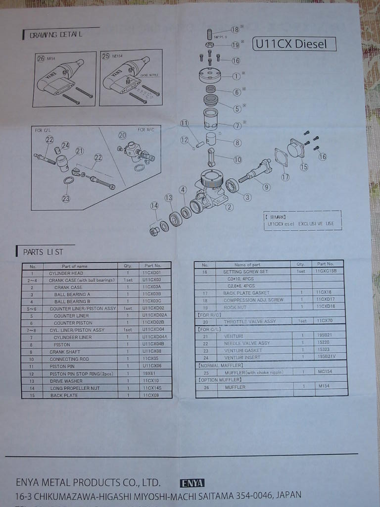

They are(were?) available both ways. 11CXD-S (CL) and 11CXD (RC) 11CX40 is the carb.
http://www.enya-engine.com/ULTRA11CXDManual_E.pdf
You can try Enya direct http://www.enya-engine.com/catalogueE_top.html. Or maybe member sosam117 can help you?

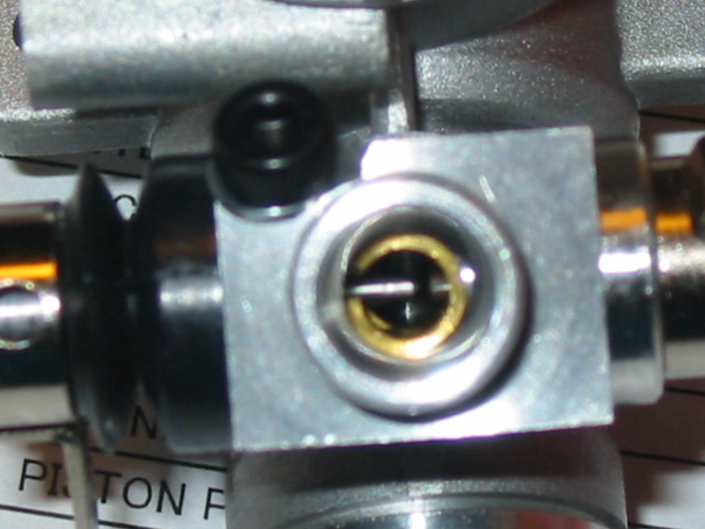

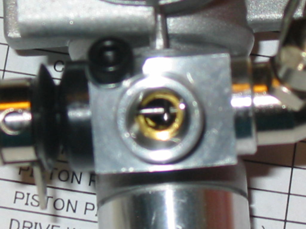

One thing also with the 11CX70 carb is just like the Enya 195B30 carb. It has a sleeve in the venturi to reduce the size of the intake ----see the photo below of the intake with the sleeve.
At the bottom are photos of the Enya Ultra 11CXD with the 11CX70 twin needle carburetor with safety needle valve (pointing back from the prop).

If you get the 195B30 or the 11CX70 carburetors, you will have to sleeve the venturi down in size to either 4.5mm or 5.0mm.
The original size of those venturi is more for the glow engines, whereas the diesels can use a smaller size venturi.
If you do go with the larger venturi, you get a slight increase with a slightly higher RPM, but diesels run better with larger props at slightly slower speed and consume less fuel.
Brass sleeve in venturi to reduce intake size for the diesel engine verses the glow engine.
Look carefully and see the brass insert in the photo.

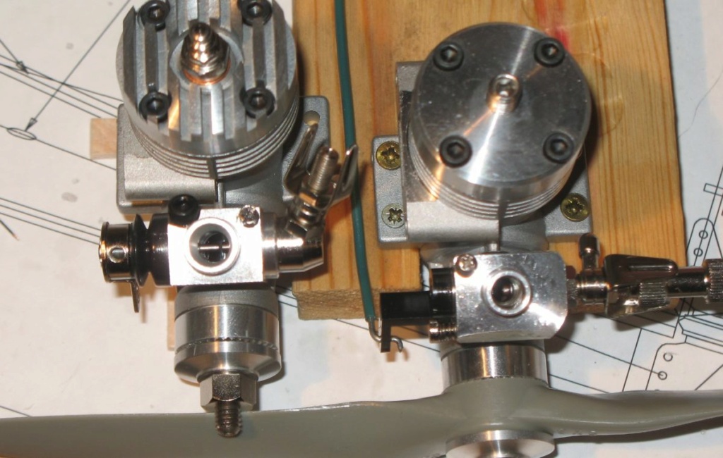

The one on the right of the photo is what I had back in 2006

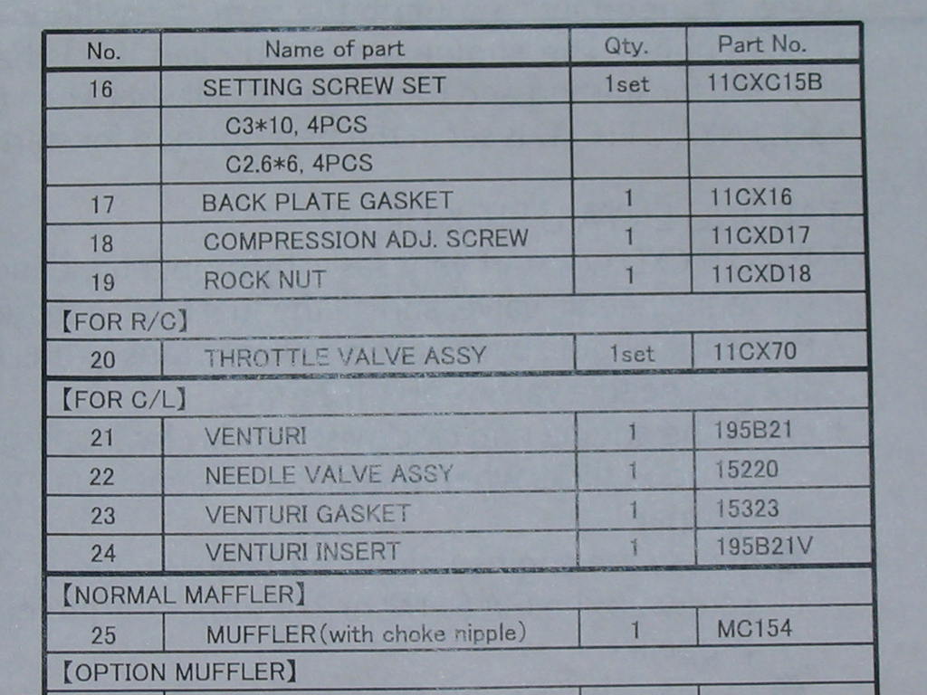

That's the 11CX40 carb, with a 4mm bore and their "metering" feature for the mid and low range. This carb came with the 11CX-D (AAC), U11CX-D (the ABC, Ultra) and their SS15-D (all diesel engines).
The glow engines, U11CX and SS15BB, came with the TN-101C carb (twin-needle type).
The notation 11CX70 stands for the "throttle valve assembly" of the TN-101C carbs, as far as I can tell.
