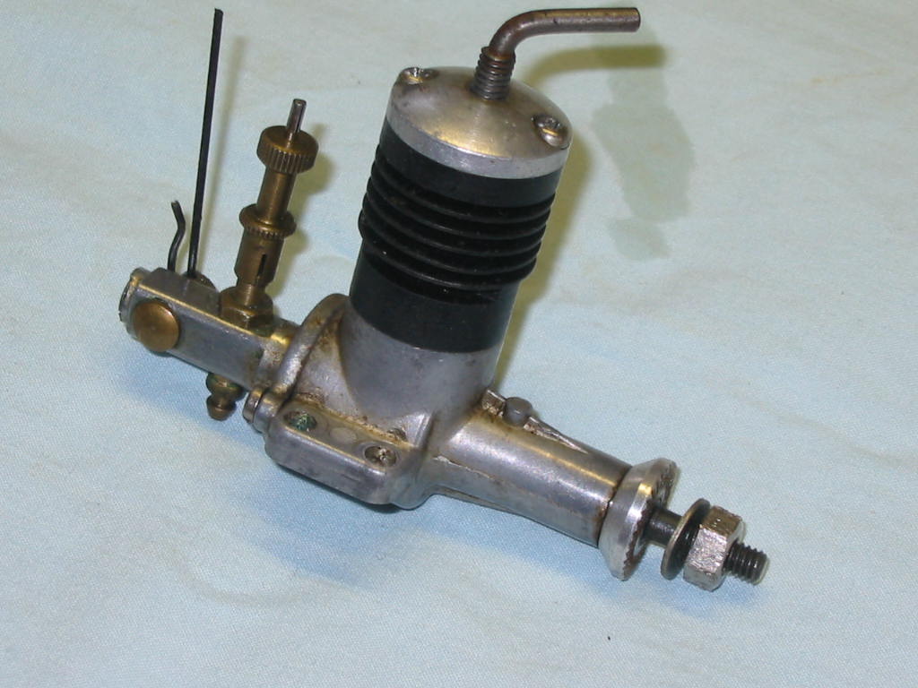

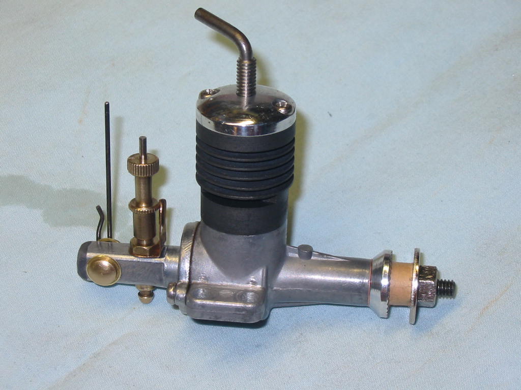

Been busy reconditioning Enya engines.
I have another one done.
It is an Enya 06 T.V. Diesel Rear Induction Engine:
Here are the photos before / after:
The engine was missing the spring on the needle valve, wrong prop washer.
It is still missing the starter spring and locking lever on the contra screw. (parts is not available any more.)
I'll make a locking lever that will look close like the original.

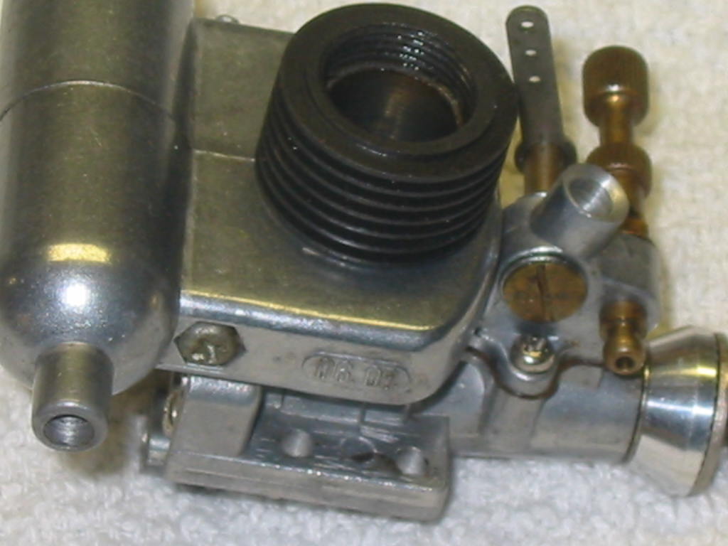

Nice !! Is that a throttle lever? I see you restructured the intake also ? Good luck on the parts search!

getback wrote:Nice !! Is that a throttle lever? I see you restructured the intake also ? Good luck on the parts search!
First answer to your question is "YES" it is a throttle lever.
It was missing a spring washer on the one side to give some friction on the throttle barrel, so I made my own.
2nd answer to your question:
Yes, I used a little JB Weld because the groove that holds the "C" clip was 1/3 gone from over the years.
I could have just removed the "C" clip and screen but I wanted to preserve what is there.
What I did was to use a small plastic straw to keep the JB Weld from closing in on the screen and try to keep the screen dia. the same. Then I built up the JB Weld around the outside dia. of the plastic straw, Leaving plenty of JB Weld on the intake to sand it down later.
Next day, I removed the plastic straw. The JB Weld didn't stick to the straw (what I wanted).
Then I carefully sanded off the excess JB Weld to blend into the intake venturi.
Then, using a small brush (using Aero Gloss clear dope) sealed the JB Weld from fuel.

The Enya 06-D lever in the back on the venturi intake is a choke style throttle. Just about like a Cox Sure Start engine, with the throttle lever at the end (top) of the intake tube.

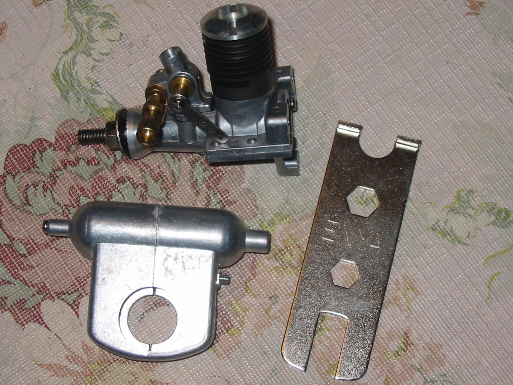

Here are My two Enya engines ( one glow / one diesel) I was breaking in in the summer of 2019.
My Diesel 06-II Version #4:
My Glow 06-II Version #4
Enya Muffler for the engines:
I was breaking them in without the muffler installed.
The fuel tank I made holds 14cc of fuel.
I wanted to see the run time on each engine on 14cc of fuel.
The glow runs for around 10 minutes. The diesel will run for 13-14 minutes
Prop on the glow and diesel were the same (APC 8x4) though the diesel could have taken a larger prop?
Another thing to know on these engines is -- they all have very low compression ratio. (about 8:1?)
