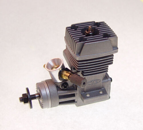

Jim in the (parts list) the engine comes with a CL venturi option.
http://www.mecoa.com/kb/88/8801.htm
Update they sell this motor under their name on ebay all setup for CL use see link:
https://www.ebay.com/itm/K-B-18-cu-in-Control-Line-Engine-NEW-IN-BOX/281012068341?_trkparms=aid%3D333200%26algo%3DCOMP.MBE%26ao%3D1%26asc%3D20171012094517%26meid%3Da57f238b3060467d9bb67d8dc62bcd1b%26pid%3D100008%26rk%3D11%26rkt%3D12%26sd%3D113534577632%26itm%3D281012068341&_trksid=p2047675.c100008.m2219
