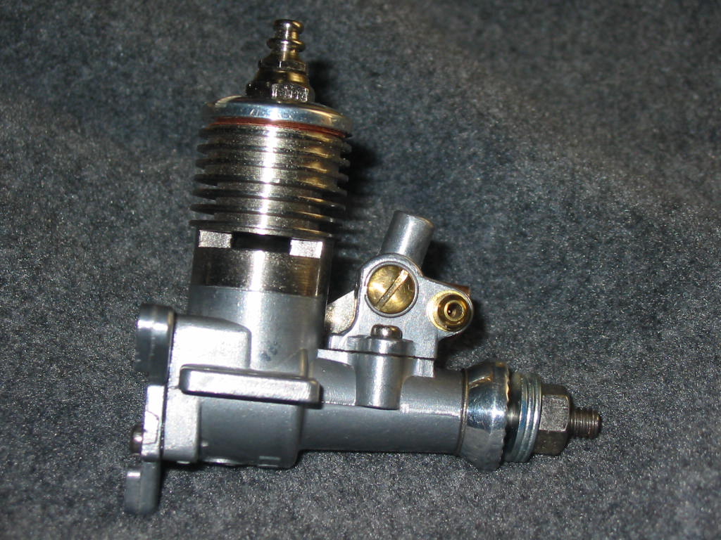

Hello ffkiwi,
I almost have the complete family of Enyas:
049 rear induction / 049-II (series #1/2/3/4 -- venturi - T.V. differences)
06 rear induction / 06-II (series #1/2/3/4 -- venturi - T.V. differences)
06D (diesel) rear induction / 06-II (series #1/2/3/4 -- venturi -T.V. differences)
08-II (series #1/2/3/4 -- venturi - T.V differences)
10-II (series #1/2/3/4 -- venturi - T.V. differences) I currently do not have a Enya .10-II series 1 engine.
I do have a few gaps in the collection but am working on that.
I have been acquiring them since 2003 when I learned of these little gems. Still acquiring more of them!
First ones were (one) 06-II T.V (glow) and the other was (one) 06D-II T.V. (diesel) from Model Flight in Australia (in 8/8/2004).
Still have the sales receipt with the engines.
Acquired more of the little Enyas from a hobby shop in Singapore and diesel engines from Carlson Imports.
Enya 049 reed:
Enya 049-II series #2 (tilted forward venturi) series 1 has square venturi. (need to photograph that engine yet)
Enya 049-II series #4 (tilted forward T.V.) series 3 - venturi close to cylinder head.(need to photograph that engine yet as well.)

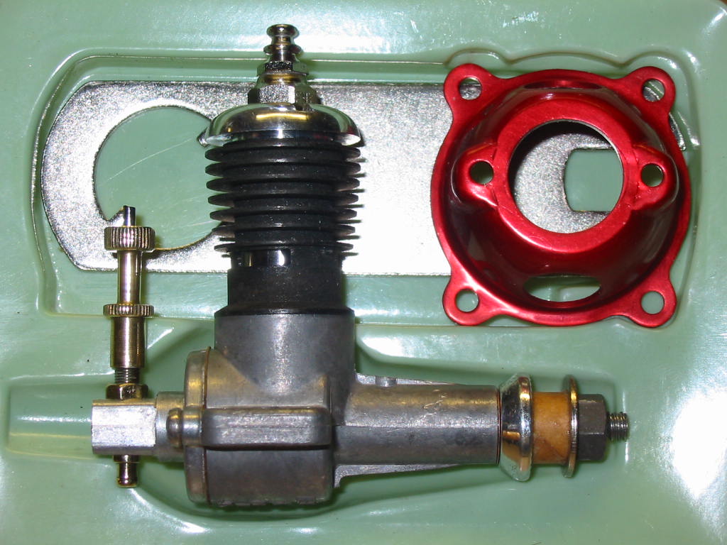

Enya 06 reed (glow) just recently refurbished:
Enya 06D (diesel):

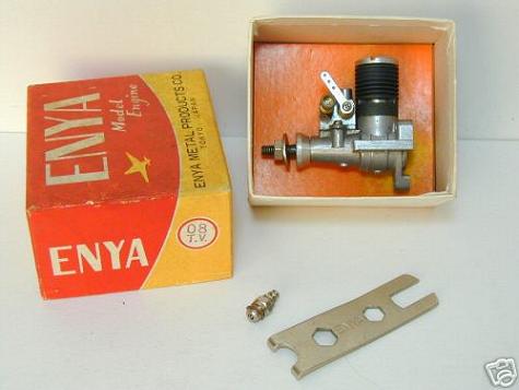

Enya 08:
I have not yet acquired a series #1 or series #2 engine (but still looking)
series #3 T.V. (straight up close to cylinder head.)
series #4 T.V. (for muffler)
