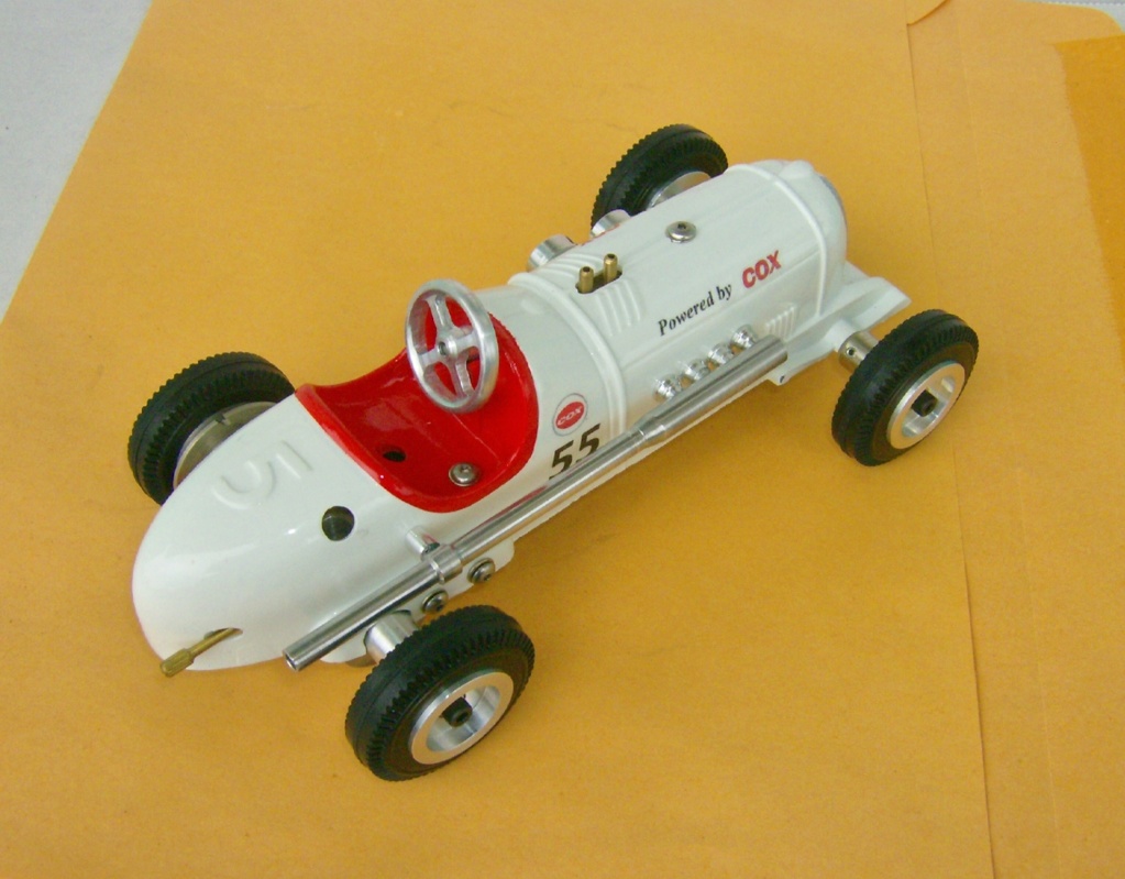

I had seen Leo Squire from Skystone make a few cox powered tether cars and I decided to try my hand at making one. He used a Hubley toy race car and I decided to use the same toy. I have worked on making a tether car engine out of a Cox reedy .049. using a production engine crankcase and cylinder I made a unit that mounted induction and provided for where to bolt a wheel. I made a flywheel for the engine and as I was doing it decided to switch crankcase to a car unit with the big crank since it provided for a better aligment for the flywheel with the taper at the end instead of splines. I still have to make a gas tank and paint my little tether car. I made a steering wheel,air cleaners,wheels and an exhaust out of aluminum. Here are a few pics.

I uploaded a video to you tube of the engine running is short because I did not want to overheat the engine. It helps to use a cox texaco 5 fin head but with no fan or airflow the engine has to be cooled by running it rich. I still have to make some cooling holes on the body to get some cooling to the engine. Thanks for the wonderful comments.

I do have a unit from a dragster but it won`t work well on the little Hubley toy open wheel car since it would make mounting the engine harder. I made the fly wheel with slots thinking it would be hard to start but using a few drops of fuel in the venturi and spinning the wheel with my fingers have worked real good for starting. I was going to use my home made electric starter but there was no need. If I was to build a full body tether car the flywheel with the fan would be the ticket as you have suggested. Thanks for the advice.

I have done some more work in the little Hubley Car. I made an aluminum gas tank,previously I tried to make one out of brass but I changed my mind and turned a tank on my small lathe. I also cleaned, primed,painted and added some decals I made in my printer.
Here are some pics. I still have to apply clear polyurethane to protect the paint job from the fuel. Once that`s done I will install the engine and other parts.

The tank idea came up after thinking about and starting to cut brass to solder together, I could not make it look good. Making it out of aluminum provided mounting points that I could tap with a 4-40 tap to mount the tank with only two screws.I was going to ad some blue paint to the nose but after looking at it I changed my mind. I didn`t want to ad a lot of decals not related to Cox or tether car because I thought they would look out of place.

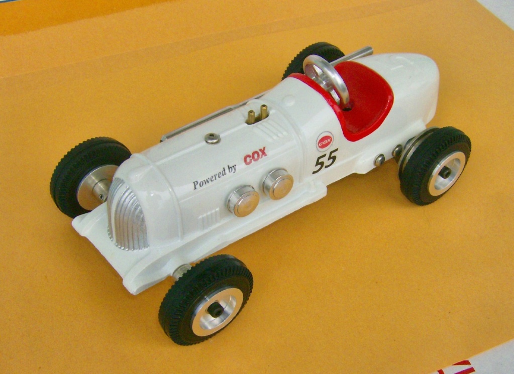

Well I`m done with the little car. i was able to clear coat the body with PPG urethane clear. When I looked at my paint sorage i noticed that I had no reducer and nowhere to buy some. I looked around and found some mineral spirits I had bought at a hardware store and decided to try mixing a little clear and catalyst using it. I tried it on a propeller to see how it would work since when I mixed it I noticed it turned cloudy but I kept stirring the mix and it cleared up. The prop came out Ok so I painted the body. Here are some pics on how it came out.
