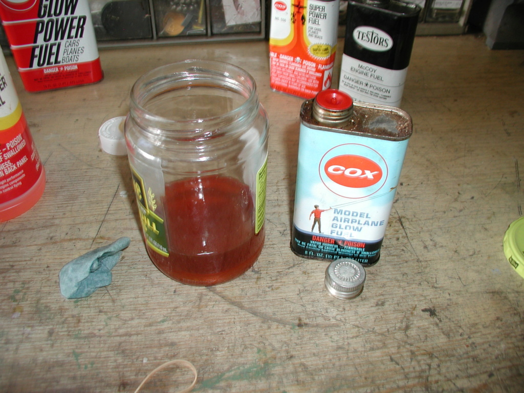

I have been meaning to do this for some time.
A couple of cans are empty but three contain some fuel. Some I have had forever, some came from flea markets. Not sure of the age, but I think from 10- 20 years ago.
Started out straining the fuel through a shop towel but noticing it was clear and wasting more than I was saving I just dumped them in a clean jar.
Dark but not cloudy. None of the cans display a break-down of content just nitro/methane. About 7 oz I would guess. Had about a half inch left of Cox 35 in the bottle so I just dumped it in. No sediment in the bottle of the glass jar.
Going to try it out on my Testors P-40, hope it works, if not I will try one of my never fail to start (most of them) Cox engines.

[quote="rsv1cox"]I have been meaning to do this for some time.
rsv1cox.
Try making the straining area inside the bottle larger. I typically use 1/3 to 1/2 the top area of the bottle to strain the fuel thru the wrap-cloth. That way the fuel has a place to settle and not spill over the top.

Hi Happy dad I always use two coffee filters like Melita in a funnel and pour fuel through. I had several VERY frustrating days with plugged intake pipes because a small piece of fluff from a plant or Q-tip or something ended up not getting filtered and getting sucked up the needle valve. The Coffee filters worked. I also use micro stainless filter before filling the tanks on the planes. No more problems.

Yeah, it was like watching grass grow or paint dry. The shop towel was doing too good a job, drip, drip, drip and I have two more cans to go.
Not worried about it, kept things clean and the fuel going in the Cox bottle was clear. More worried about the amount of oomph left in the fuel.

I think most of the coloring is coming from the old caster oil?
When It is first pressed it has a color to it. Then the 2nd press it is almost clear (still a slight yellow tint.
I think what is more important is still how much nitro is in there to still make the engine run?

From what I've read before, castor oil will drop out of suspension and collect into strands that look almost like wisps of cotton. This coagulation is minimized by using very clean caster oil. I think it is called first-pressed castor oil (check my memory on that).
I mix my fuel from methanol, commercially available fuel, and racing castor (medicinal castor in a pinch)...and then filter with a coffee filter just before use.
But I have also seen the "strands" when the mixed fuel sits for an extended period of time...shake, shake, shake, then filter just before use again.
So far, so good.
So far, so good.

Coffee filters sounds like a good idea, and I have plenty. May use one to filter the fuel again before I use it.
I washed the cans in hot soapy water and rinsed them off. Going to polish them with something - Pledge, auto wax, maybe even Howards Wax and admire them for awhile. Big following for vintage cans.
I popped the vacuum dented cans back into shape by injecting compressed air and will leave the caps on loose.

Rather than exposing the highly hygroscopic and volatile fuel to ambient air when filtering, I prefer using ultra light filters chucked in the fuel line upstream the carb of the engine.
https://www.ebay.com.au/itm/222145715101
Needs simple cleaning every season. Pouring fuel from one can into another, let alone through a filter, will allow it to absorb moisture from air and evaporate nitro and methanol i.e. strength.
Just my 5 cents..
Just my 5 cents..

Good point Andras and I used them on my R/C planes where there is a lot of room. Not so much room on these little 1/2A jobs and no space at all on the tanked engines where most of this fuel (hopefully) will be used.
Yesterday we had high humidity, today not so bad. I could filter in my basement where I keep a dehumidifier running 24/7 during the summer. Keeps the humidity level around 35/37%. Takes out about a gallon and a half of distilled water every two days some of which I save.
Polished up the cans, left the caps loose and put them on my display case, Cox cans with the Cox engines, Testor's can with the Testor's engines.

Went out to the garage this morning to fuel up the P-40 and give it a try, but my heart wasn't in it. Rainy morning here and if I got it started I wouldn't fly it.
I have paint filters too Chancey, as you describe and probably best for filtering. Cone shape helps.
