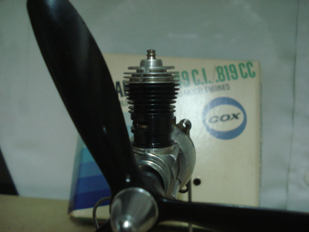

ohh !, so it is a cylinder number 8 !, the truth I could not find information, but I want to give some interesting details.
This engine arrived in a box of which I still have the photo of the package reception .... it is a Cox Babe Bee .049 .... now closer to discovering the year of manufacture.
I must emphasize that the compression of this engine is admirable, really a GREAT compression ... superior to some compared to those I have, an engine that is willing to fly !!
Thank you David!
Originally it did not have the anchors for the key and remove the cylinder, it was completely round, so I made the anchor for the key myself and thus keep the cylinder intact at the time of removing it to add the acceleration ring.

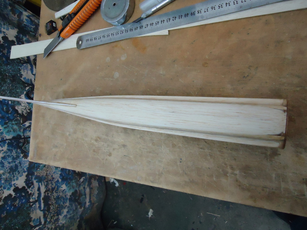

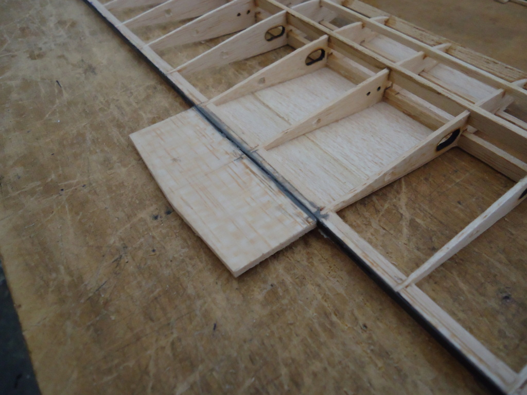

well, here is an important detail; a 3 mm x 1 mm carbon rod on the trailing edge, between the aileron and the wing, this gives a lot of rigidity in the wing, even more so when this model aircraft is designed to withstand some strong inertia.
To be able to place the aileron hinges, I have made cuts in the rod itself to be able to pass the fabric hinge.
Regarding the fuselage, I have placed some balsa rods, as I did in my Pitts model, in order to give an additional shape to the fuselage, I think it also looks nice and simulates the structure under the coating ...
